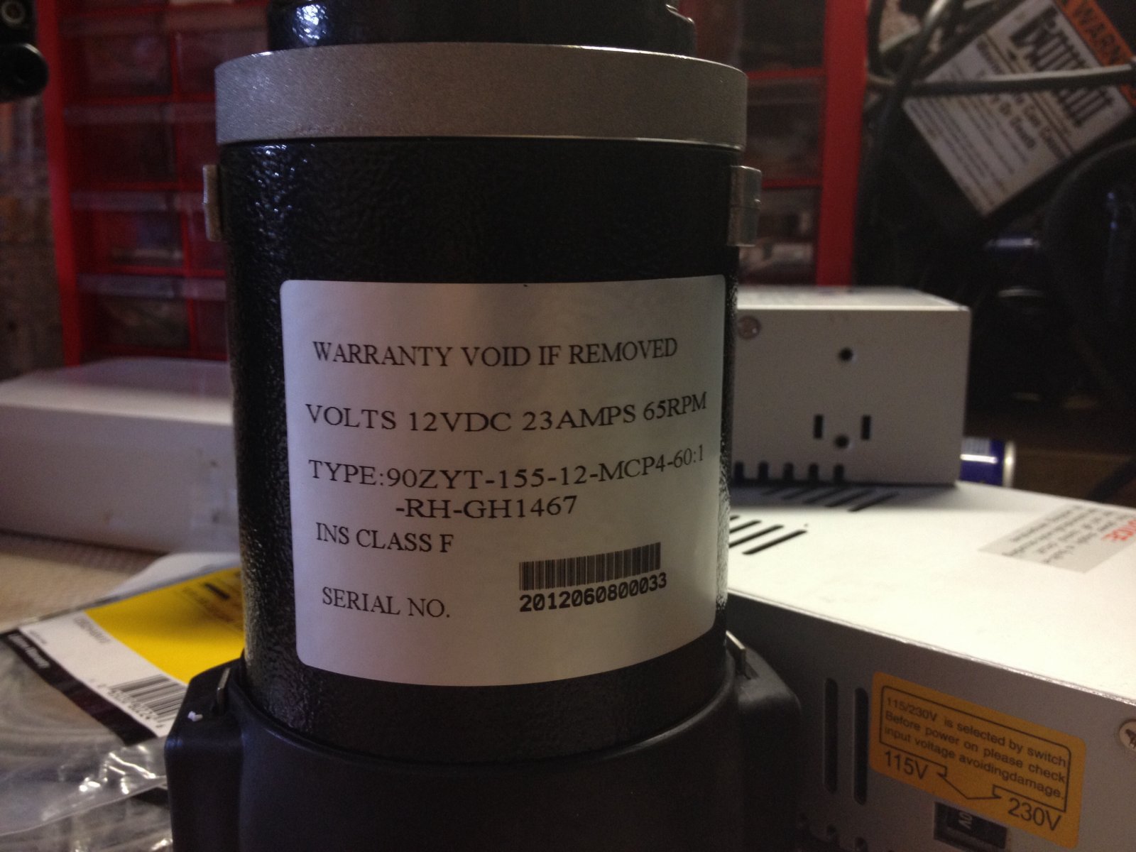

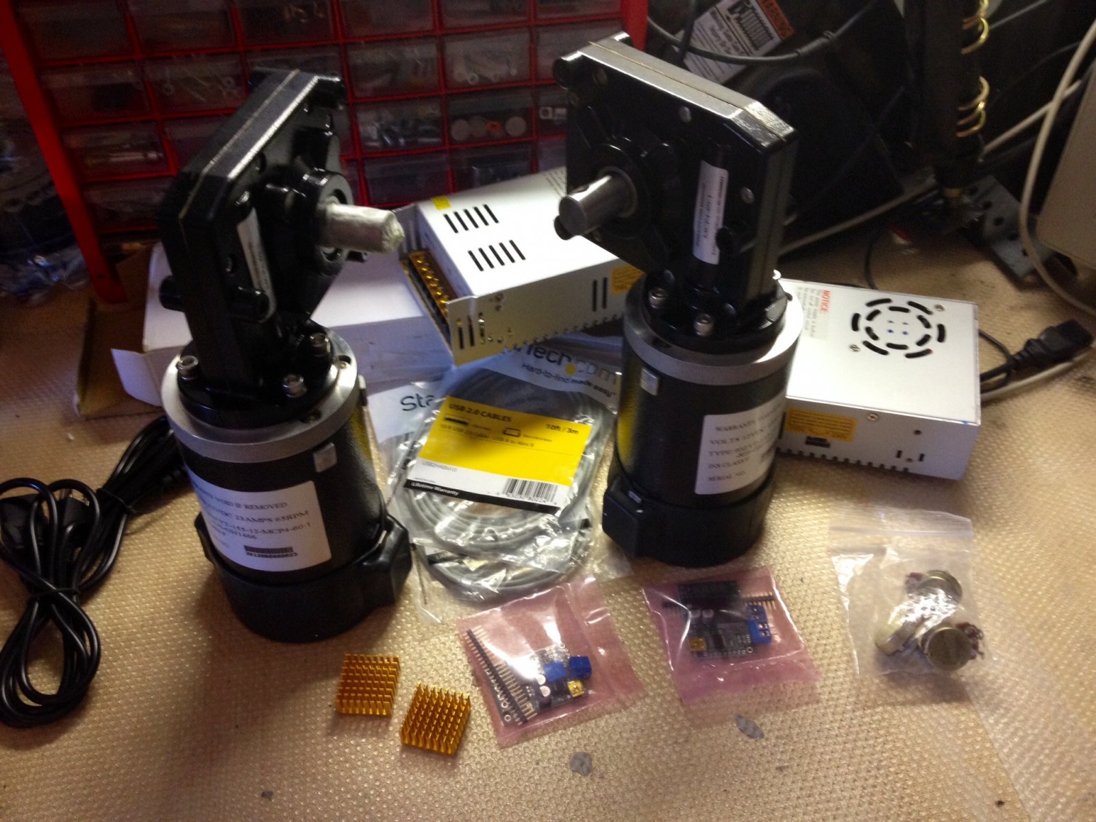

    Hi guys :)
    I have collected a bit of material, I hope to have taken everything that I need, now I have to solder the jrk and make cable connections to test the components, then proceed with the construction / modification of my simulator. Ps: the motors are labeled 60: 1 65 rpm but in the shipping document contains the technical specifications of 5000 rpm with gear 60: 1 should be about 83rpm .. or not? image.jpg image.jpg

    Looks good , if you have a decent car battery to quickly hook up the motors to test, I don't believe manufactures specs they produce, until I prove or disapprove by manually testing them. Like my motors state they do x Rpm once tested under 13.8v I get a constant 160 Rpm.
    Well that's all the electronics sorted out, time to build a sim. Cool

    I' ve test it with a power supply, without load seem make 85~ Rpm , at this speed 8-9 cm (centre-centre) of cranck can be enougth? What u think?
