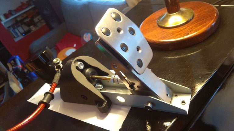

    Does anyone know how to code an Arduino pro micro to read inputs from a brake pressure sensor?
    *No code on github
    Usually, one can get the code from Github, upload it to Arduino, and play. I have found codes for load cells, but nothing on pressure sensors and their process for calibrating.
    * No wiring guides to Arduino Pro micro
    - again, load cell wiring guides are available, but not much for pressure sensors.
    To have the Arduino micro read inputs from the pressure sensor to act as an in-game brake.
    Idea reference 1: Lebois P1 brake pedal DIY pressure sensor
    Idea reference 2: modify G29 brake pedal
    Any ideas, links to sites/ guides, please?
    - TIA
    Picture reference
    1)Lebois P1 brake pedal DIY pressure sensor
    2)modify G29 brake pedal + presure sensor

    Connects like a simple pot, and uses whatever software axis, that commonly used here, on your choice. Trying to reinvent a bike?

    I made my own, the pressure sensor outputs 0-3.3 v
    So you use it as you would a pot

    I guess you map the voltage signal going into the Arduino and run the joystick code
