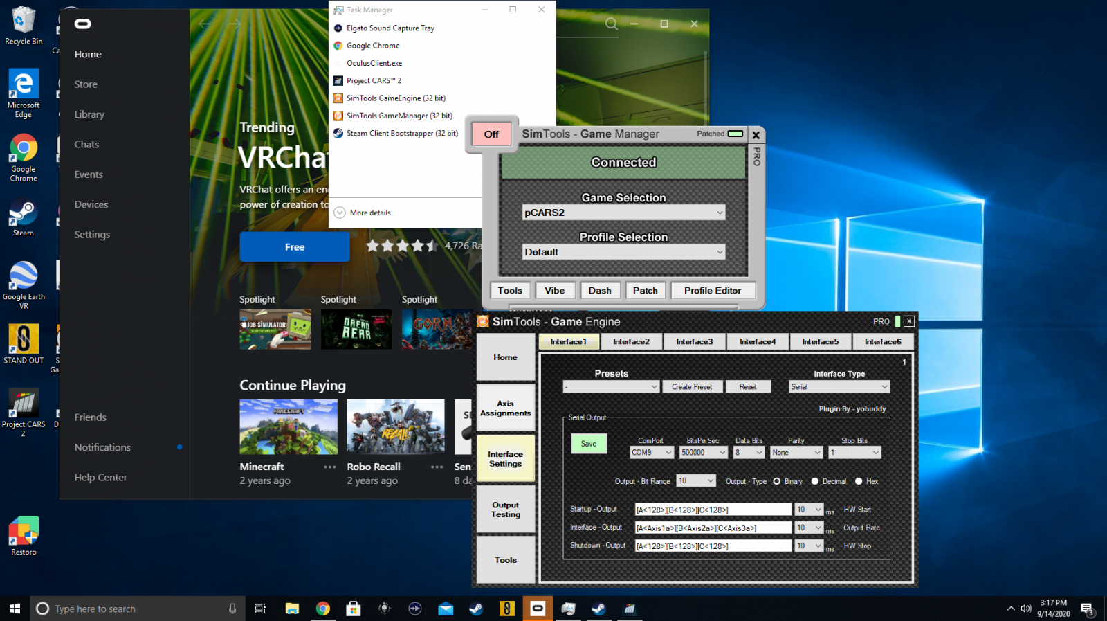

    Hi I was playing just the other day and today just fine. I went to play today and no response from my DOF H3.
    I had a com port error swithc ports and am shoeing port 9 in interface.
    Pretty literate when it comes to computers compared to most so your help is greatly a[appreciated.

    Sorry I just turned it off to the show the interface settings. I clicked it back on I can hear it wants to respond (slight whistle sound) but when I enter project cars 2 I dont get any movement at all.

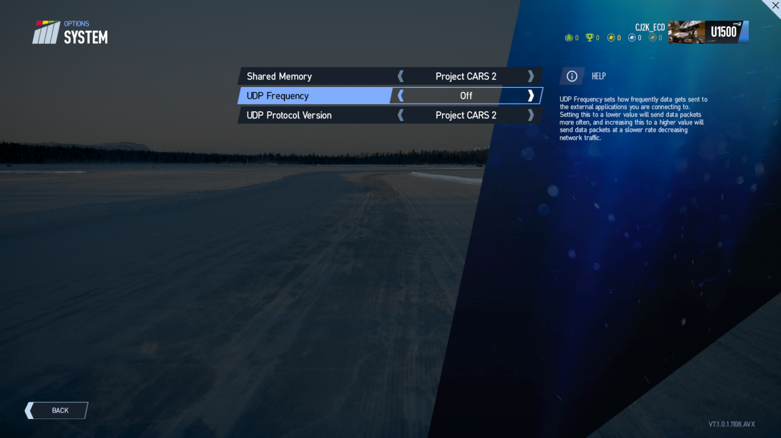

    Check the required in-game settings, then make sure your refine the motion profile, in particular capturing the Max and Min values in the Tuning Center: https://www.xsimulator.net/community/faq/steps-to-create-a-motion-profile.228/

    I have it set like this currently
    Ok rebooted after the shared memory step and I have movement! i will refine the motion also!
