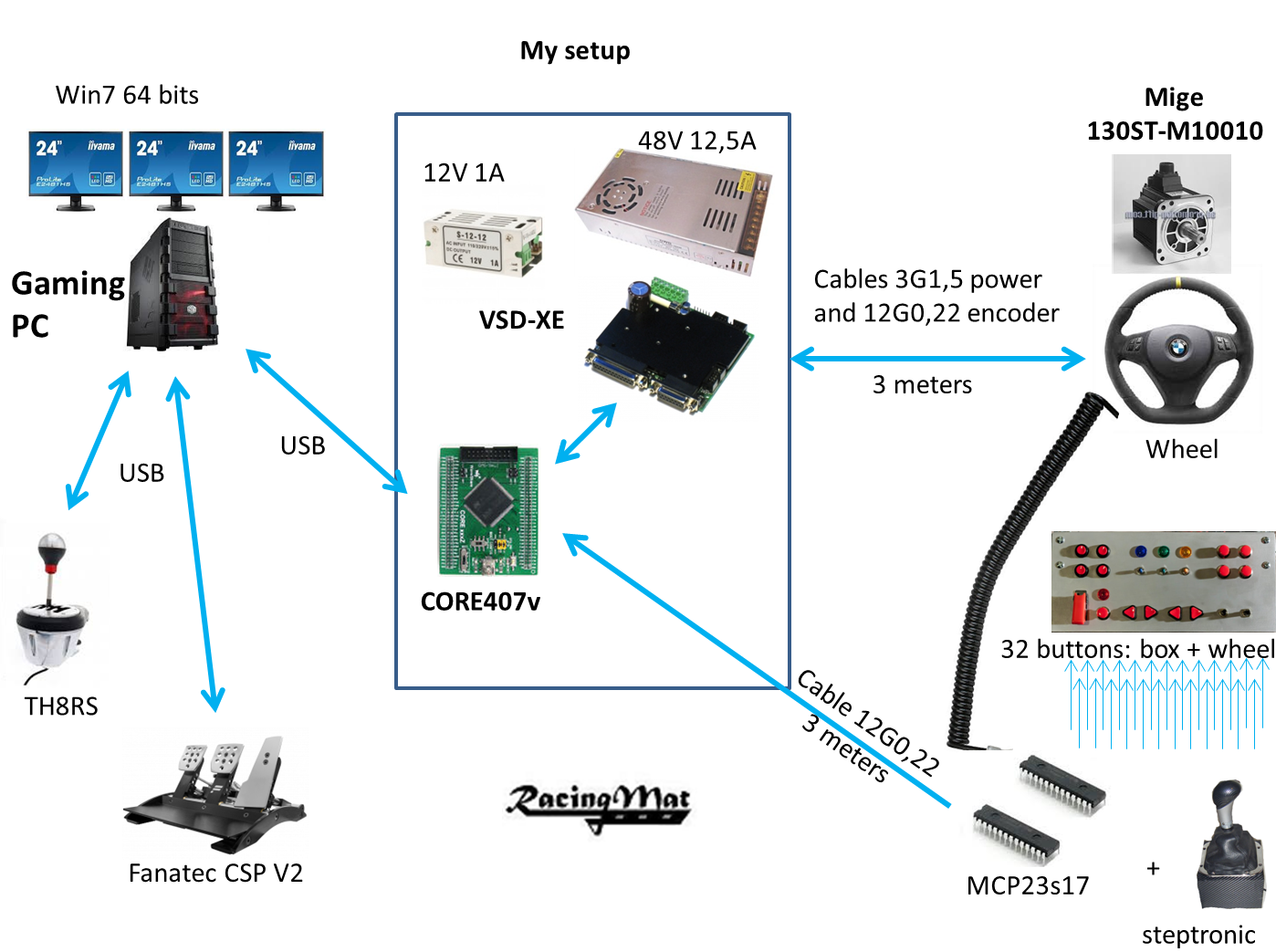

    It's an interesting topic, I have been trying to understand how FFB steering works for the last few weeks. It seems there is an increased interest in this topic of late, I assume as a result of the opensimwheel project.
    The opensimwheel while sounds great is also beyond what I am willing to invest in a DIY FFB wheel. I wonder if it is possible to use some of the concepts together with cheaper motors and controllers to get "acceptable" results that are better than the standard G27 though?
    From google translating details from the opensimwheel sites I think the "MMOs" software loaded on a STM32... board gives you a USB device that appears to windows as a standard FFB Wheel (even looks like you can easily add pedals and button boxes).
    What I can't work out is what the interface to the servo controller is... whether it is just a force and direction signal (PWM and DIR) or something more complicated?
    If it's just a force and direction then I would assume it is possible to put together a low cost version of the servo controller - how good the results would be I have no idea.
    @RacingMat, are you able to interpret any of the MMOs info to determine what the controller interface is?

    Great thanks Mat. I still don't fully understand what the VSD-XE is doing? If it is being used as a servo controller isn't it positioning the motor - in which case is the PWM a position signal, or is the PWM a Power signal like we have on our sims?
    Does the position feedback from the motor go to the VSD or the CORE407 controller?
    If the output of the Controller is PWM (power) and DIR can you use a MOTO Monster H-Bridge and DC Motor like we use for our sims?
    I'll keep using google translate with the sites you have provided and see what I can work out. ;)
  11. RacingMat
    2,237
    21,023Coins
    yes, VSD is the servo driver.
    the feedback position goes back to the STM32 via the VSD.
    please come on the forum and ask your questions (even in english): many people could answer to you more details!
