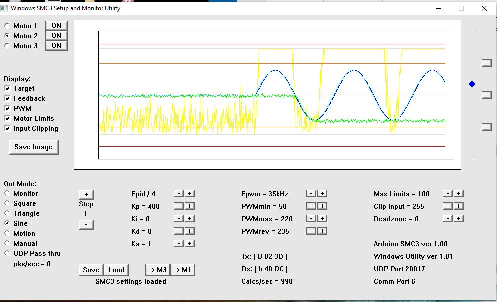

    I was playing Dirt Rally this evening when one of my motors went mostly slack. I noticed it was making a little bit of a high pitch noise when it was trying to move one way on it's axis. I notice that when I turn it on and try and muscle it in that direction it is sorta soft and I am able to move it unlike the other motor.
    It still come to position when I turn it on, and when I test its movement in simtools or smc3 I can move it in one direction but the other direction it makes that winey noise and moves very slowly to the position if it moves there at all.
    I took a screen shot of SMC3, this is when it's idle and I turn on Sine movement. Notice how the PWM is not doing what I would expect. Also my target green line drops down as if the pot was rotataed out of range. The pot for this motor is very secure and I don't think it would have moved.
    Do you think this motor is bad/or dying? Its a 50:1 crab pot pulling motor, I would expect it to have lots of power and life since I just bought it brand new a few months back.

    Also, I already tried increasing the PWMmin and increasing and decreasing the PWMmax but it didn't change the behaivor

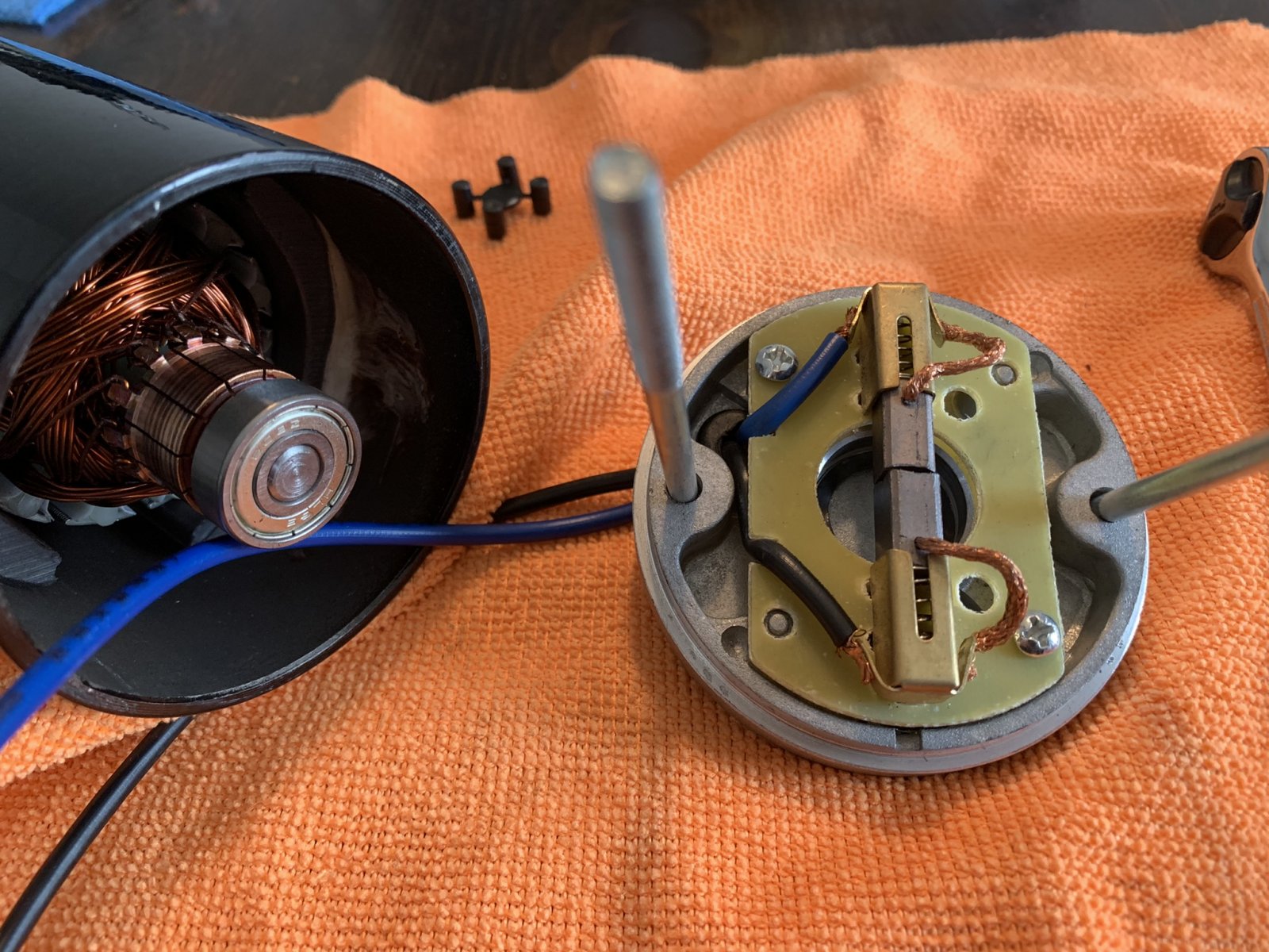

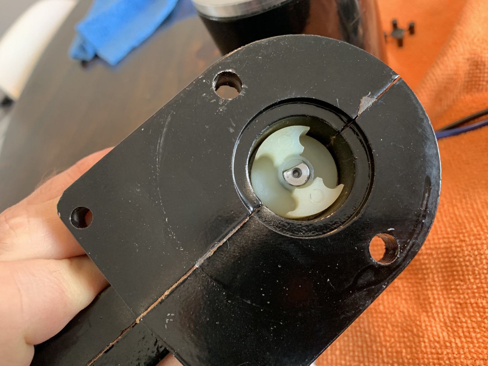

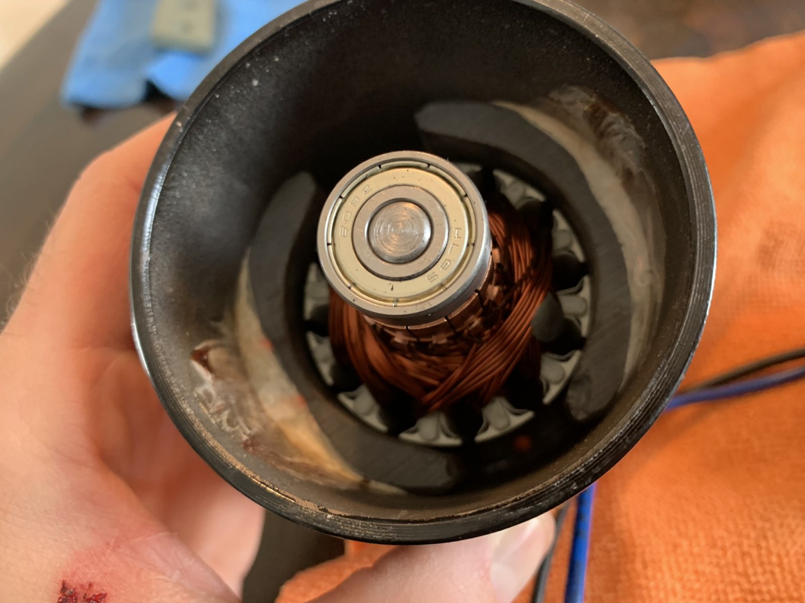

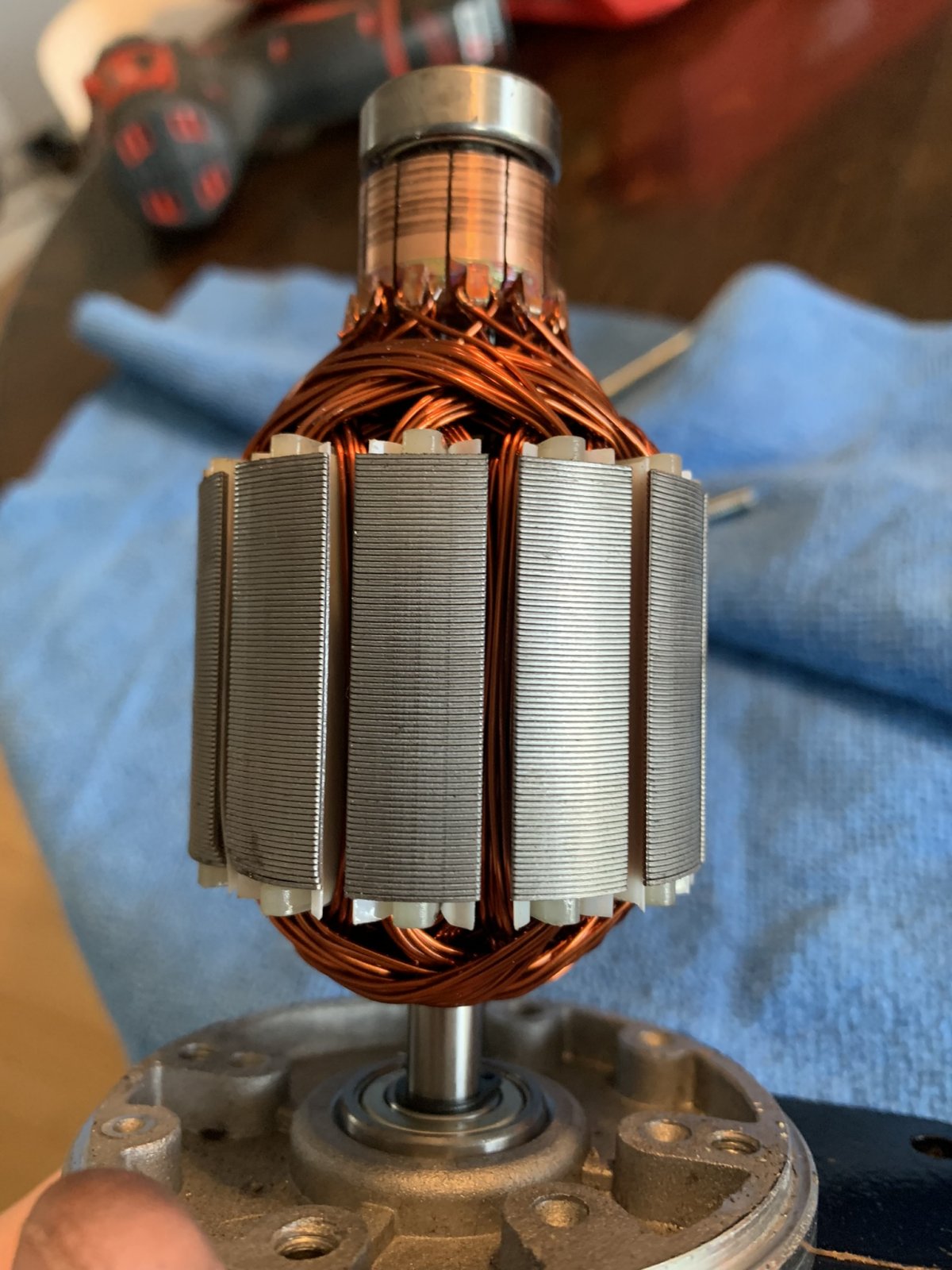

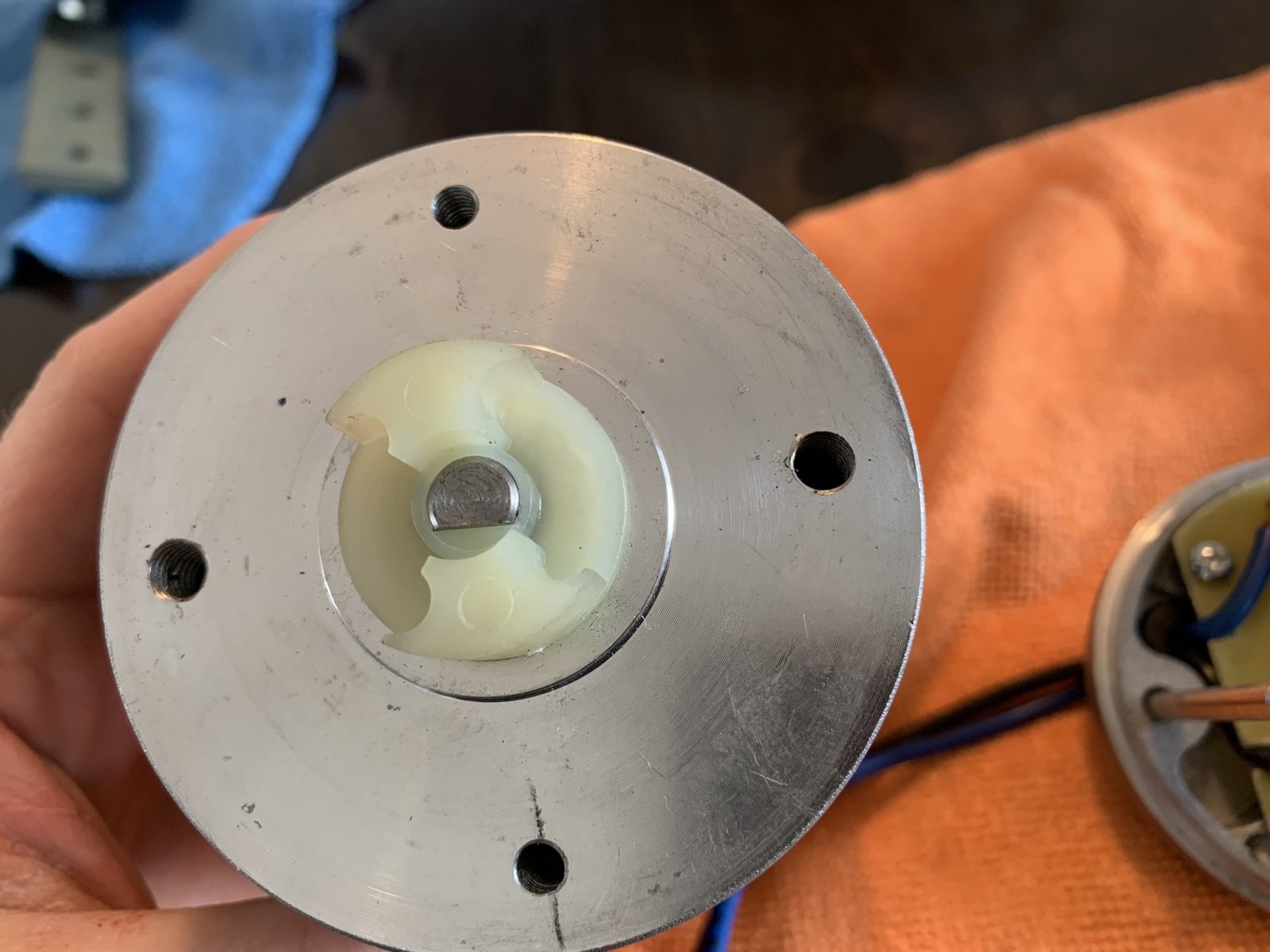

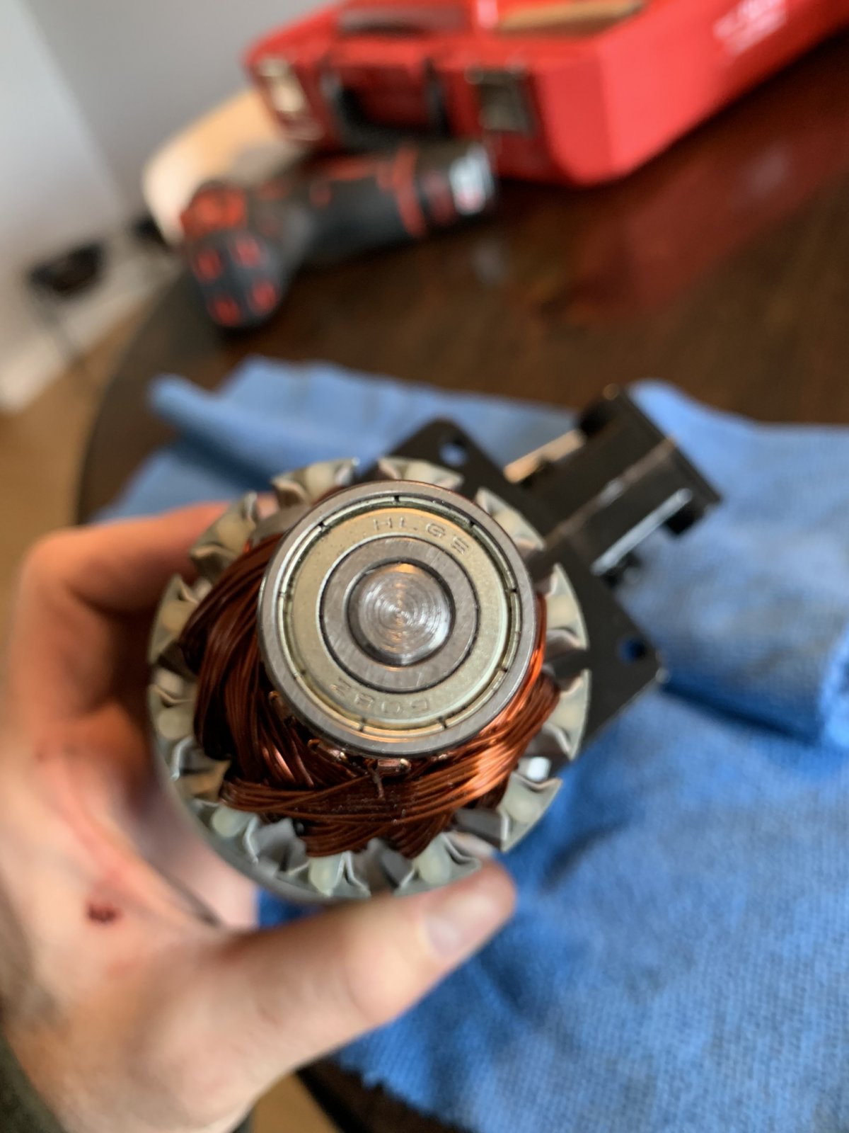

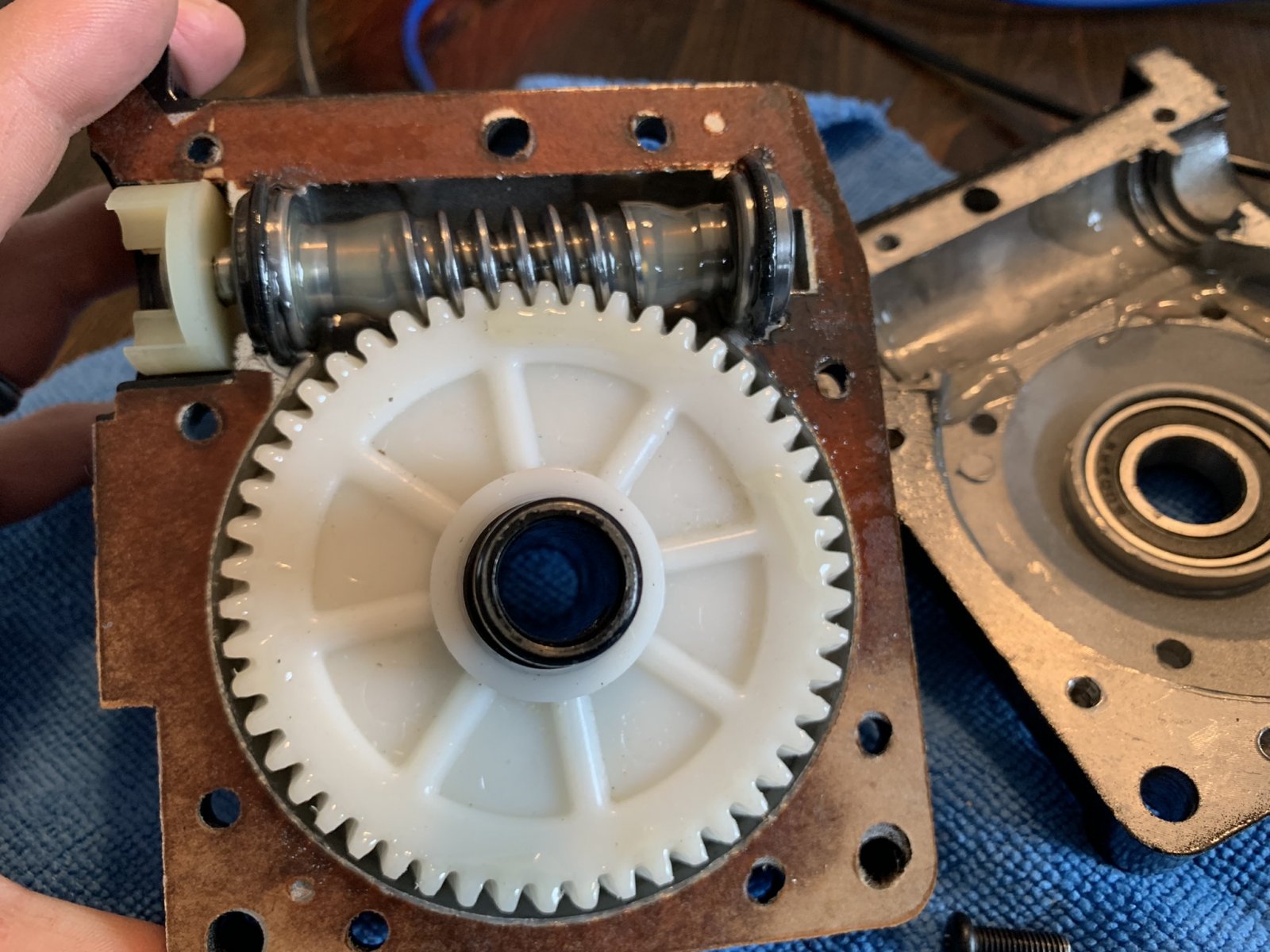

    I took apart the motor, I don’t know much about motors but it doesn’t look like anything is obviously wrong.
    3AB01BC7-9D4F-4B85-BAFF-50867A218D3D.jpeg 1F6BC4FD-A775-4C0F-AD33-005C9C2F064F.jpeg 6991B9D9-EE53-466D-98A8-34EAD6BF42D9.jpeg B06B3E6E-F713-4E8D-89D0-45D2EA470036.jpeg 550A6A16-727B-4277-A30D-DCBBAC5AB819.jpeg F4E214F6-6CE2-4BB8-912B-4268BD63DA37.jpeg
    20,550
    145,118Coins
    +10,778 / 52 / -2
    The motor does seem OK, you could lightly clean where the brushes run, but there are no obvious arc marks.
    Check voltage of the controller and motors under load.
