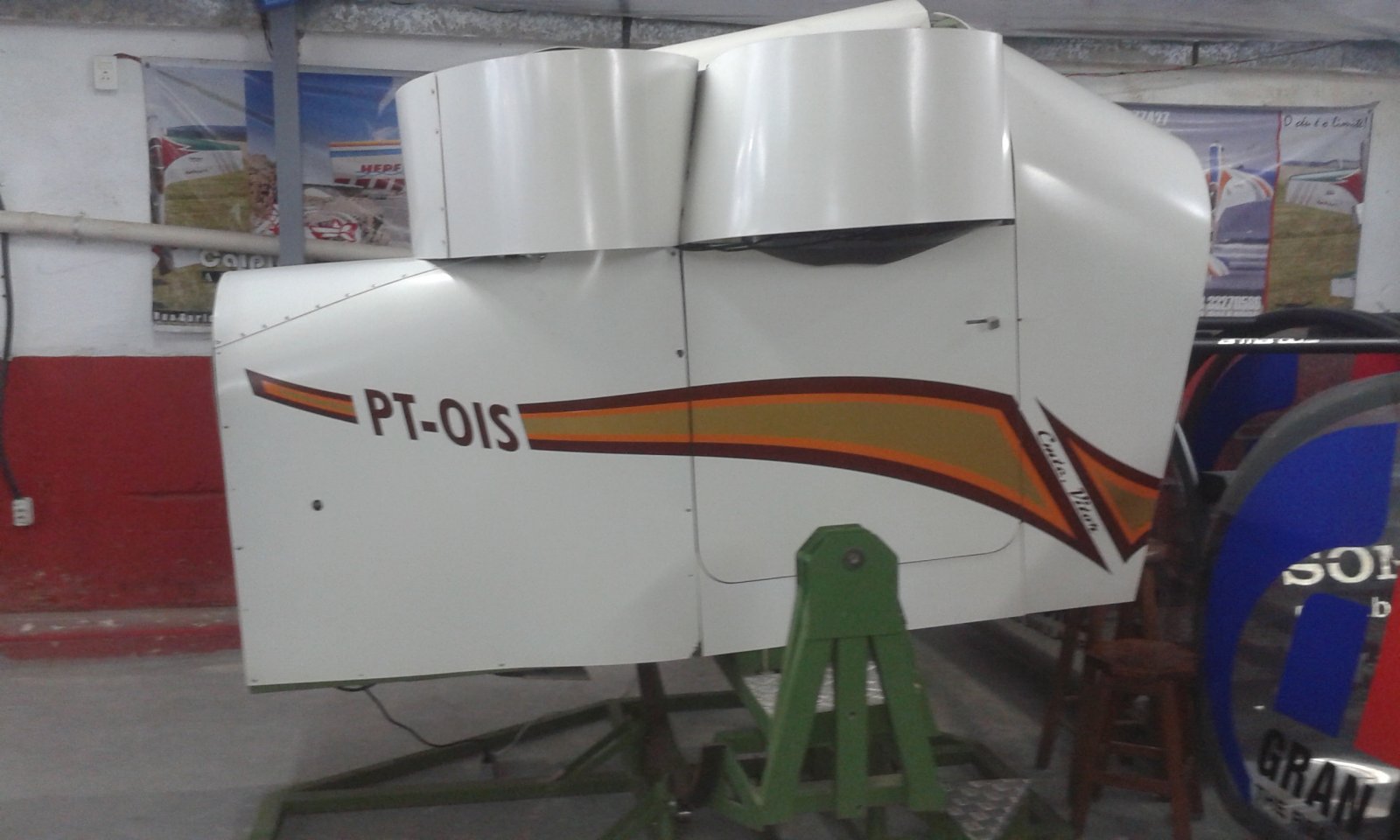

    Hi people,
    I bought a cabin for two people on board, but nothing has 2dof eletric parts. what I need to play with FSX?
    I have no manual and the person who built not finished the project
    thank you

    may be a wiper motor? i've two local to install it
  3. eaorobbie
    20,506Coins
    +1,687 / 23 / -2
    Im not confident a wiper will hold that much weight once in motion, but if you have one to play with then worth a try.
    The only other setup I have seen simular to this uses a chain driven by a big worm gear motor to control the roll and pitch.

    Thanks Eaorobbie for your reply. I've a Arduino mega and two wiper motors, this is all what I have.
  5. bsft
    Agreed with @eaorobbie , wipers will break . You will need big worm gear motors with chain drive or boat winch motors with chain drive.

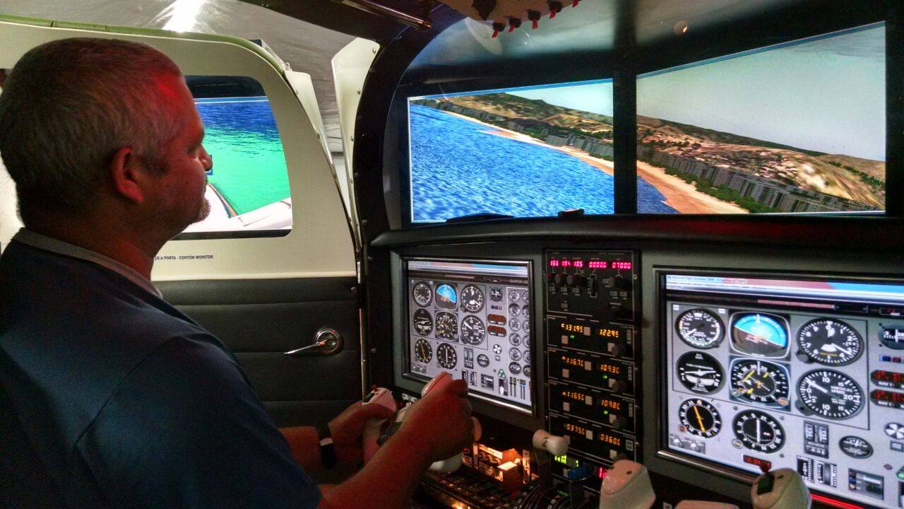

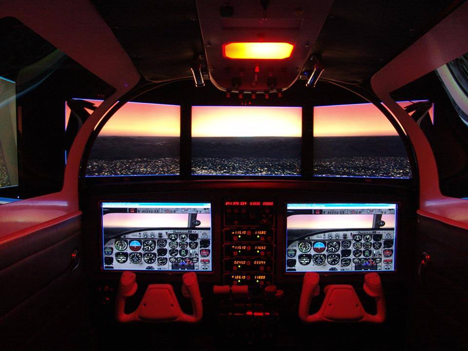

    Thanks for the reply BSFT, I checked that all the mechanics are lightweight because they are made with various bearings, as I already have these wiper motors, I would try, but do not know how to connect the Arduino nor in FSX

    inside cabin

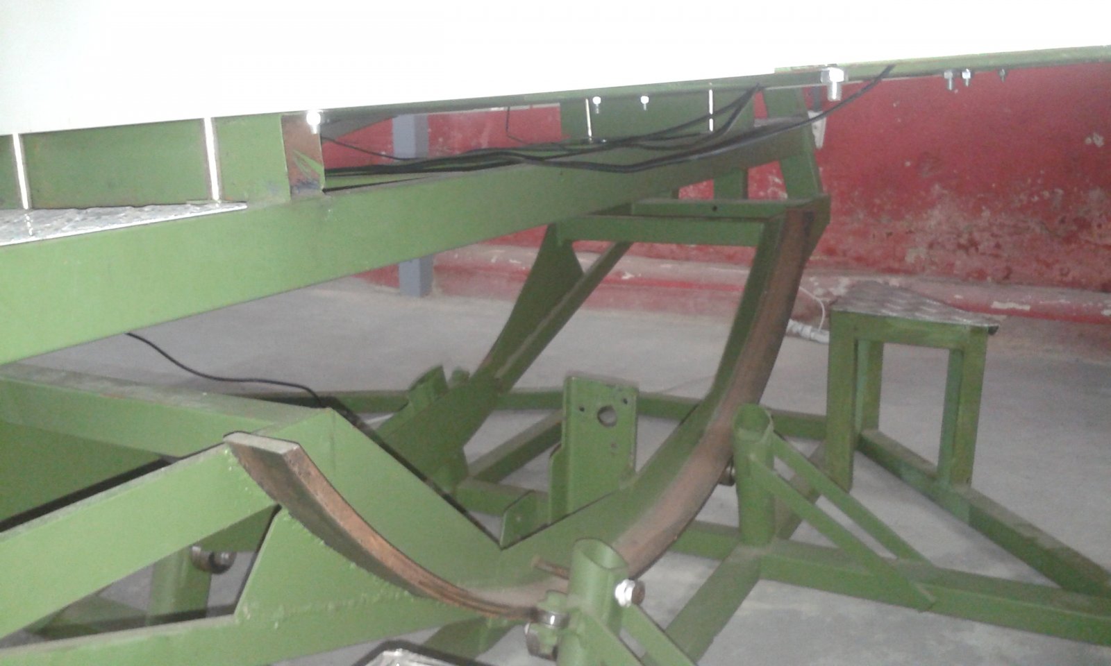

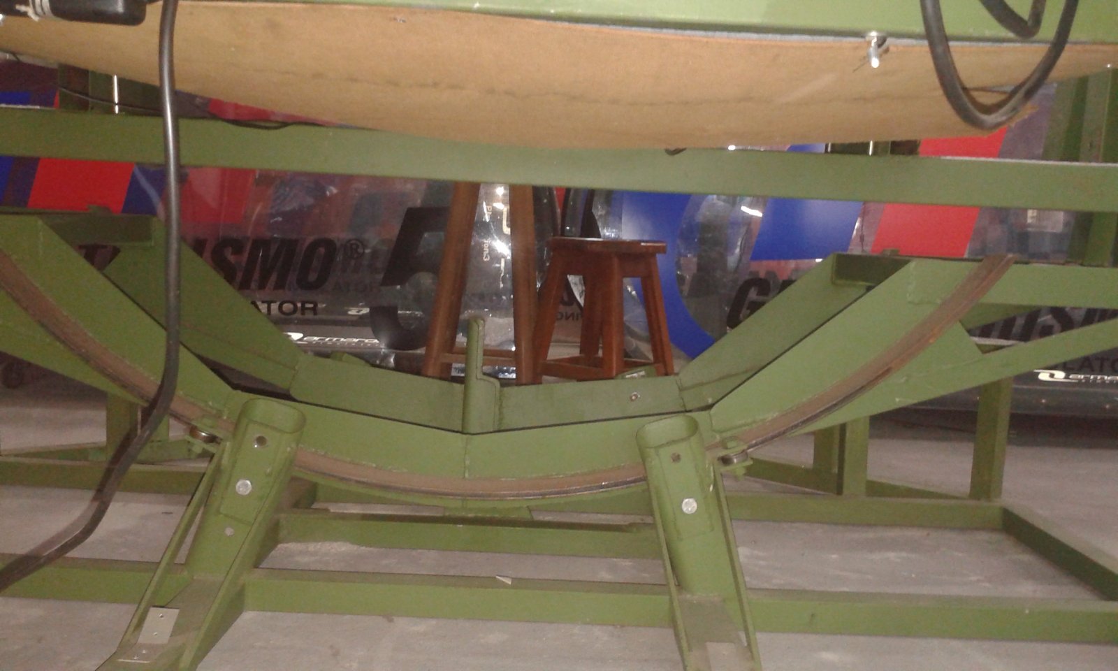

    cabin

    Nice rig, It looks to be built like a battle ship and with all those electronic from the photos and two people on board the inertia would be huge. Even if you geared down the wiper motors greatly with a chain drive, it may lag the game data so much that it may be unusable. Also nylon worm gears would not last very long. No harm trying, but I would be planning on using at least a 'Mega' motor, maybe two on each axis.
