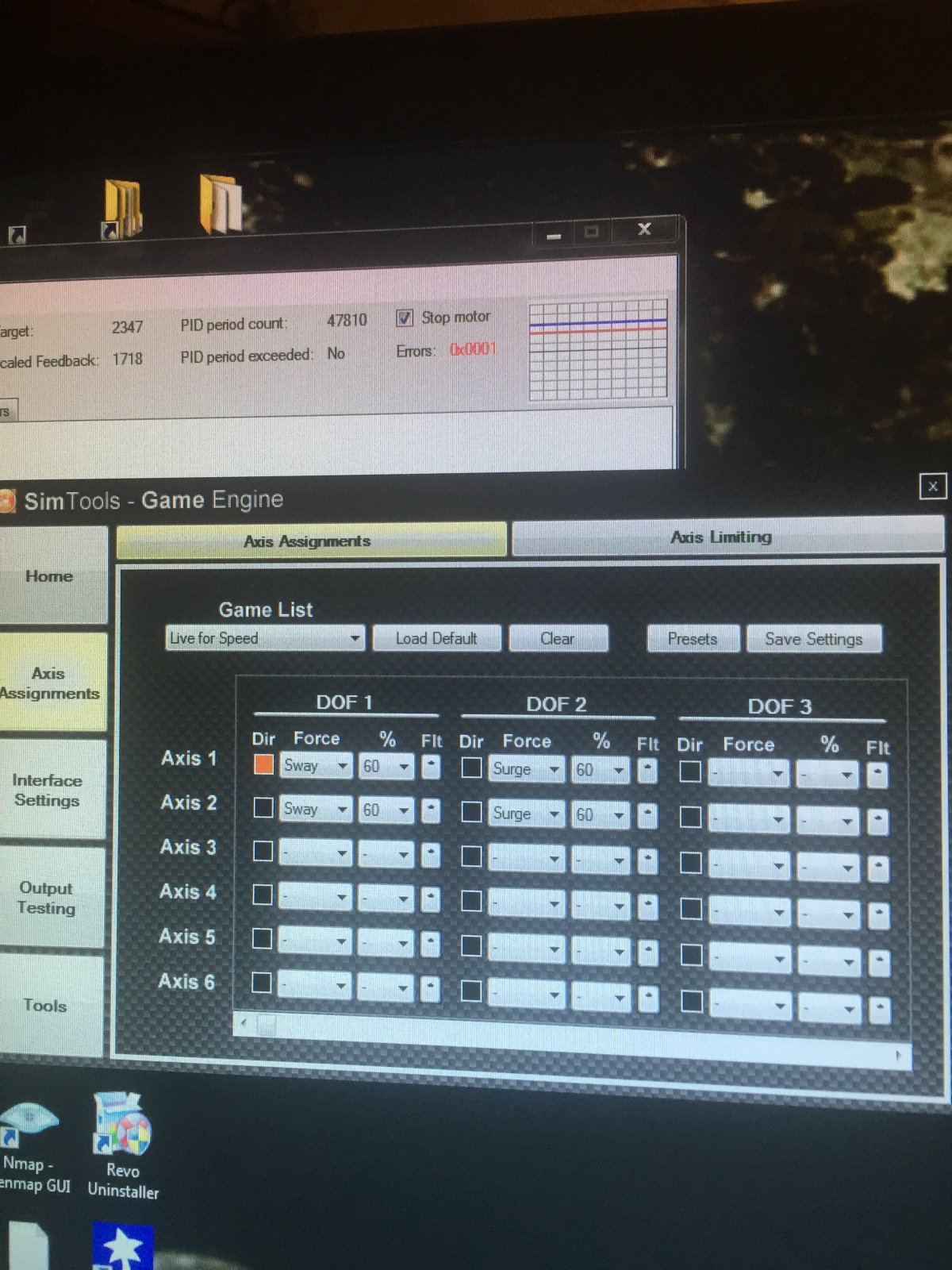

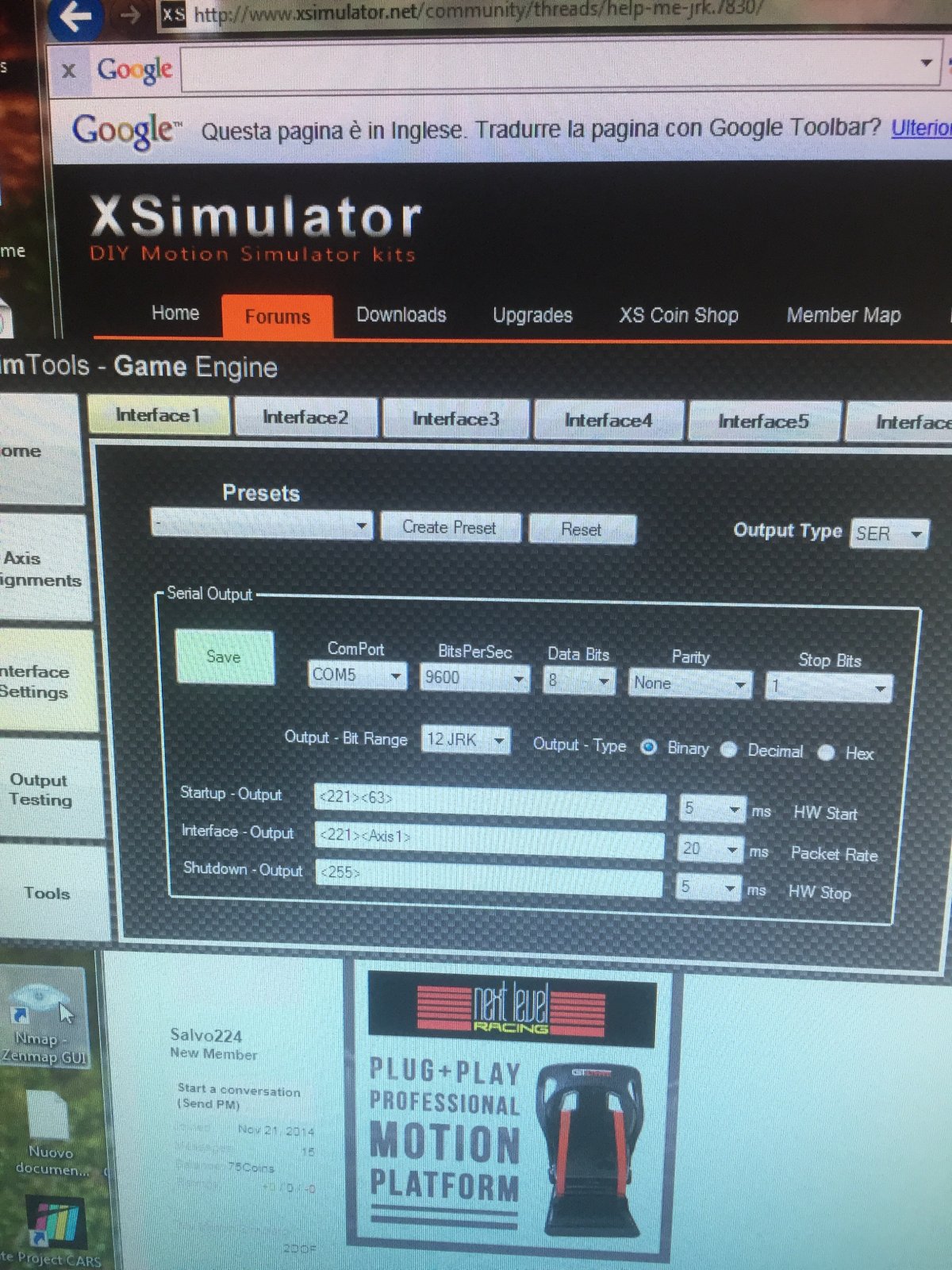

    Hello everyone I have a problema.ho a sim 2dof with jrk 12V12 Pololu I configured the software and started the game engine followed the lead and managed to move the sim output testing. patch the game the start and go on the pista.i engines do not move but the virtual axes si.qualcuno can help me?

    Can you please post screenshots of your SimTool Axis Assignment settings and tell us what game you are creating a motion profile for.

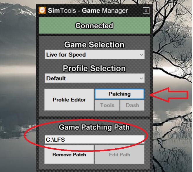

    Did you run Game Manager as admin when patching the game and what path did you patch the game to?
    Does the SimTools Game Manager turn blue when the game is run?

    il gioco è lfs e assetto corsa tardi se riesco a posto tutto il problema è che facendo cilindro di lavoro l'uscita di test simtool e pece quando iniziare il gioco non succede nulla

    Have you patched LFS for motion?

    Yes I understand the virtual testing works, but I need to clarify if you have patched LFS for motion in its install path, which would be something like this:

    I've done this step but I have to do when I install simtool or after configured?

    It is fine to patch LFS once you have set the Axis Assignments, it really does not matter.
    Can you please post pictures of all your settings.
    You should start with surge and sway in the Axis Assignments.
    Does Game Manager turn blue when you run LFS?

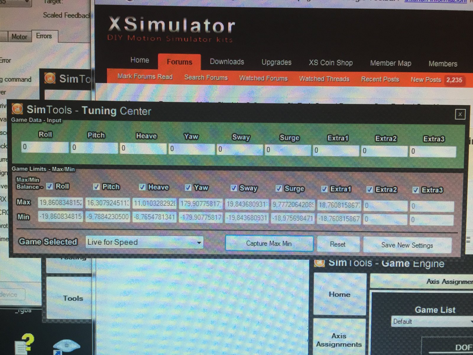

    Pictures of all your settings, including the Tuning Center?

    I have not configured the tuning center where is it?
  13. noorbeast
    20,535
    145,034Coins
    +10,776 / 52 / -2
    In your system tray right click on the SimTools Game Engine icon and open the Tuning Center from the menu.

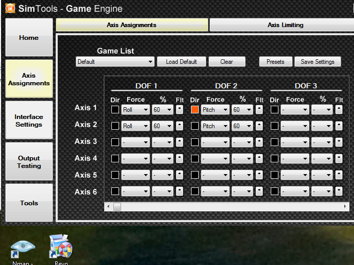

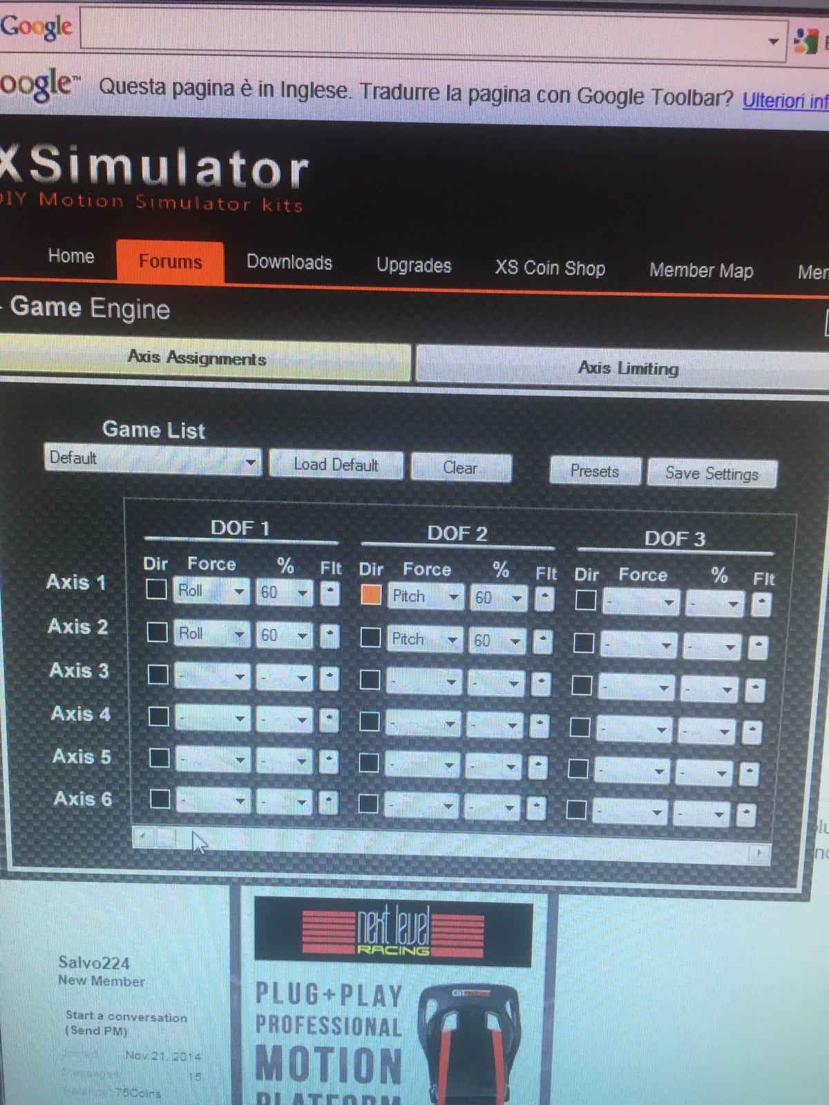

    @Salvo224 in game list should be the name of the game your playing not default!!
