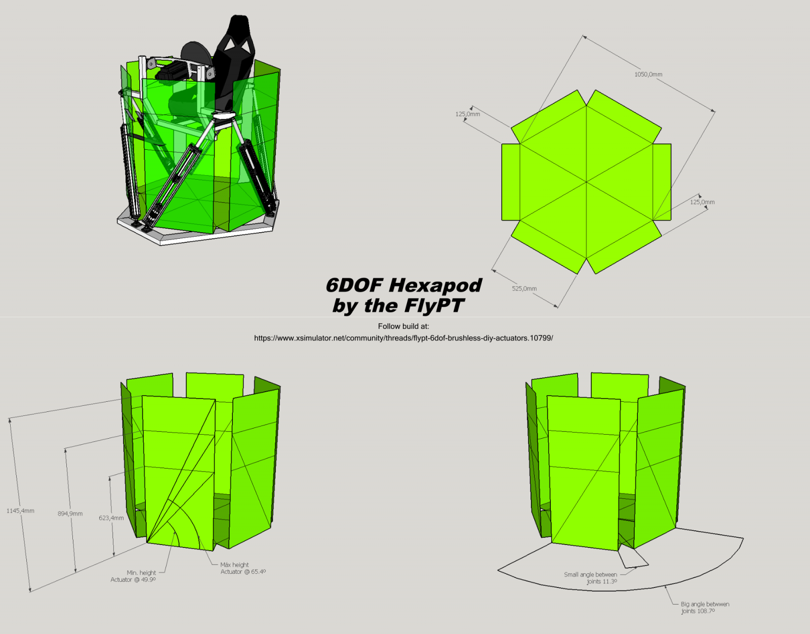

    My thoughts on this when I made the rig:
    Smallest possible because of the wife (even so, my rig is now on the garage...)
    Being an hexapod, the principle is triangles.
    To have the perfect hexapod, top and bottom would be the same and joints should match defining those triangles.
    In practise this is not possible in most of the cases (type of actuator). That would be the ideal, giving you the best range distribution in all DOF's.
    So what I made is design the top and base hexagon.
    Then I pulled out the actuators until I had enough space for them to move (not collision between them).
    You can see it in the image bellow:
    One of the limits I used is to have the side of the hexagon small enough to avoid the actuators being horizontal. On normal work, they don't reach those positions. Another particularity of this setup is that if you rotate the rig to the maximum (from the center position), one of the actuators is in the lowest position, while the next one is vertical.
    Of course those angles increase if you add more DOF's on the movement.
    Now this brings a problem and that's stability of the platform.
    Easy to solve by attaching it to the floor (my case). Or just increase the base structure to give more support.
    Those measures I show in the image, where made for a compact solution. It's the minimum for me and the chair I use. In the lowest position, the height is similar to jeep/suv, so easy to access the seat.
    Today I would increase the base hexagon to make access easier (space between seat a structure for legs to pass). Actuators could be enlarge also to compensate the hexagon side increase.
    Another note: That sunken design is made in such way, the structure doesn't touch the actuators. This is best for access to the rig, but also to make the center of rotation (center of the top platform) closer to your neck.
    Don't follow my measures without experimenting! You might need more space.
    My legs are almost horizontal. I tried to mimic my sports car measures. And that's a really small car.

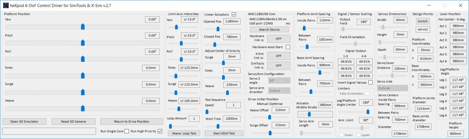

    If I could do it again, I'd make the top platform a little larger by say 10% at the expense of less roll and pitch for which I already have plenty.
    Seat base is sunken 450mm which keeps the platform CoG nice and low so I don't need to bolt it to the ground
    Get the @hexpod plugin and it makes it easy to adjust the dimensions and test the design.
    Or wait for FlyPT Mover.....
    FlyPT Mover is currently not working as it's being rewritten I think. @pmvcda?? Looking forward to the next version which hopefully we can move forward with long term!
    Attached is a screen cap for you too.

    hmmm.. i didnt think of that to plug in values virtual with the FlyPT mover!
    wow.. i got homework to do. soo much.
    thank you for all the great info @Psionic001 @pmvcda

    @pmvcda may i ask, how or why did you pick your values 125mm, 525mm and 1050mm in your hexapod dimensions?
  10. pmvcda
    pmvcda aka FlyPT
    Nov 3, 2010
    2,180
    Portugal
    15,391Coins
    +2,601 / 17 / -0
    It's the smallest possible dimension for my chair an to fit me inside in the position I wanted.

    @pmvcda
    so ideal is to base dimensions on chair... interesting.. i thought ppl fit chair around actuators/base, instead of fitting actuator/base around chair....
    so first thing to design is the sunken chair frame structure?
    wow.. totally different perspective of design and thinking!
