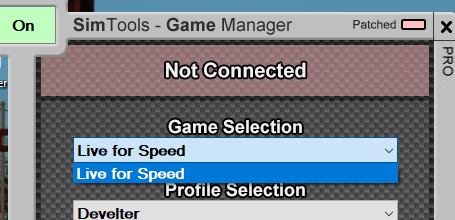

    Good morning, everyone,
    Today, I turn to you because I have a problem with the installation of cylinders.
    I added my "Game" (Thanks to SimToolsPluginUpdater) by dragging and dropping it.
    No errors during installation, and success message at the end.
    In addition, it appears in the files.
    Now, when I try to patch with SimToolsGameManager,
    It does not appear in the list of games (See Screen).
    Can you help me? Thank you in advance and have a good day!

    Are you using the Demo version of SimTools? If so the Demo version will only allow the fully functional Live For Speed plugin, which is provided specifically for testing purposes.
    A licensed version of SimTools is required to run other game plugins.
    Eligible members can request a free DIY SimTools 2.0 license, conditions apply: https://www.xsimulator.net/request-diy-key-simtools/
    To qualify for a free license:
    • You must be building a true DIY motion simulator. (Not built from a kit or purchased from a simulator seller, a model simulator does not qualify.)
    • Have a unique build thread or Showcase in DIY Simulator Projects. (The thread should show some effort, which means it should show progress to the testing phase.)
    • Have been a member of the community for at least 30 days.

    Hello !
    Yes, i have been buy the SimTools License.

    What is the plugin you are trying to install?

    It's one of my own plugin !

    Perhaps @yobuddy can take a look at it for you, when he has some free time.

    My guess is there is a problem with your plugin?
    Hard to say without a bit more info or your plugin posted.
    Be happy to look more into it if you want to post your plugin.
