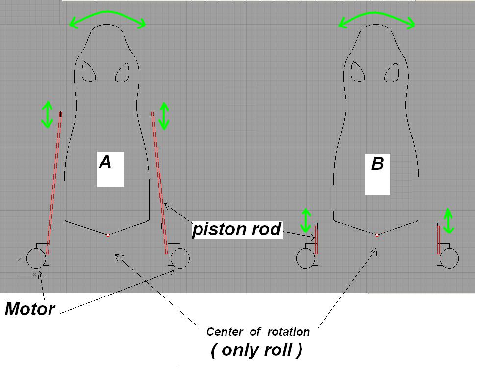

    Salve,guardando il disegno vorrei sapere quale figura la A o la B e' piu vantaggiosa per i motori ?
    Grazie.
    Hi, I am looking at the design I want to know which figure the A or B 'more advantageous for the engines ?
    Thanks.

    I agree with noorbeast. Have a look at the links he has posted. There is some good information available.
    Personally, I am using a shoulder mount design like in picture A with the rods being at 20degrees back and about 13 degrees to the side. The are connected to a 40mm CTC lever at the motors.
    This design works well for me but I guess every setup is different and everybody has slightly different preferences.

    perfect solution 'll use A, thanks for the advice very kind as always
