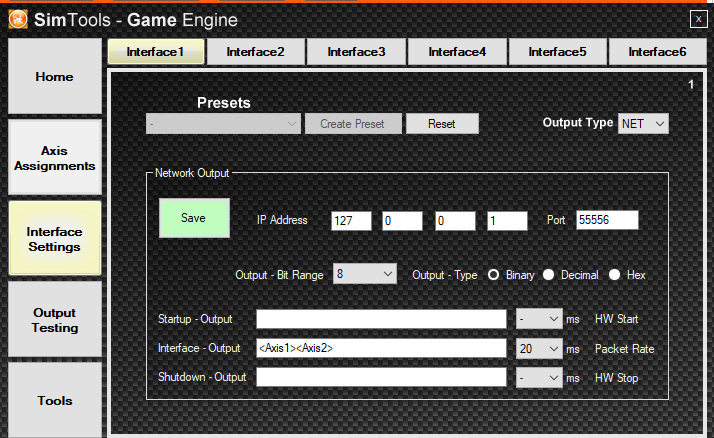

    If you want to explore SimTools as an alternative check out the Network section on p.36 of the manual: https://simtools.us/wp-content/uploads/2024/02/SimTools-v3.pdf
    And you could try this setup from @Dello with SimTools, but please note that for SimTools 2 and SimTools 3 the Interface Output is like this: <Axis1a><Axis2a>
