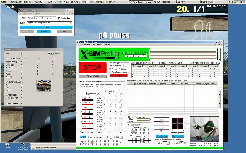

    Hi
    I'm running the whole thing on Intel Core2QUAD@2400, 4Mgs RAM, 8800GTS, Logitech G25
    AVR micro ATMega 8535@com1 pinout on my mainboard, 2x wiper motors.
    This is what i've done so far:
    Downloaded new firmware to the controller
    altered xfg.txt in LFS
    opened sender+profiler
    selected LT-G25 and LFS profile in sender
    send data
    started profiler
    Started a race, pause, ALT+TAB out
    What do I do now? How do I make the motors react to force feedback signals or joystick signals?
    The motors center allright. When I try to move them with my hands they resist and center.
    I'm totally new to this so...
    Henrik

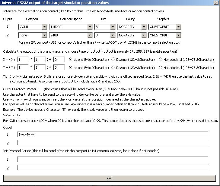

    ALSO you have to set the USO settings in Profiler:
    Regards, Thanos

  7. tronicgr
    tronicgr
    To set the USO settings, click on the menu -> Interface -> Universal serial output
    :thbup:
    Then you have to load the profile I give here:
    best xyz lfs config.rnr
    Regards, Thanos

  9. tronicgr
    tronicgr
    hey,
    In the output string enter AB~255~~y~~x~
    The B~x~P~y~ you are using are for the obsolete now BS2 interface!!!!
    Regards, Thanos

  11. egoexpress
    egoexpress Active Member
    Dec 13, 2006
    3,839
    Germany - Frankfurt/M
    421Coins
    +7 / 1 / -0
    Try the following at first: Besides the virtual coordinate system in the Profiler, there are sliders for X and Y. Press the start simulator button and move those sliders. Are you getting full range movements (180°) with your motors?

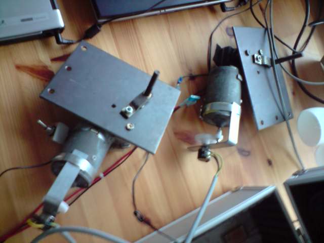

  12. HAVOG
    HAVOG New Member
    Jan 2, 2009
    34
    High and Low voltage technician, production automa
    Denmark
    299Coins
    Hi
    No.. I'm only getting patial movement on 1 of the motors. When going negativ on Y axis it moves right and when i go positive on the x axis it goes left...

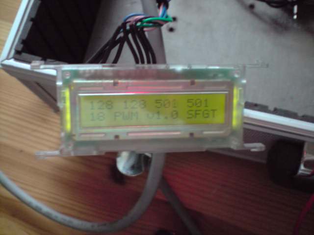

  13. tronicgr
    tronicgr
    Hi, Henrik
    On the AMC board set the DIP switch #3 to position OFF, to use it as joyrider motion, which each axis moves independent from the other. In such way you can test how each motor is moving and calibrate their range of motion easier. Then you can switch back to SFGT mixing any time you are ready!
    Thanos
  14. HAVOG
    HAVOG New Member
    Jan 2, 2009
    34
    Denmark
    299Coins
    Hi
    Yes i read it in the manual and swtiched DIP3 off.. But now i have no contact with the controller what so ever. I tried swithing back but no luck. I haven't made any changes to the software and i restarted the pc but still nothing...
    Strange..

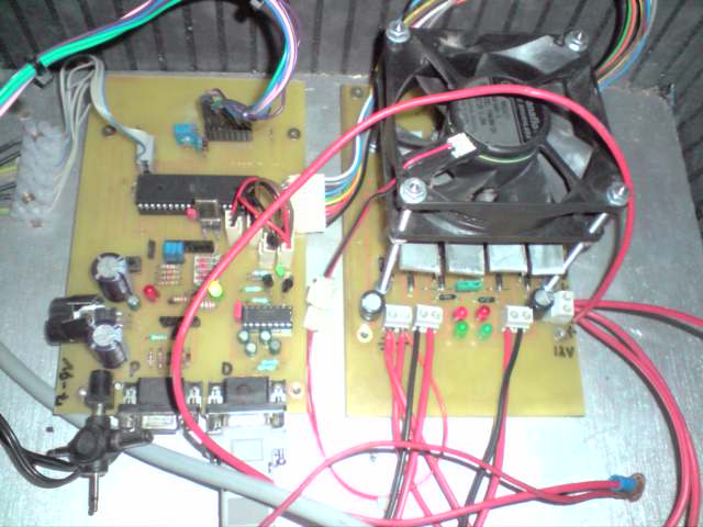

  15. egoexpress
    Dec 13, 2006
    3,839
    421Coins
    +7 / 1 / -0
    I think there may be a problem with your hardware. Either the AMC, or the h-bridge.
    Close the X-Sim software, and try to sort out the problem with your hardware.
    A vid could help to make further suggestions...
  16. wannabeaflyer
    wannabeaflyer Active Member
    Jul 31, 2008
    248
    UK - London area
    970Coins
    +34 / 0 / -0
    Hi Henrik i had similar pronlems while i was learning how to get my AMC interface running and have to say the problems all boiled down to build issues.. silly things like very small solder bridges , missing links , bad crimp connections or just intermittant connections , losst a lot of deveolpment time because of these build mistake ( easily done ) the lesson i learnt was that fault finding was down to check check and re-check because everyone knows this is a proven working inrterface.. dont give up just go over every inch of the circuit boards .. things like are you using the correct serial cable \9 not \null \modem type ) are are the three PCB jumpers removed when programming , can you read any data on the chip using Ponyprog , can you see any info when using hyperterminal .. i used the pony prog to confirm read / write to my controller so knew that programming part of the circuit was fine , i then tried Hyper terminal to check out the send / Recieve circuit side of the interface , my problem came down to my DIY lcd interface pcb ( solder bridge across RS line.. just a few bits to look at. i also used the current limiter on my Power supply to see if i was drawing excessive current when i powered up my AMC and H Bridges and that immeadiatly told me if i had a short circuit somewher and saved me a lot of grief..
  17. HAVOG
    HAVOG New Member
    Jan 2, 2009
    34
    Denmark
    299Coins
    Hi
    I got it working again. Downloaded new firmware to the controller and it was up and running againg.
    I put the controller in Joyride mode (was in SFGT before) and now I got 1 motor working 200 degrees (100 right/left).
    BUT the other motor will only go one way. It turns 200 degrees to the right but it won't turn to the left - or 0 position. I have to wind it back with my hand.

  18. egoexpress
    Dec 13, 2006
    3,839
    421Coins
    +7 / 1 / -0
    I assume there is at least one Mosfet damaged due to any bad soldering, or shortcut (happend to me while screwing the a cable to a terminal connector with a naked screwdriver, touching the screw and the aluminium cooler stripe at the same time...:lol: )
    Like wannabeaflier suggested before. Recheck your pcb and search for bad soldering. If you are not able to find anything, then replace the mosfets of the circuit that belongs to the motor that does not work. Or simply switch them, to see if the motor just turns into the other direction then...
    regards
  19. HAVOG
    HAVOG New Member
    Jan 2, 2009
    34
    Denmark
    299Coins
    Finally made a video of the problem with Tronic AMC...
    Hi :sos: :sos: :sos: :sos: :sos:
    I'm running the whole thing on Intel Core2QUAD@2400, 4Mgs RAM, 8800GTS, Logitech G25,
    Tronic controller - AVR micro ATMega 8535@com1 pinout on my mainboard, 2x wiper motors.
    The problem is, motor2 can only turn in one direction . Motor1 turns both ways, but only when motor 2 is at setpoint :thbd: .
    Video is here:
    http://www.bilgalleri.dk/html/vid_vis.asp?VideoID=23135
    :sos:
    Henrik
  20. egoexpress
    Dec 13, 2006
    3,839
    421Coins
    +7 / 1 / -0
    Try to flip plus and minus on the pot connector of the motor that does not move correctly.
