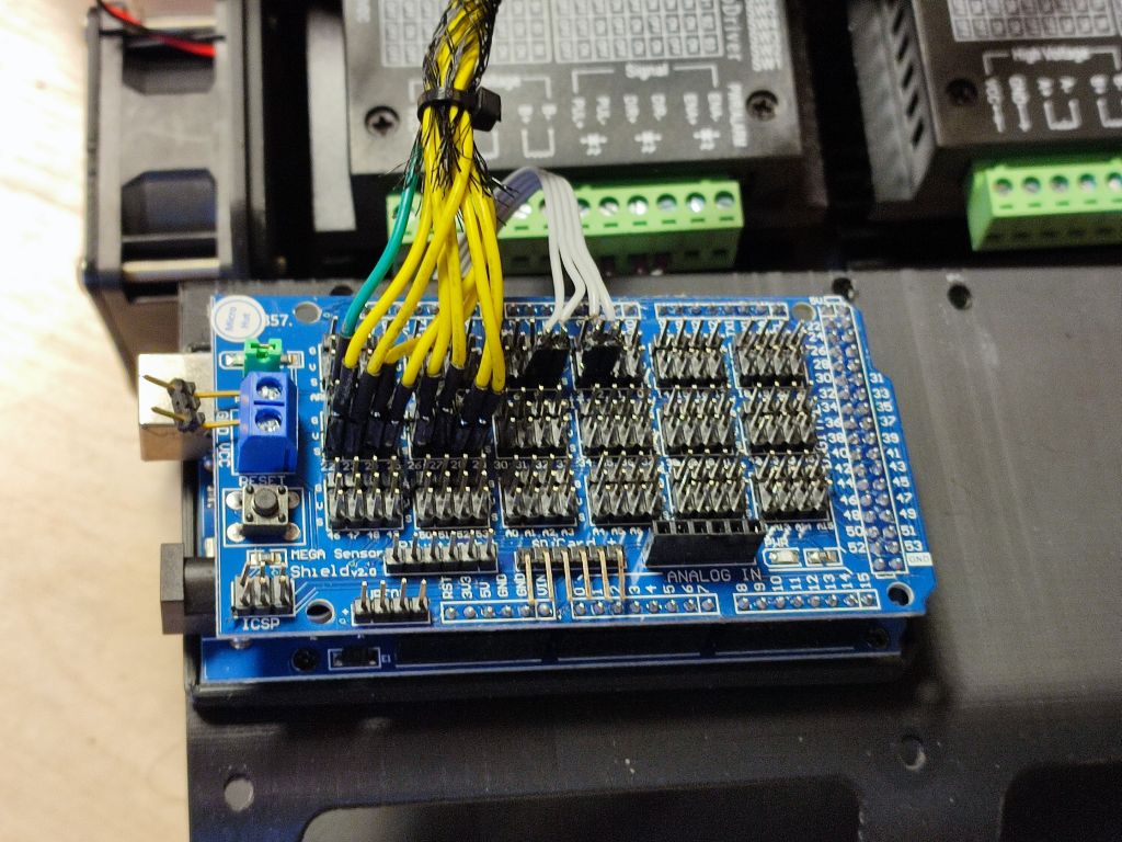

    Ok, my first advice: Don't do it like this
    Connecting single wires with Dupont connectors is good for a quick testbench hook-up. But as soon as you plug in more than ~10 it soon gets messy and it's definitely not lasting long in a rig that is moving all the time. The bare Arduino board with the female headers and the male Dupont wires is even worse. They pop out if the wire is only slightly touched.

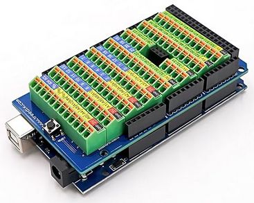

    So I ordered one of theese. It's occupied with push-lock (screw-less) terminal blocks so hopefully I'll be able to connect all the wires in a more reliable way.

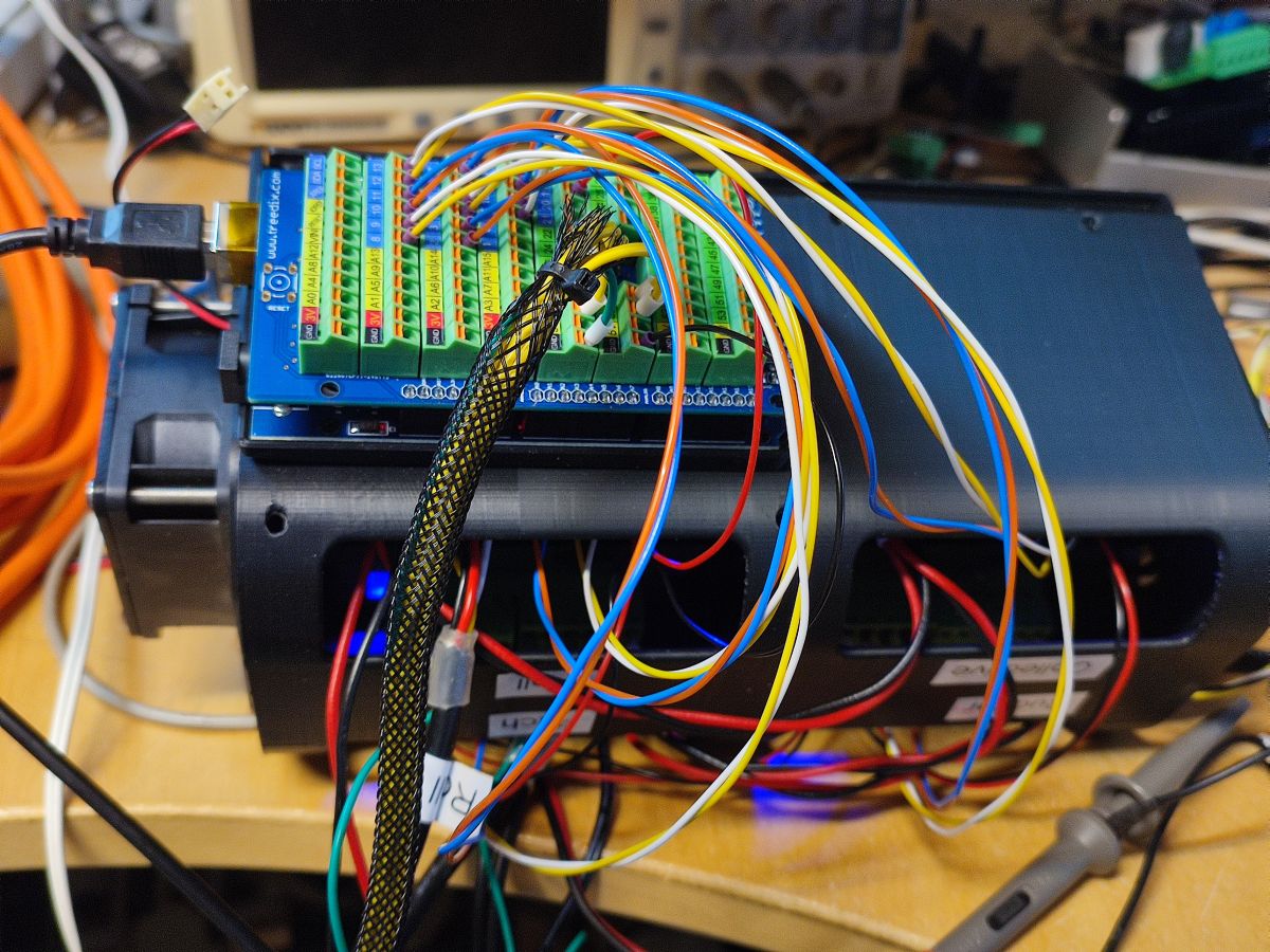

    Today, I was able to connect all the wires for the cyclic control. It still looks a bit messy but it's getting better.
    I also hat to disassemble the cyclic mechanis completely to exchange the stepper motors. The old ones had too much winding resistance and were getting too hot. The new ones stay cold but I have to tune up the current a bit as the torque is too low.

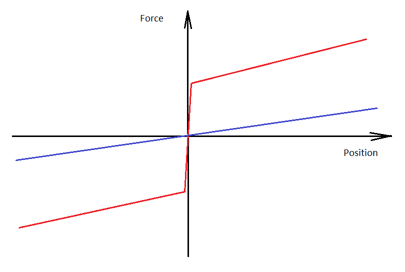

    The problem with the centering spring feedback is this:
    For precise centering and a good feeling you normally want the red curve with a detent in the middle. So you need some "hysteresis" force before the stick actually moves. But that would make it difficult to simulate low force changes as it wouzld have a dead zone in the middle.
    So for optimum force feedback the blue curve with a strict linear relation would be better. But without the ability to react fast (stepper motors) this would give a sloppy feeling near the center.
    So for real force feedback I think we need servo motors where you can apply force directly at any time. Stepper motors with springs can only build up the force with a delay because they need to tension the spring andtherefore need to change position more than the stick actually moves.
