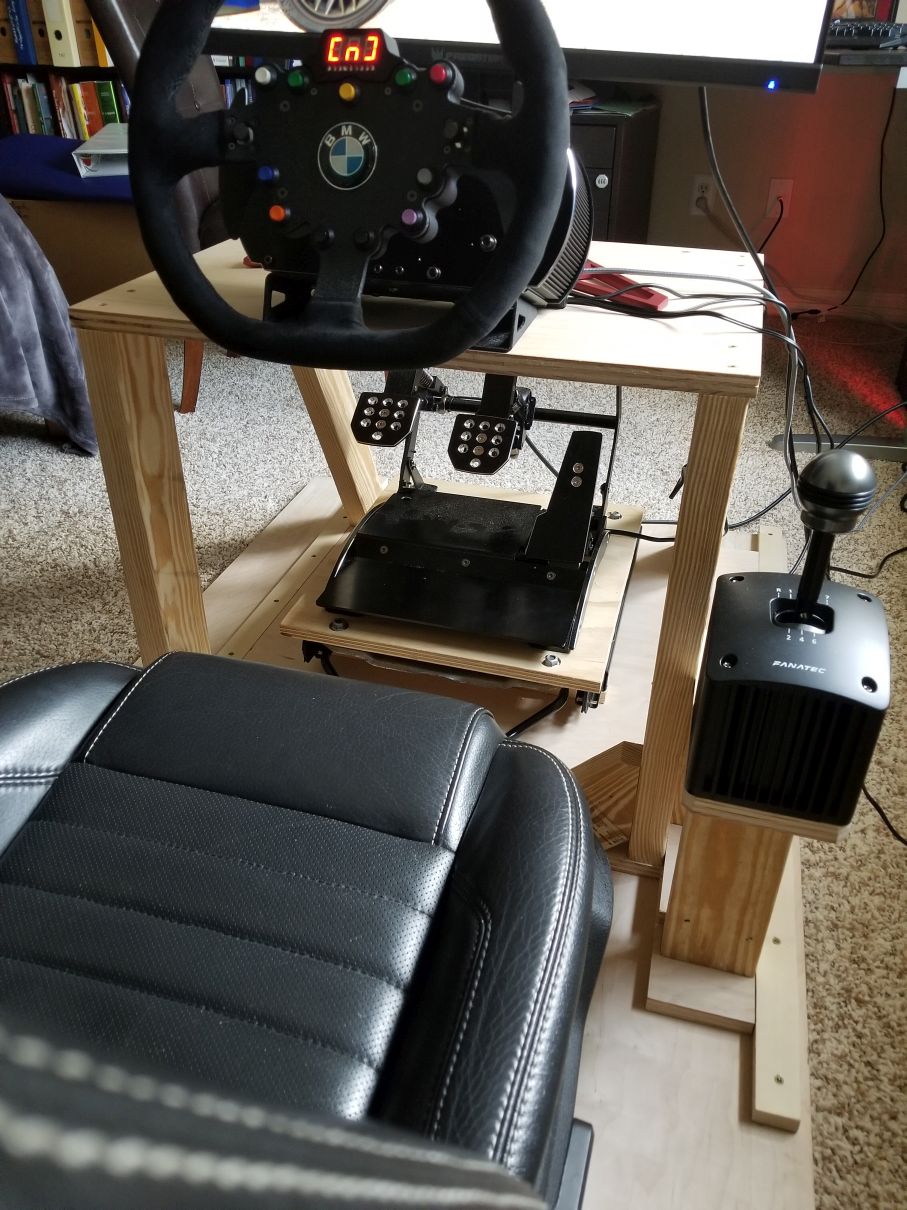

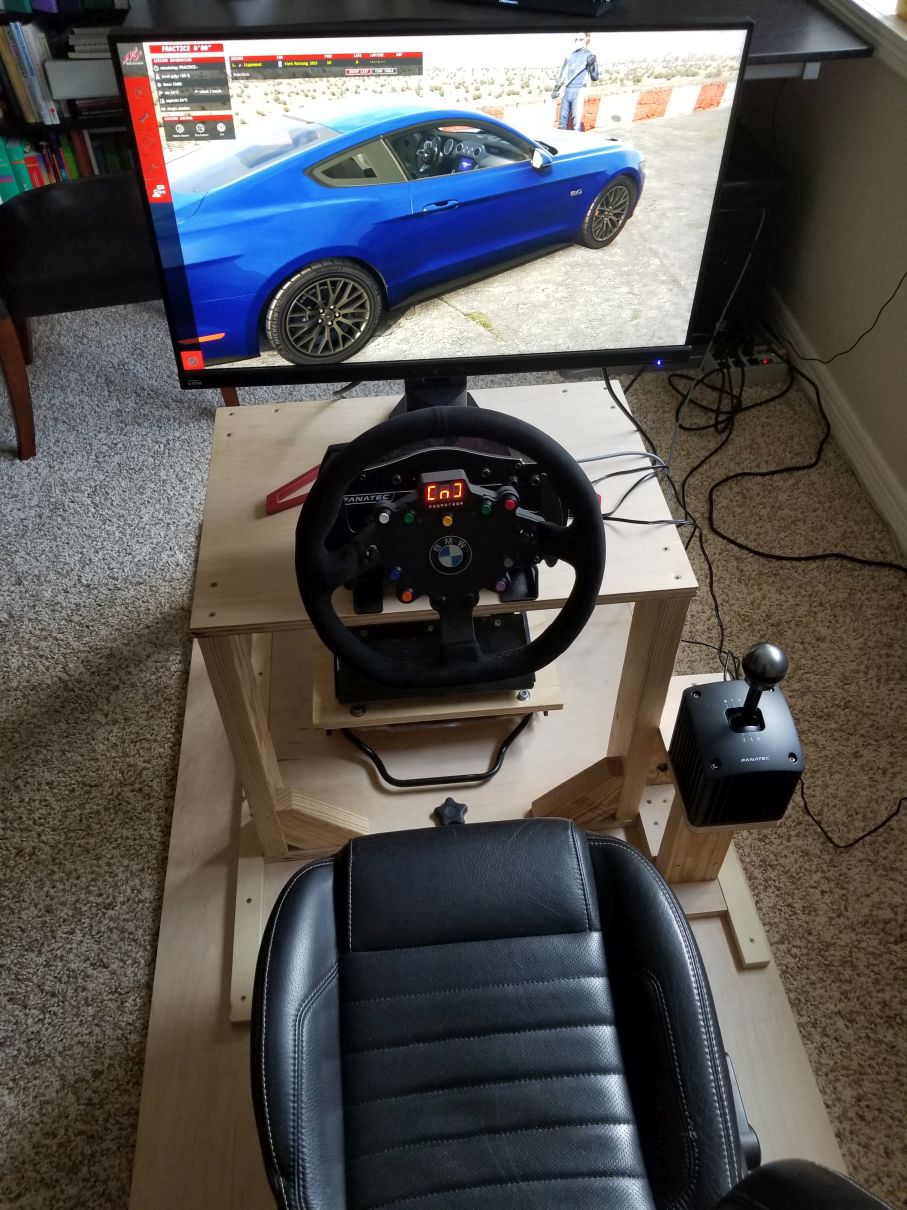

    Hi y'all.
    First thought was to build a 3DOF flight-sim, but then decided to get some practice with a 2DOF seat mover first. Starting point was a leather car seat from a 2011 Mustang GT and a Fanatec wheel, then added H-Shifter and inverted pedals. Planning on +/- 15 degrees of roll and pitch, so considering the weight to be moved I opted for heavy duty wheel chair motors (24 VDC). I could not get data on the motors so far, but they look very solid and are in working condition. Plan is to use an Arduino Uno and Sabertooth 2x32.
    Here some pictures of the mechanical setup (still static).

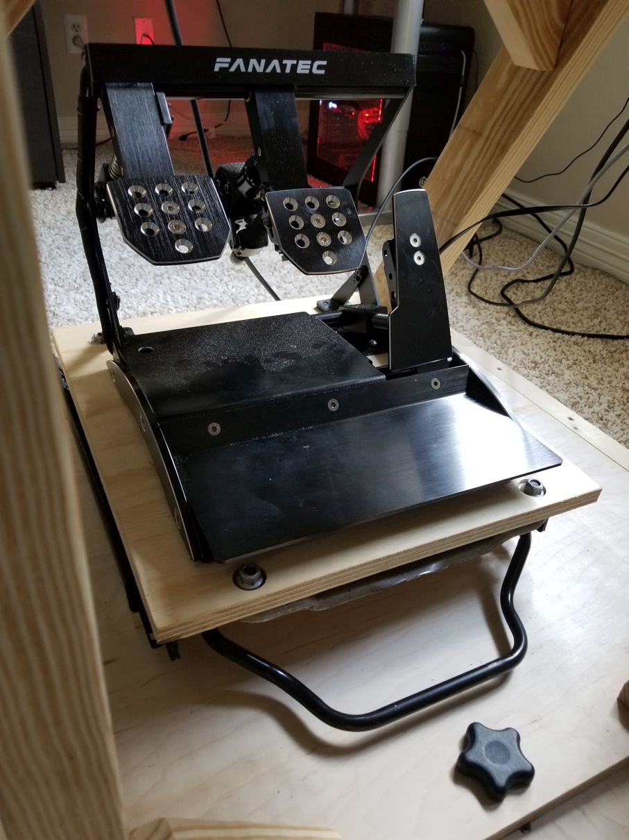

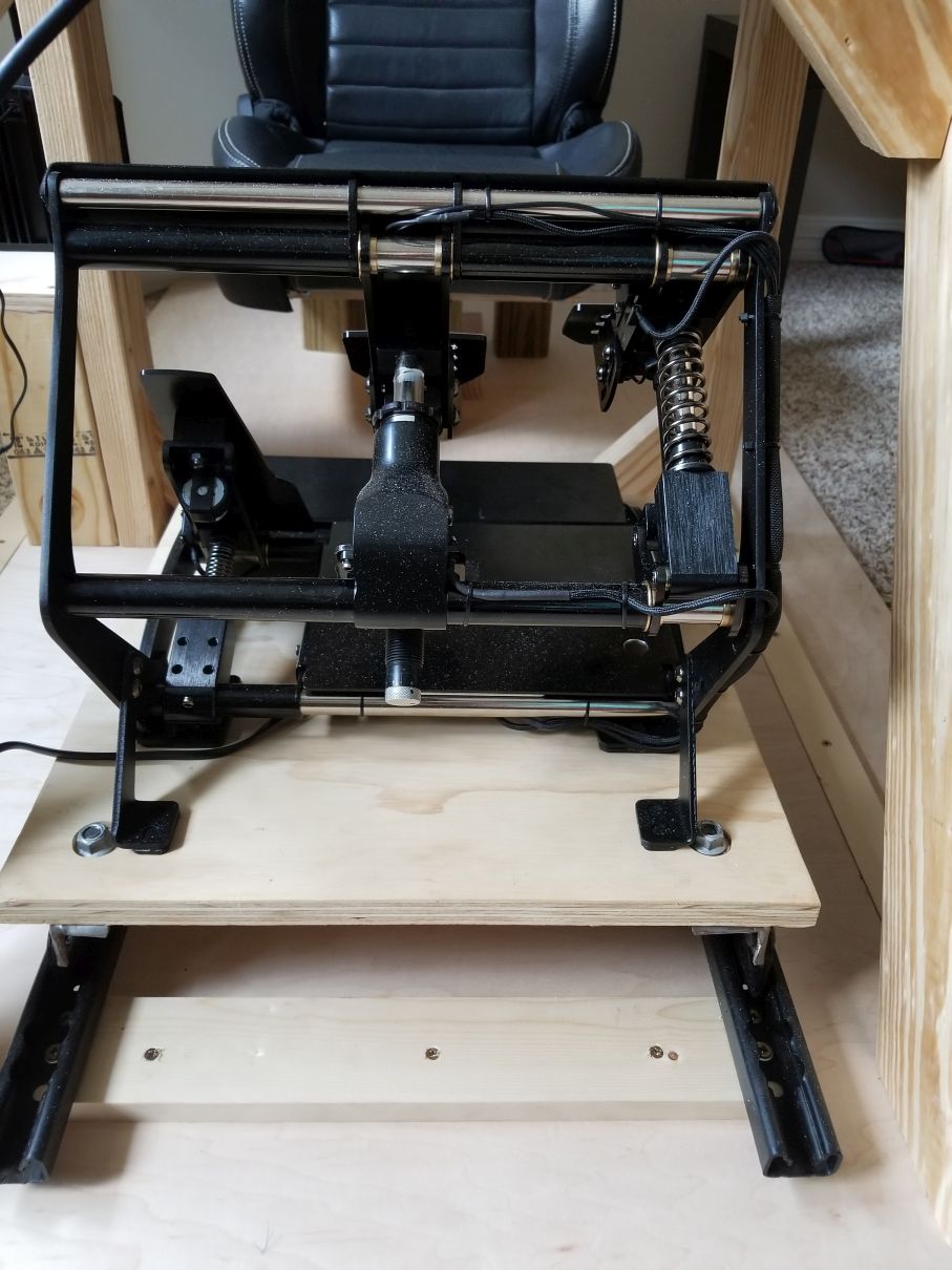

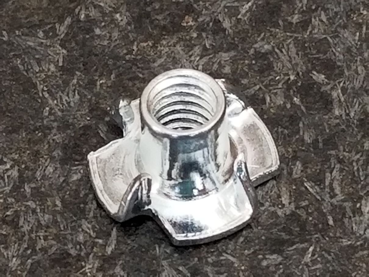

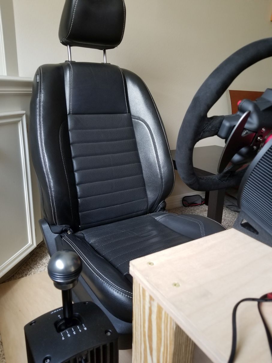

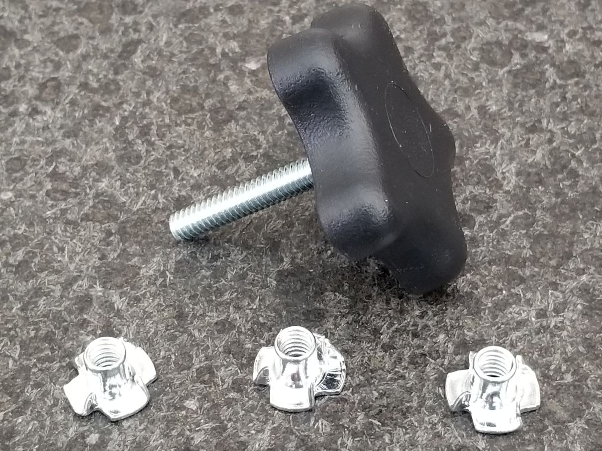

    As also my kids will be driving the sim, the whole rig needed to be fully adjustable. The seat position is fixed (pitch and roll movements via a U-Joint from a motorcycle, pics will follow), the whole table with the wheel and shifter can slide on the base plate between the wooden rails.
    It can be fixed in position with the knob bolt and T-nuts in the base plate at different positions:
    Once the arm-length distance from the seat to the wheel and shifter is adjusted, the pedals can be adjusted separately. I used the seat rails which came with the seat. Make sue to get a mechanical seat, not an electric. Also get a passenger seat. They are typically less worn out and cheaper.

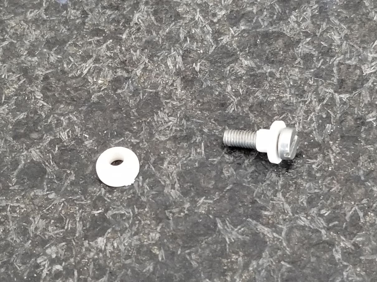

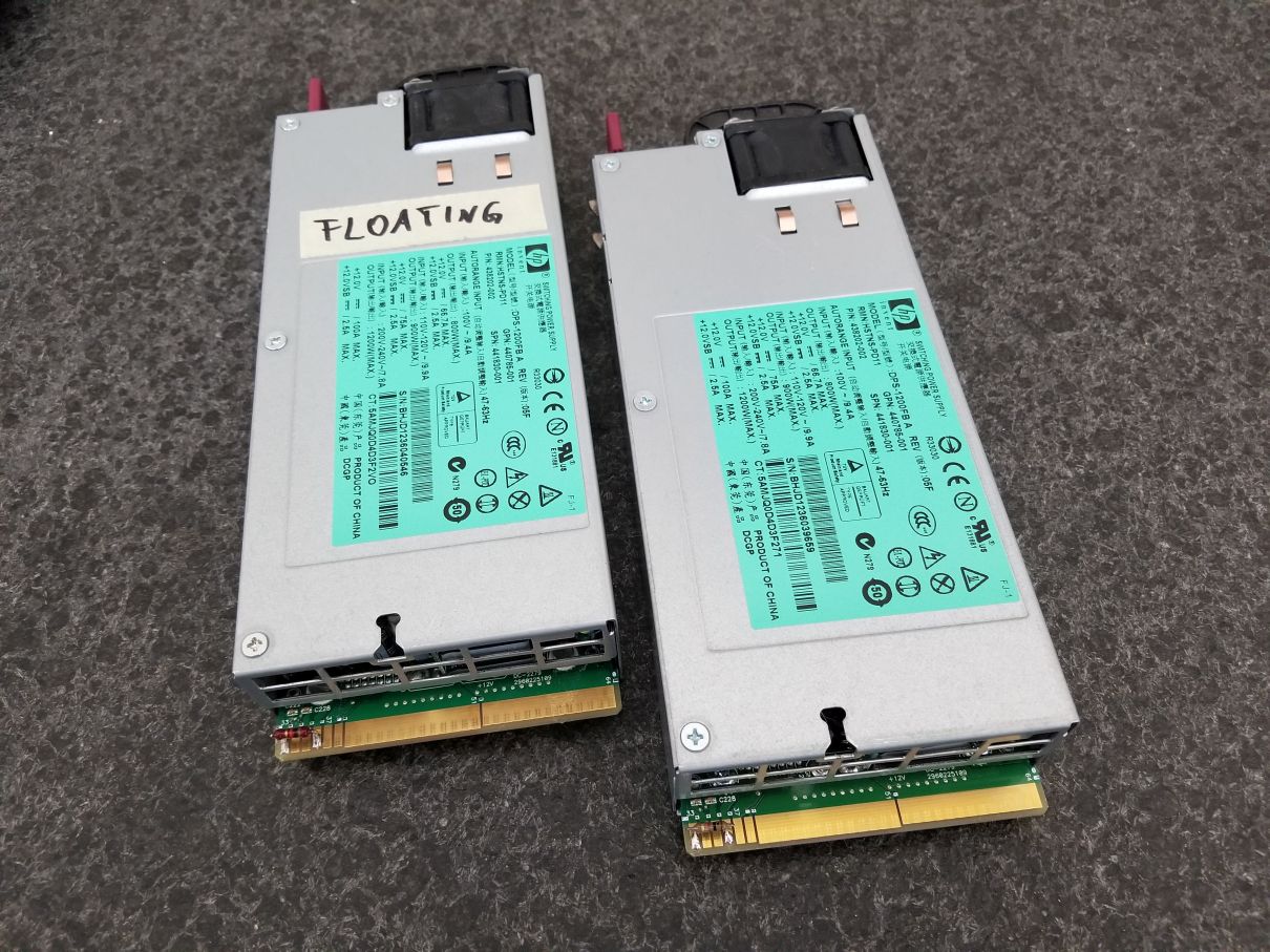

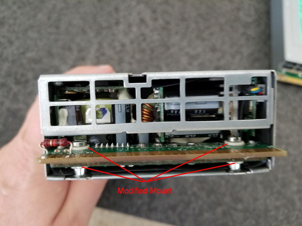

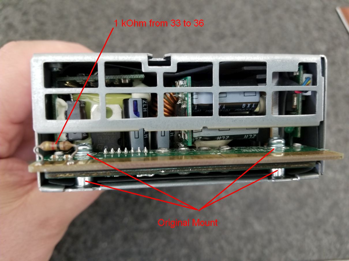

    For the power supply I got two used server power supplies HP DPS-1200FB A. They produce 12V and 75 Amps each when run at 110V supply. To get 24 V they obviously have to be connected in series. As the 12V GND is connected to the casing and AC ground one of the supplies has to be floated. Some float these power supplies by disconnecting the mains ground which I would strongly recommend against as the ground protection for the metal case would be gone.
    To float one of the supplies open the casing and remove the PCB. It sits on 3 metal posts and is mounted with M3 bolts to the casing posts. All you need to do is to carefully enlarge the mounting holes in the PCB to 4 mm (do not go larger in order to not destroy any layers), shorten the metal mounting posts with a Dremel by the height of the insulator you are going to put in) and remount with nylon insulators typically used to mount large power transistors:
    First picture shows the non-floating unit (with the original mounts):
    The pic also shows the 1 kOhm resistor needed between Pin 33 and 36 to trick the power supply into thinking it is in a server rack and to power up.
    The second pic shows the modified mount with the shortened supports and nylon insulators above and below the PCB:
    As mentioned before this way of floating the power supply is preferred as the grounding of the metal casing remains intact.

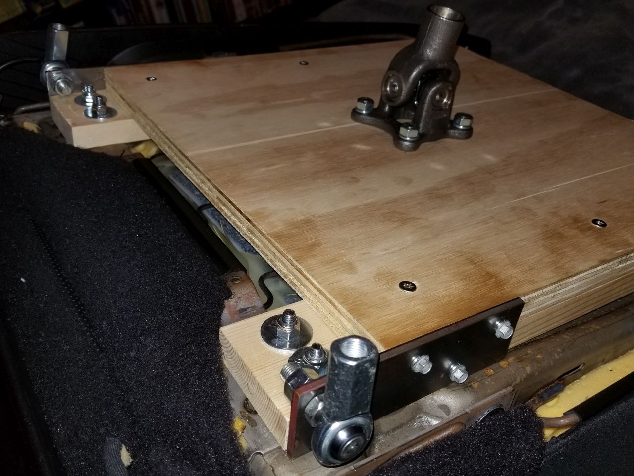

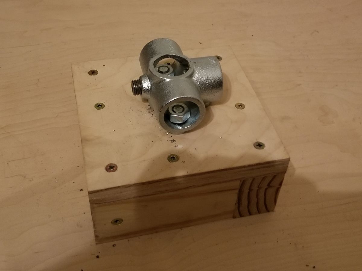

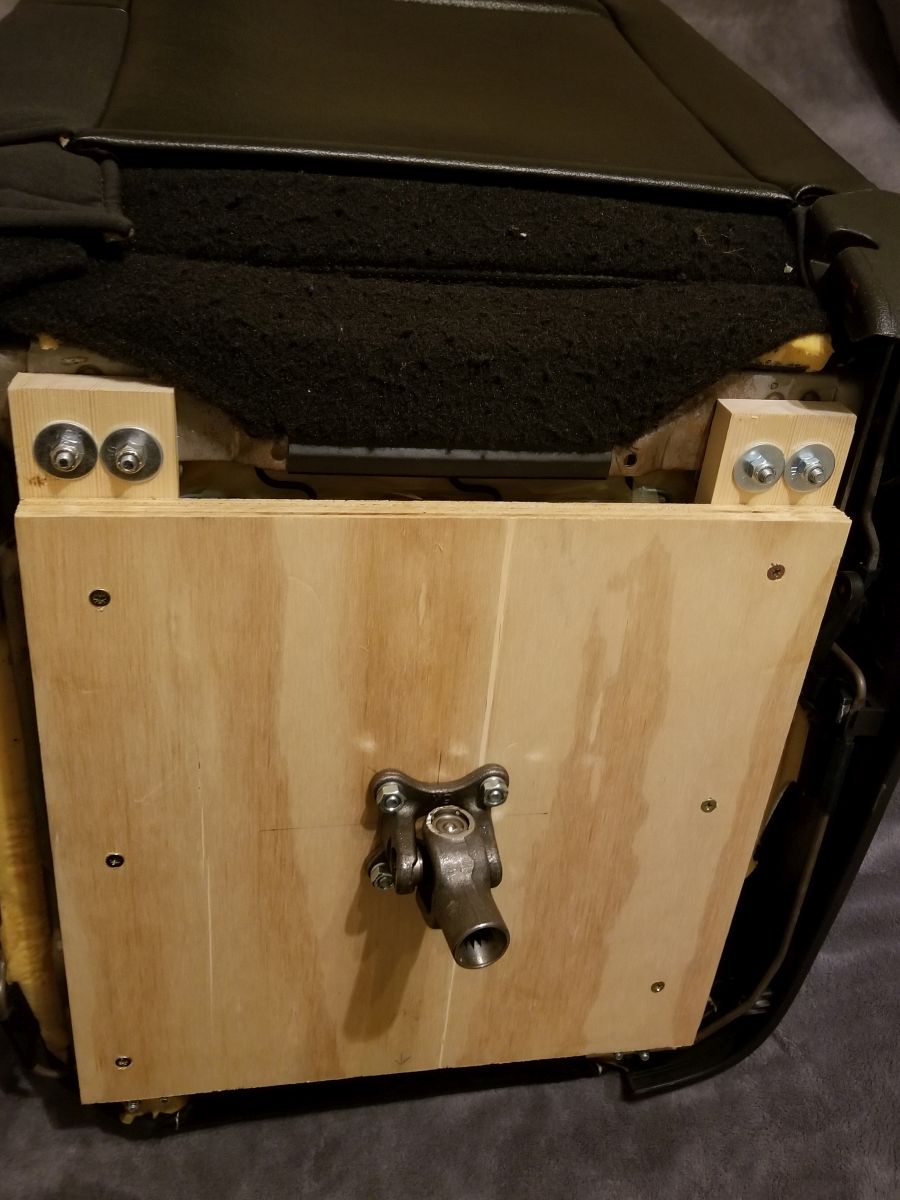

    OK, I am finally back in business. Here are the pics of the motorcycle U-Joint mounted to the seat base plate and the U-Joint base. For the base I used a conduit tee which has the advantage that the seat can be easily dismantled at a later stage.

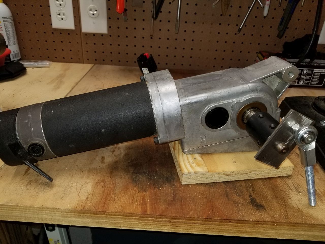

    @MarkusB : After looking at my motors I noticed they have a shaft diameter of 3/4" , the keyed coupling has an OD of 37 mm. Considering the bolt & nut diameter of the rod end I do not believe that I can go with less CTC than 28 mm. With the geometry I have this will result in about 7.5 degrees roll and pitch with 38 mm travel. Will be rough for a seat mover with static pedals, but I do not want to change the whole seat arrangement now. Monitor is not a problem as I use a VR now. Lets see how this goes.

    Next steps done, rod ends mounted to seat base plate. As I use a real car seat (which can recline) I can't use a shoulder mount. Also motors and levers with 28 mm CTC ready for mounting.

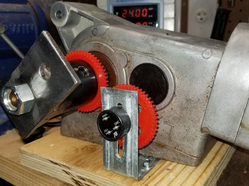

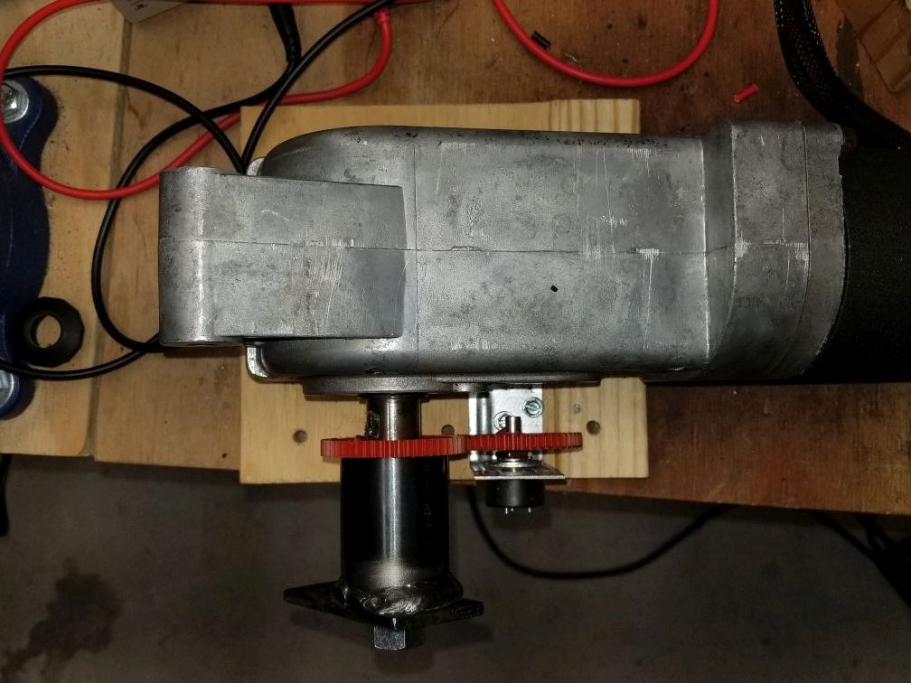

    As my wheelchair motors only have a drive shaft on one side of the gearbox I needed to add gears on the shaft to drive the hall potentiometers. I hope this does not add to much slack.

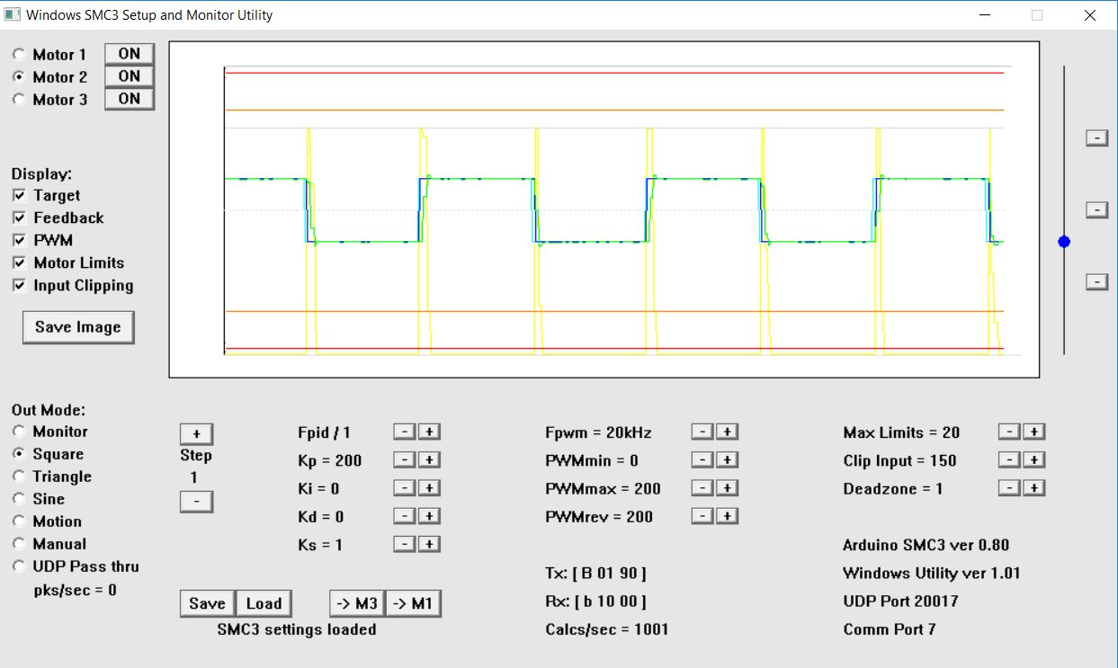

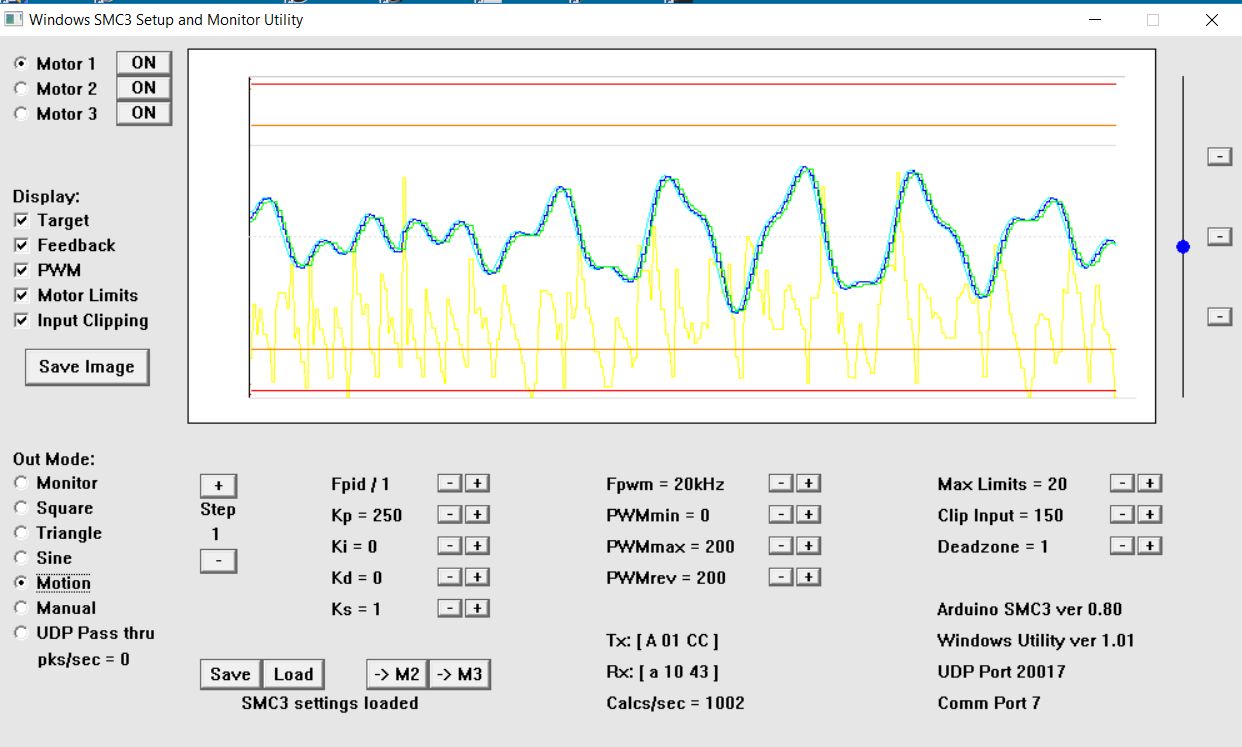

  15. GTexas
    GTexas New Member
    Mar 14, 2017
    26
    Houston, TX
    465Coins
    +8 / 0 / -0

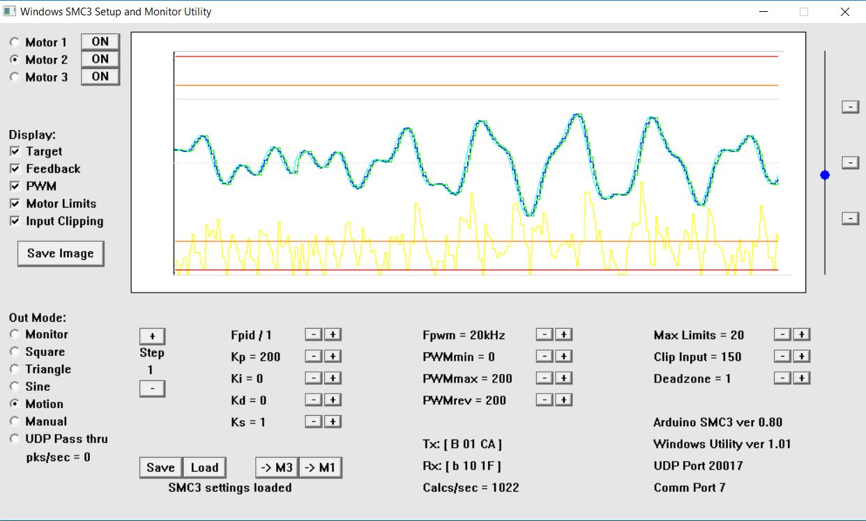

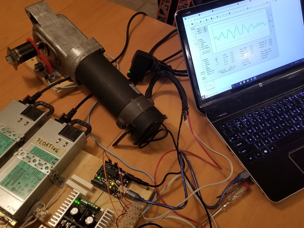

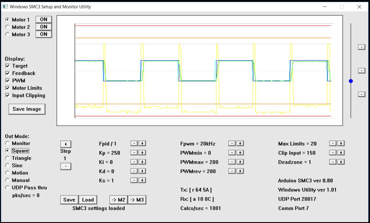

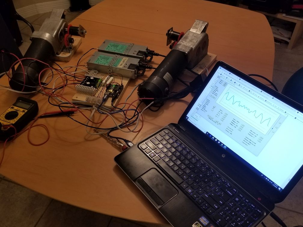

    First motion tests done and preliminary PID parameters for no-load set. Kp values of 250 and 200 were sufficient with no load.
    Next steps: connect motors to seat, adjust hall pots to neutral position and tune PID under load
