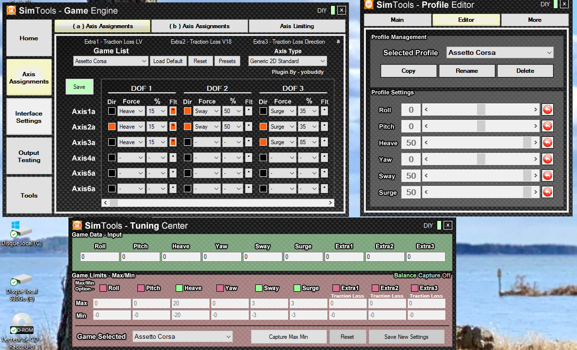

    Hello everybody,
    could you help me, my 3dof simulators surge/sway/heave (which runs very well with a lot of game as dirt 3, BeamNG, DirtRally2, etc..) has a little pb with Assetto Corsa: impossible to have heave effects (even if I increase a lot heave values) ?
    thanks you in advance

    Can you please post picture of all of your Axis Assignment and Tuning Center settings.

    Your Tuning Center Heave setting at 20 looks way too high, I am not near my rig but in some games I even have a value for Heave that is below 1, so substantially lower your TC Heave settings down to low single digits, then test and refine from there.
    Don't mess with the Profile Editor values until the base profile is dialed in, with a mid range car and track like Monza, otherwise you will just distort things.

    OK that works !! great thanks noorbeast, after several months of "no game" I had forgotten that more yo reduce the valus in tuning center, and more high is the gain... French beginner error GREAT SCOTT !!!!!!!!!!!
