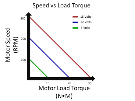

    This graph is a good explanation of a motors response to different voltage level inputs. I think you may have missinterpreted something with regards to danove. He is using less voltage with the specific intention to reduce current draw.

    Yes at a certain voltage his motor gives an acceptable torque that he is after. A higher voltage will give him even more torque but also a higher current draw.
    Again, the voltage applied is directly related to the amount of torque that is available. Also again, disregard rpm unless you are attaching a gearbox.
    You control the maximum torque by selecting the corresponding voltage as depicted in the graph.
