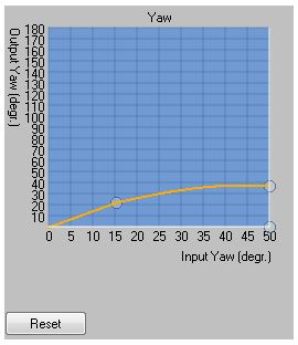

    From my testing what I have found is that the default settings are far to aggressive for car racing games. The default yaw has the view looking out the back of the car with about 30deg turn of the head (may be a bit exagerated but you get what I mean.)
    I wound the settings way back so it just gives enough angle to assist looking into the apex. Below is the yaw curve setting that I am using. As indicated in previous posts I have disabled all other DOF tracking.
