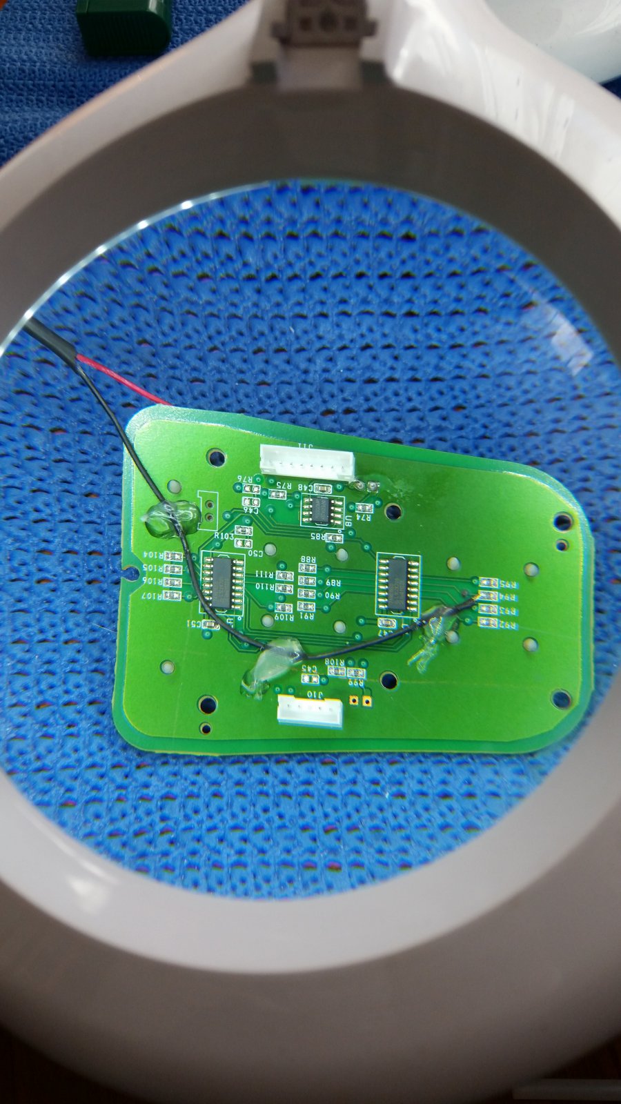

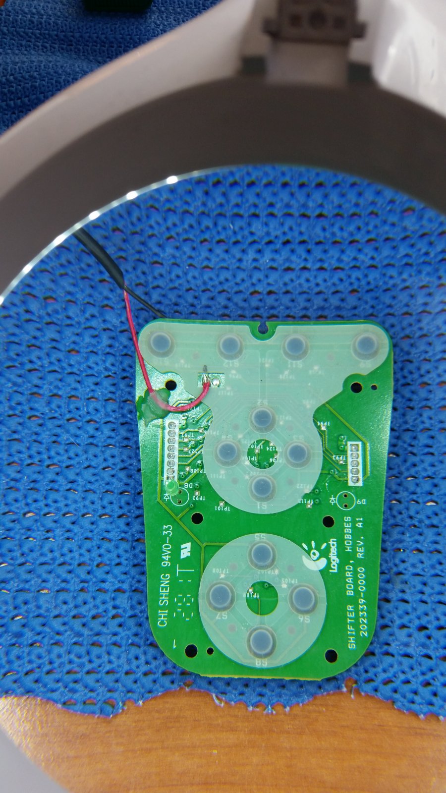

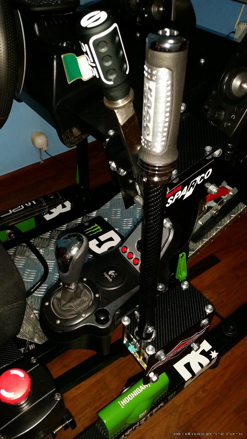

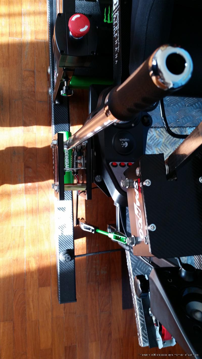

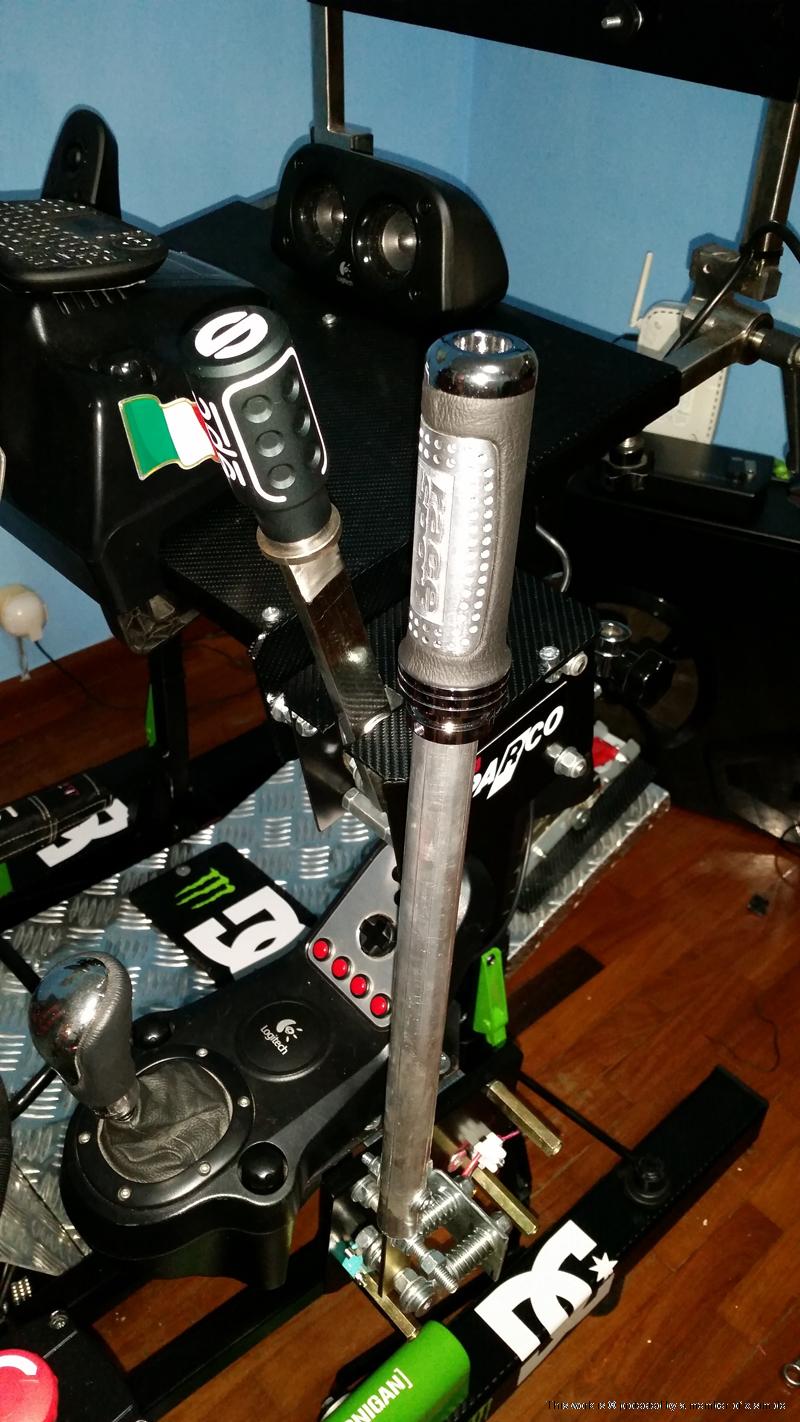

    Because I like so much the rally, I built this handbrake which for the moment is digital .. then I will upgrade to convert it to analog
    needed:
    2 plates of 15x10 cm
    1 microswitch that soon will be replaced by a linear potentiometer and USB interface will use a game pad
    1 threaded rod from various bolts m8 +
    2 springs 6 cm for a diameter of 1 cm
    3 extensions for threaded rods M8 8cm
    an aluminum tube from diamotro 2 cm coated with carbon film
    a recovery lever 30 cm, that goes inserted in the aluminum tube
    Some photos is a video in detail of the building:
    For the moment I connected the wires of the microswitch to the board of the exchange g27
    Video

    @-kevin- looking into making some home made handbrake for myself...can i know how much did you spent in all of those parts?i have an idea on how to make one but i will "steal" yours if i see its worth it hehe
  5. -kevin-
    -kevin- Fast e Furious
    Apr 6, 2012
    249
    Termo Tecnico industriale
    128Coins
    +175 / 1 / -0
    2DOF, 3DOF, DC motor, SimforceGT, 4DOF
    Steal all you want @Pedro :)
    Something it had it already .. however, it cost me about 40 € all inclusive ;)

    The connections I made them on the board of the exchange for the G27 here are the photos: ;)

    Thank you guys ;)
    @bberger on the handbrake and connected a simple microswitch.
    I do not know if you mean this
