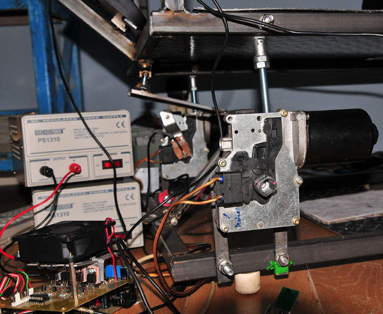

    I have been using such sensors without any problems. KP settings I set to 10. No problems with HBridge. Maybe you should try another magnet and equipped with sensors as close as possible. AMC shows the values of 0, but at a small angle. To avoid the overshooting I was a bit limiting in the X-Sim software with percent limiter.
    Here are some photos of my installation.
    And video

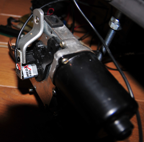

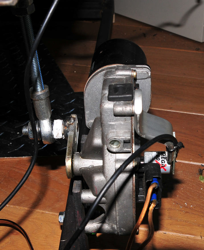

    The requested photo's
  15. ru.null
    ru.null Member
    Feb 24, 2010
    46
    Petrol stations tech support
    Russia, Rostov-on-Don
    290Coins
    With such a magnet, the angle of displacement is not more than 30-40 degrees. This is clearly not enough. You need a magnet, some like me in the photo, with opposite poles at the edges. Also in front of him, too, magnet? If yes, then it can affect the sensor in certain positions.

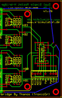

    If you have problems with overheating HBridge, you can try to connect GND, as in this figure. And replace IRFZ44N to IRLZ44N if you use IRF.

    I wanted to install magnets like yours but i can't find those type of magnets.
    But with the construction i made you get more degrees of displacement than 30 / 40 degree. In the middel it 512 and a quarter turned counter clockwise 998 and clockwise a quarter gives 40.
    Also i think this setup has a to weak magnetic field. Otherwise my readings should be 0 and 1023.
    If i use an old hdd magnent the readings are 0 and 1023.
    But because of the shape of the magnet (same as thanos uses) i can't use it and will look for strong magnets like your construction.

    update findings today:
    Today wired both connection (ground) like in the picture the blue wires. After testing only one motor (Motor 2) is working on when i move sensor to the magnets. After disconnecting blue wire (ground) from the (motor 1) half site of the h-bridge, both motors are responding again. So this is a bit strange there should be a bad connection of some sort in motor 1 site of the print.
    Bin measuring all parts and also bad soldering, but i can't find directly what should be wrong. To me the voltage on mosfets etc.. looks ok. Did not change the irz44 for the other type yet because i still believe must be something else because it worked fine with pots.
    For now i have disconnected both ground wires. I checked without the h-bridge connected the amc and measured the voltage of the hall sensors. when in mid position the reading is 128 128 509 509 and in voltage 2.47 V and when reading = 1002 then voltage = 4,87v and when 0 = 0v.
    So the hall sensors are putting out the right values and are ok.
    When sensors are connected but laying on the ground the motors don't wine. when i use a old hdd magnet and move the sensor to mid position (509) the motor does whine a bit.
    Tomorrow i will try the condensators etc... (frakk's idea) to get rid of the wining noise. Didn't head the time to go to electronics store to arrange the parts.
    So and conclusion the noise should be solved quite easily, but the heating :sos: i don't know just yet what to think !!!!!

    @ ru.null,
    I managed to solve issue with ground (blue wires in picture) that you told
    me, but did not change mosfets yet.
    Mosfets irlz are ordered.
    But i also saw a noter upgrade that you made see quoted text:
    We use Thanos H-Bridge with IRLZ44N mosfets. Now hbridge working properly.
    Another minor modification is that the motors are connected to the mosfet
    coolers to reduce electrical losses.
    Now i'm wondering how did you wire this, just put a wire from cooler to
    ground of the motor?
    Can you explain this how to do?
