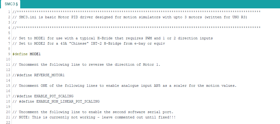

    Hello, these hall sensors of 360 degrees are recommended ?, I do not want to put gears, I would only use 180 degrees.
    Another doubt is that they only work in one direction, how can you put one to work in reverse? use smc3, I do not know if software can control that

    You can not reverse the polarity in the hall. The software I think I had an option to invert the meaning to the engine 1, it was in the first lines.
    No puedes invertir la polaridad al hall. El software creo que tenía una opción de invertir el sentido al motor 1, estaba en las primeras lineas.

    Here it is, line 13

    i think you mean line 13. line 9 are for the H-Bridges

    Reverse only motor 1?

    It's much simpler to just reverse the positive and negetive leads to the motor. Then if motion is backwards on that motor change the direction check boxes where needed in Simtools.
