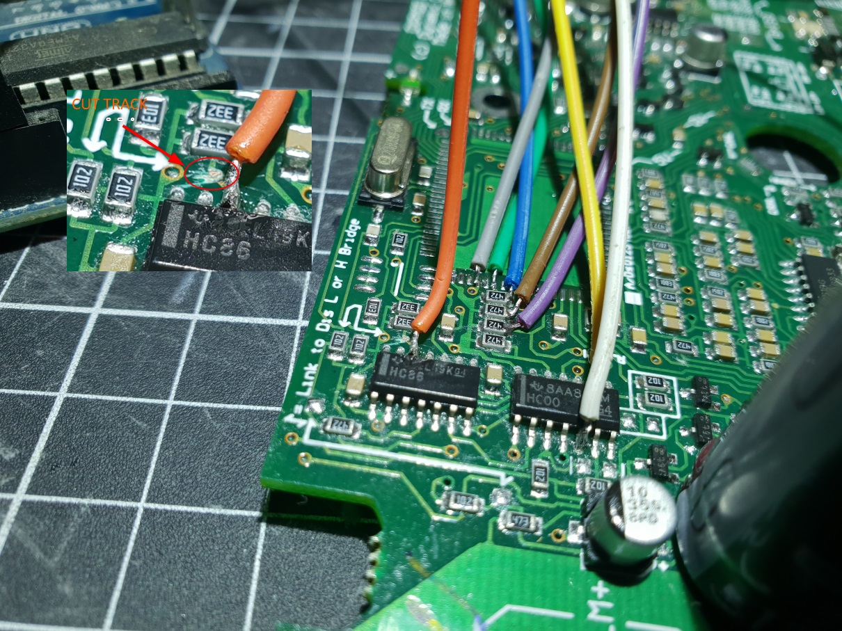

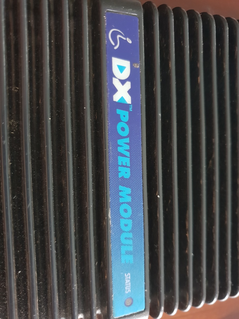

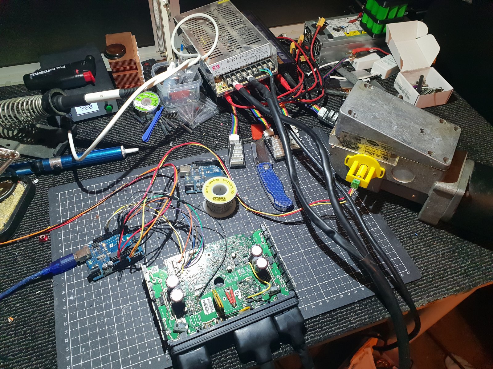

    8 or so years ago I build my first racing sim. I always had the intention of making it a motion sim but never got around to it.
    About 2 years ago, I purchased a powerchair from a liquidator/auctioneer for $25 with the sole intention of using the motors on the sim. They are BIG! About the size of a large car starter motor each. I stripped the chair down to the bare motors and controller and had a go at trying to control the motors more directly but it basically went in the too hard basket and then forgotten about.
    For those that don't know, powerchair controllers are seriously technical as they have to have many safety features, tuning controls for accelleration/turn etc. So trying to use the 'real' interface to control the motors for use on a sim was impossible, plus it uses a proprietary CANBUS protocol.
    Recently I got re-inspired to have a go at motion again so assuming I could not use the chair controller I started looking at what I could do to control the huge motors but all the products needed for these motors are seriously expensive (and I am cheap).

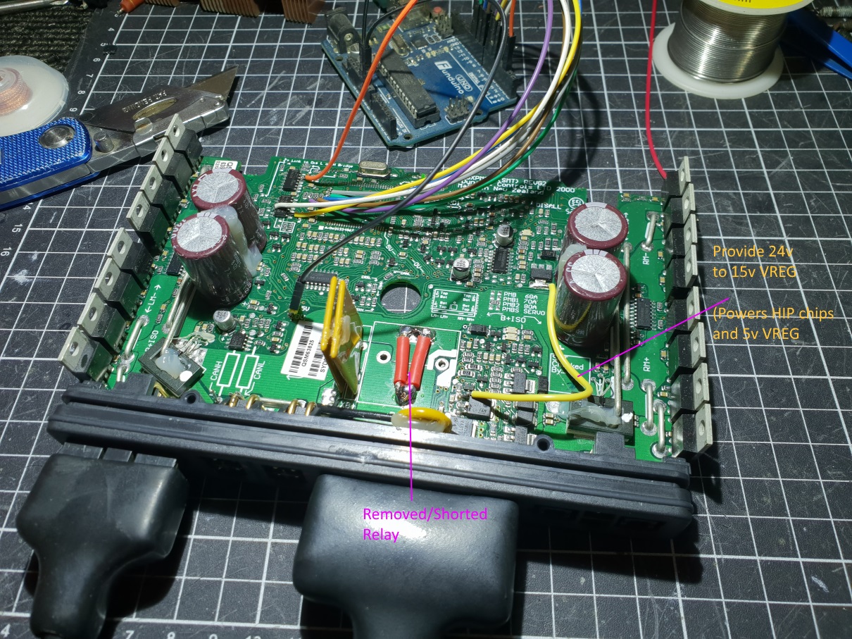

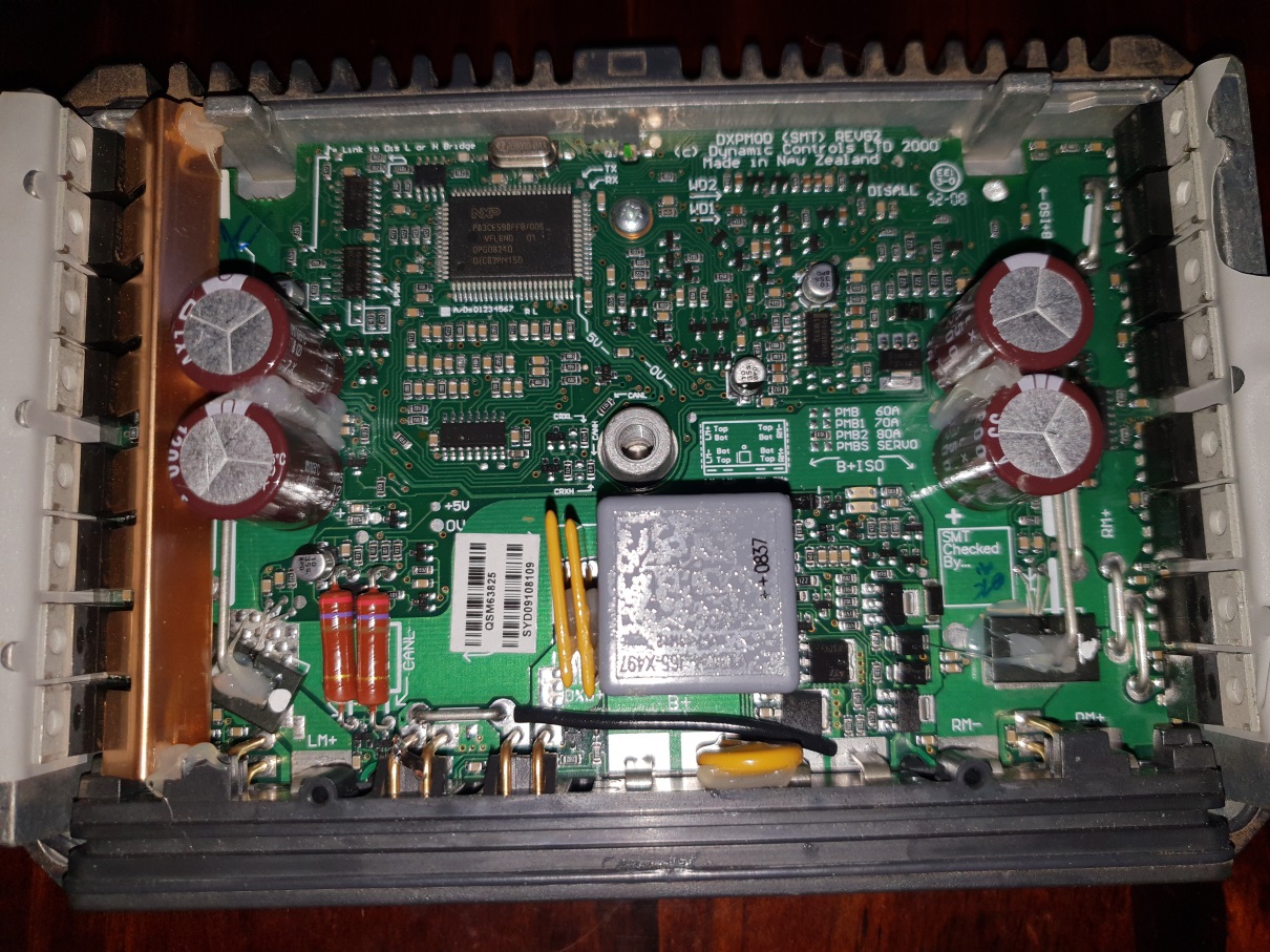

    Here I had this 140A per-channel capable dual motor H bridge 'unit' but could not use it. So in frustration, I started looking at how much I could 'strip out' of the controller to give me direct control of the motors. As it turns out, it uses a standard off-the-shelf HIP4082 H-Bridge controller for each motor, so at absolute worst, I could cut all the tracks and just use that. However, it also has some cool features like a current sensor for each motor and some gates that simplify the signalling to the HIP4082 chip.
    I approached the manufacturer to see if they could offer some assistance which at first seemed really promising but in the end resulted in a big thumbs down on any usable info - Boooo.

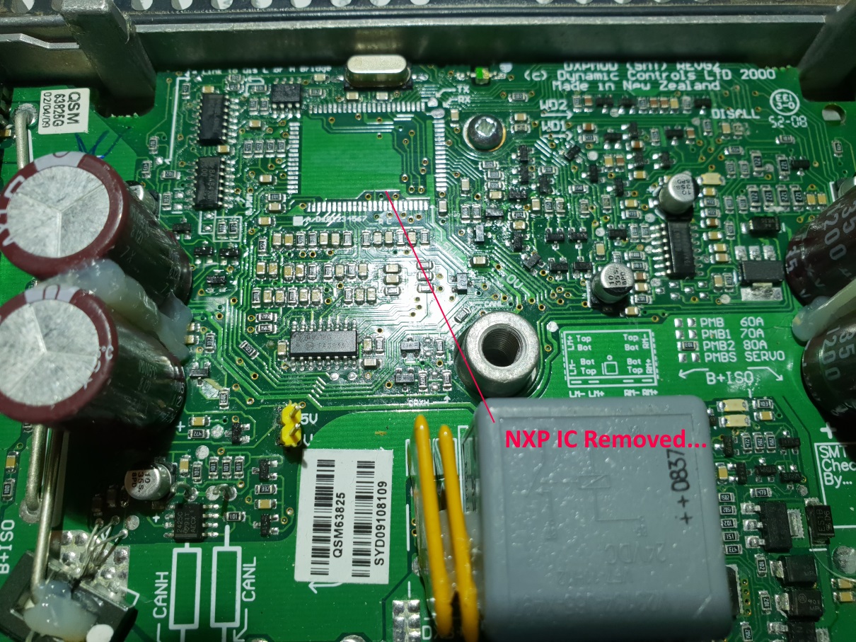

    So, refusing to be beaten, I have spent several days reverse engineering the controller functions with multimeters, logic probes etc and got to the point were I was confident that I had identified all of the important pins and could replace the standard NXP microcontroller with an Arduino!
    Out with the hot air gun, I removed the NXP but got met with some disappointment as there seems to be some other smarts that control the power rails in the controller but with a bit of ingenuity I have got those rails up and running and today have managed to control the motors directly with an arduino!!!
    There is still a lot of work to do but I am so happy!
    The controller is a 'Dynamic Controls DX' which is linked to 'Invacare'

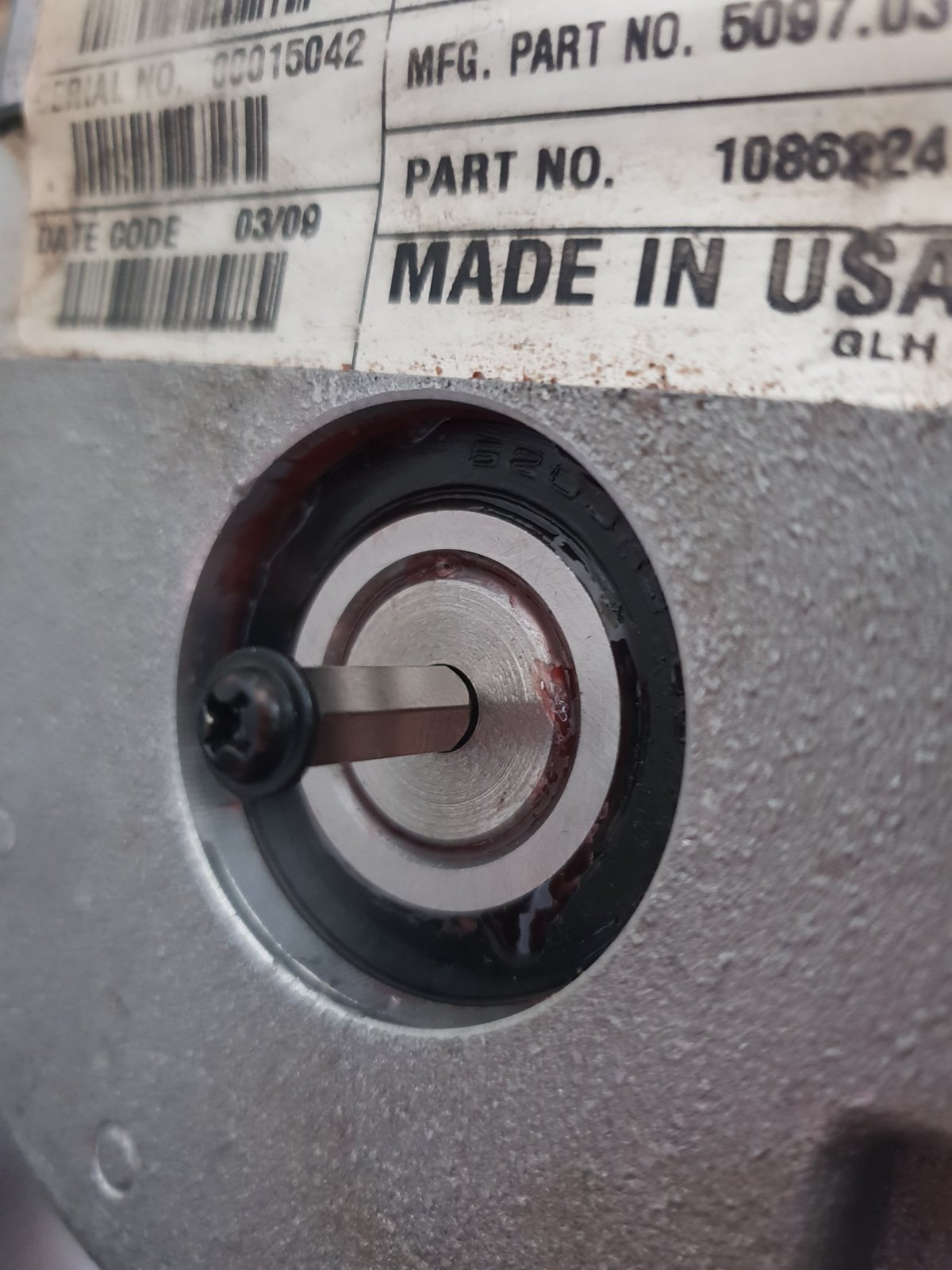

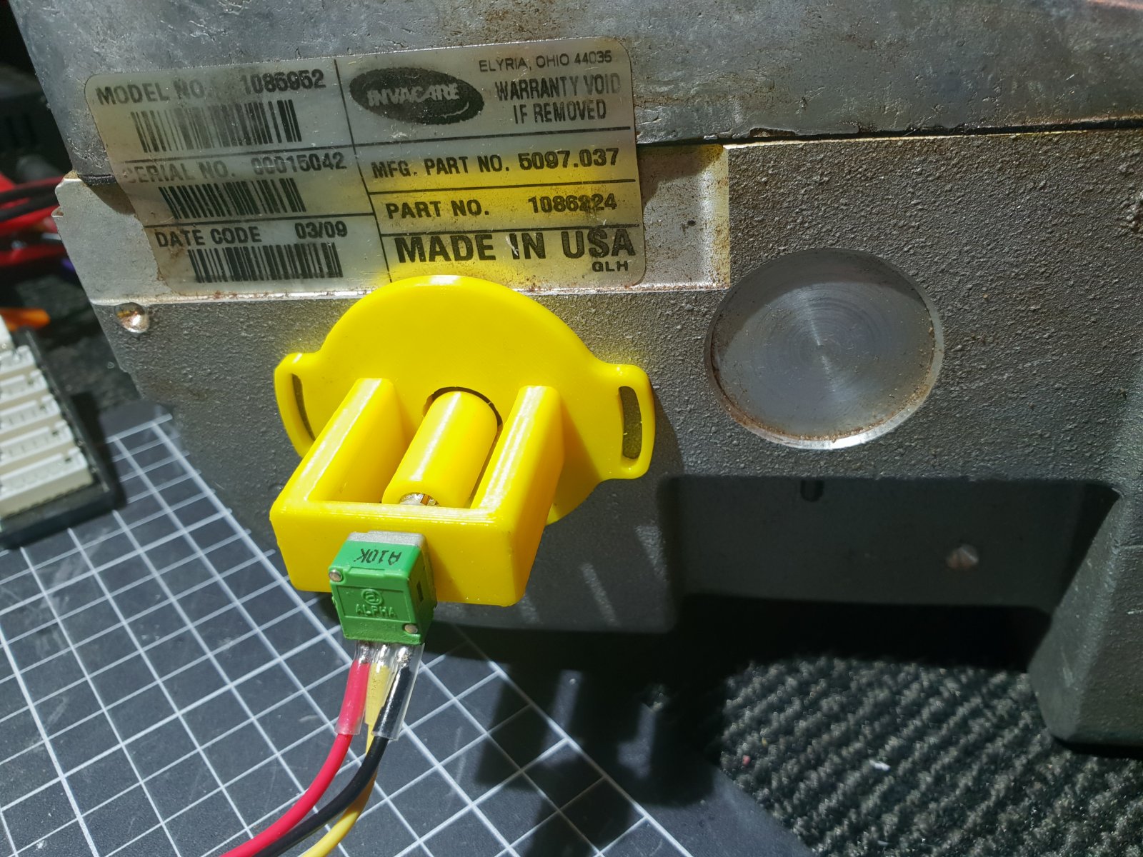

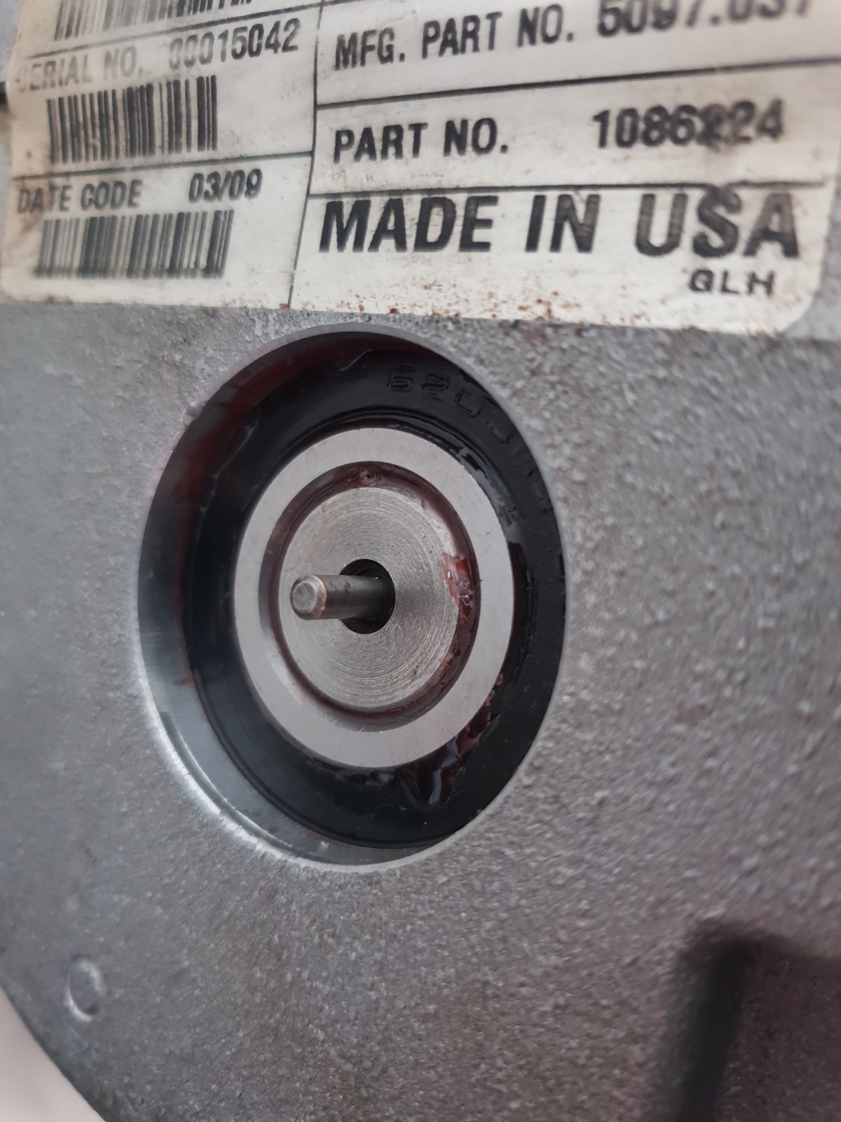

    I designed and printed some potentiometer mounts that secure to the back of the motor shaft by removing the rubber seal. I hope that this should not cause any leakage. If it does, I will replace the internal grease with something with a higher viscosity.
    The shaft had a small 3mm hole in the back from the original manufacturer machining - I inserted a hardened pin into this and then secured a hex standoff to it with some retaining compound. This allows for a basic coupler to the pot and is very accurate (no wobble).
    The pots in use here are only for testing, I am going to make some Hall sensors instead.
    I have now added a 'MODE3' to the SMC3 code to be able to deal with the different control method and went through some testing.
    So far it is very good but there is some play in the output shaft gears that have lead to 'ringing' - I am hoping with the hall sensor and some load on the motors, this will no longer be an issue.

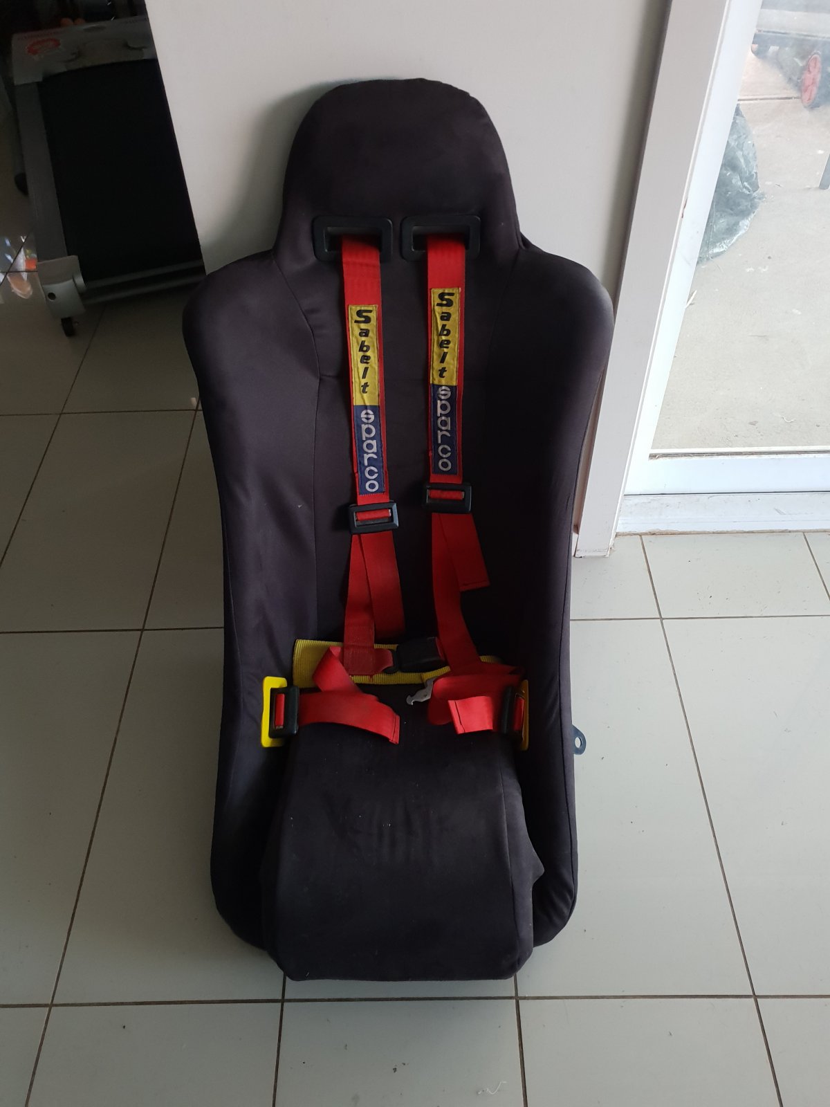

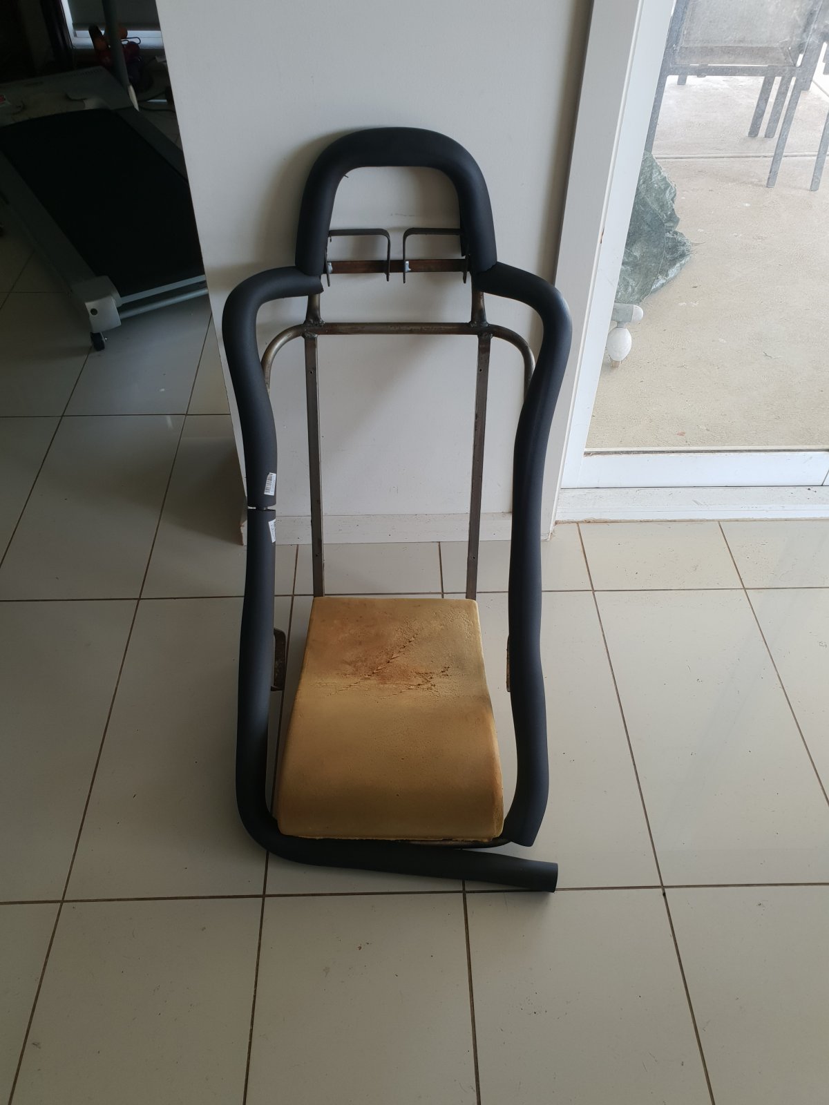

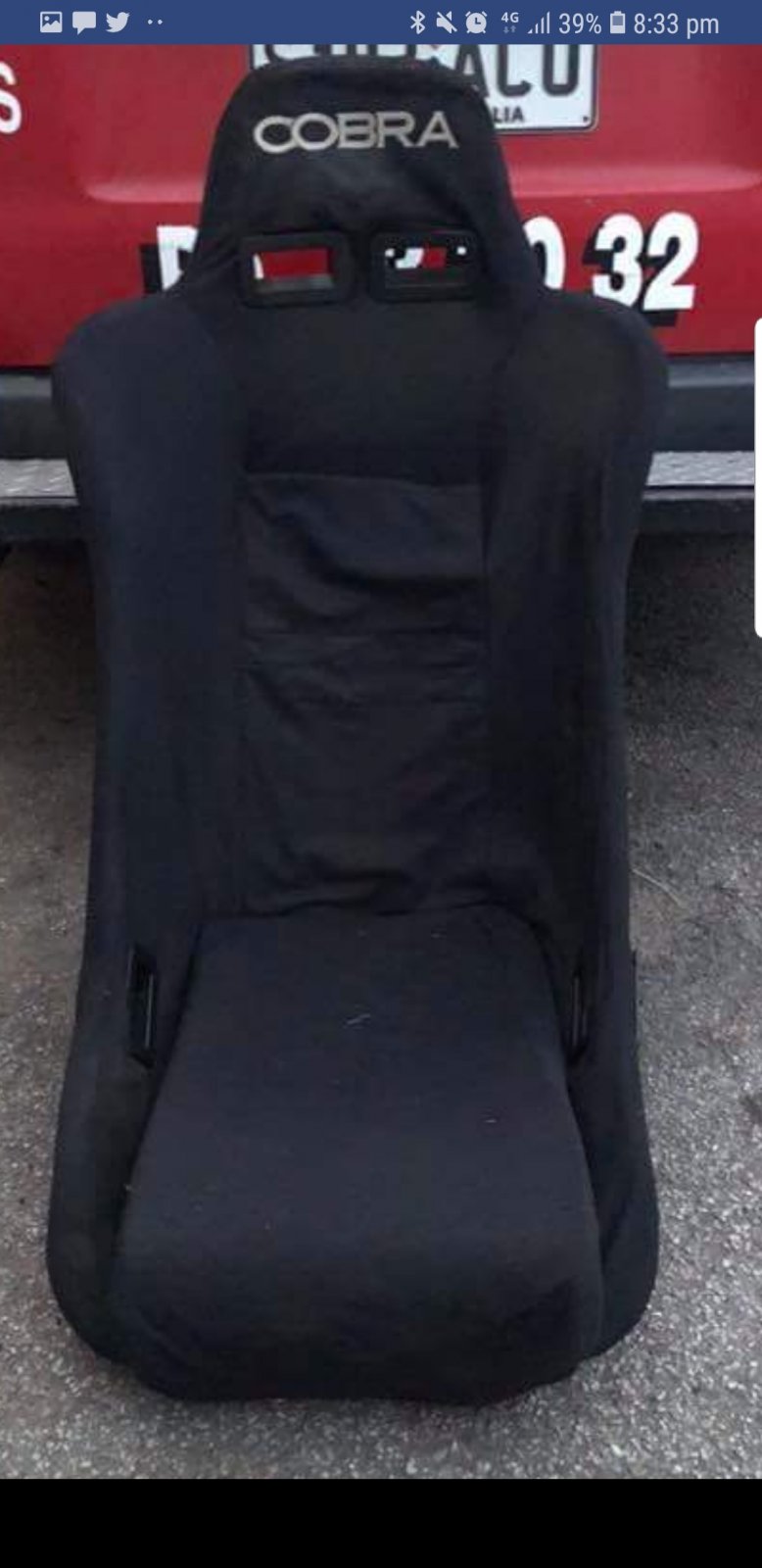

    I also located a cheap racing seat which I re-trimmed and a harness :)
