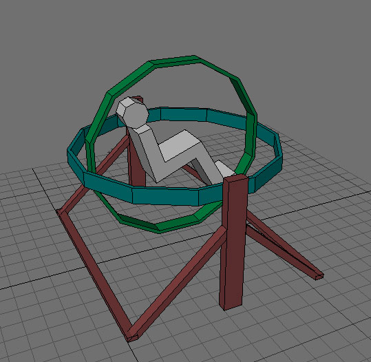

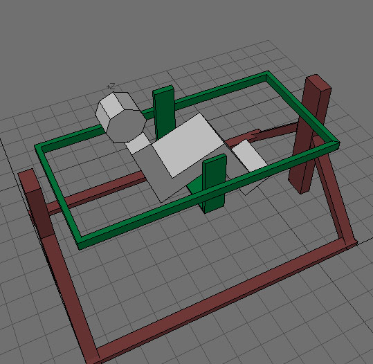

    Here is a little 3D Sketch of what actually is in my mind + the proof that such a sim could fit into a room with 2,30m ceiling height.
    The frame most likely needs more stabilisation in the roll direction. So maybe at the end it will be more like a cubic cage with diagonal bars.
    However with these dimensions it requires 2,20m x 2,60m x 2,30m. The space inside currently measured by a person which is about 1,80m like me.
    It could be made even a little smaller so it fits in rooms with exactly 2,30m height.
    If someone considers rotating the whole thing for a 3rd axis this would require a room of about 4x4m.
    My rooms in the second floor are 2,36m in height so there is a gap of 6cm. Should be enough for the movement.
    In this example the rings are planned in 80x40mm rectangular pipes.
    Maybe even too massive to heavy and consuming too much space. I will calculate the weight and stability for different materials but from my experience
    60x40x2mm steel pipes should do the job as well, at least for my weight.
    Aluminium may be better for the weight but usually the torsion stability isn´t worth the try plus it is difficult to weld... at least for me.
    There is another thing that should be considered. The diameter of the rings should fit through a door. In this concept the outer ring is 1,95m this fits through most doors
    but I guess I´d have problems getting it up the stairs so it will be better to have half rings connected with bolts.

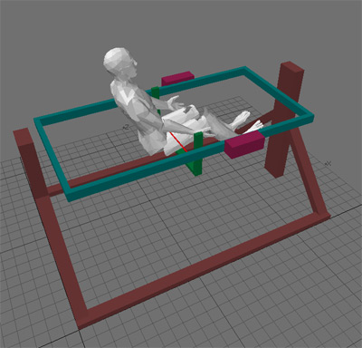

    Today I was thinking about the best position for the "pilot" flying the simulator. When I started this "project" I thought the best position would be what best fits the available space.
    But I think I was wrong. Considering that we are used to a pivot between our legs and our torso as we know it from gymnastics on a bar this is a way better position. For the sim mechanics the perfectly balanced center would be the better choice but due to changing pilots this will be hard to achieve.
    Conclusion: The base position for the seat should be as close to the pivot as possible but still be configurable. Sitting too much backwards or to the front will cause the pilot to move a larger diameter at loopings increasing the feeling of falling plus drawing way more force to the geometry.
    I am not quite sure but I think the pivot on jets is way behind the pilot, this is no real option for the sim so the movement will not be as realistic as in a modern jet.
    However it will be hard to simulate an afterburner and such things anyway ;-)
    (Sorry for mistreading the human 3D model, I was too lazy to add bones so I chopped his limbs :D .)
