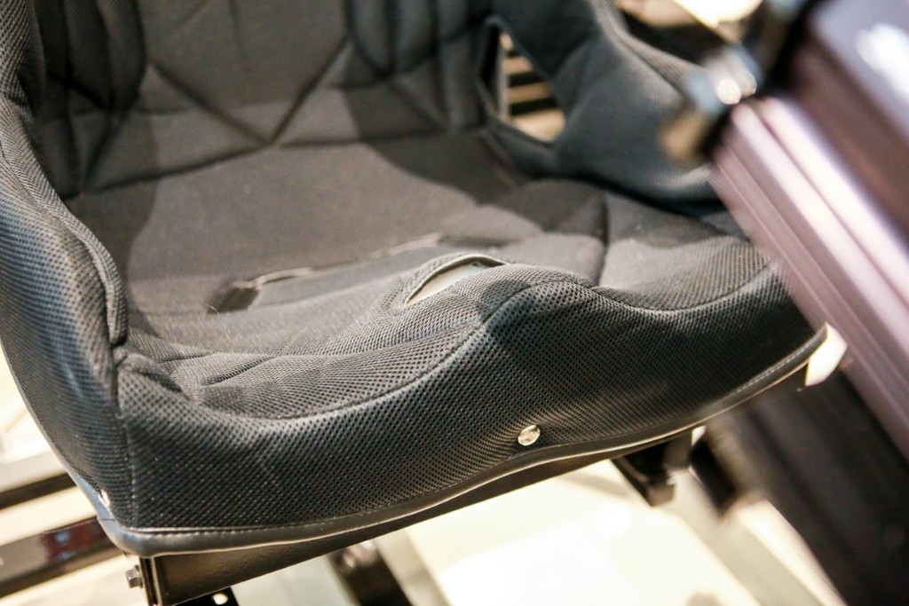

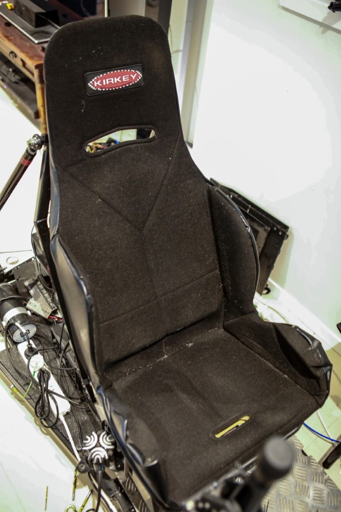

    2. The Seat in general
    The seat itself is still a Kirkey seat but instead of going for a custom Series 16 Economy Drag seat like they had on the GS-4, they have stepped it up to a custom Series 47 road race seat. This is a massive step up in both looks and comfort, I will cover the comfort more in its own section. The GS-5 is now a full-on road race seat complete with side supports and shoulder supports, and it has to be one of my favourite seats I have tried, seriously, I was tempted to by a pair for my road car. I think it was a really good move to upgrade to a much nicer seat.

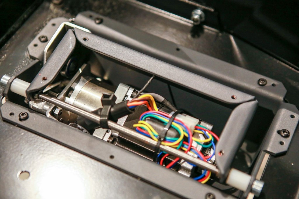

    3. The motors
    The motors have taken a drastic step up in spec. The GS-4 was using 16 small RC servo motors but the GS-5 has upgraded to 4 massive stepper motors with planetary gearboxes. So instead of the 4 small motors per panel that all needed to me synchronised, they have switched over to one big motor per panel. This give you a ton more power and torque, and it feels a lot more direct. It really is like going from something like a G29 up to a Direct Drive wheel, except you have 4 of them in your seat.
    The motors are a high torque Nema 23 SM57HT82-3004 stepper motors which clock in at a massive 1.2kg each, without the gearboxes

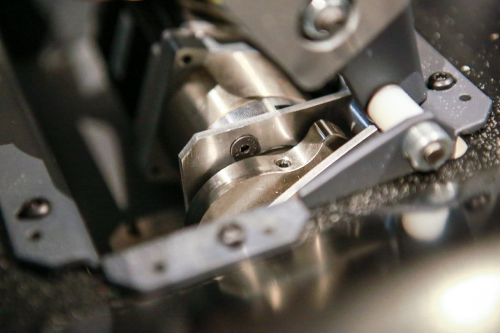

    4. Mechanism
    The mechanism for moving the panels has also changed. Before it was just a lever arm and push rods which always looked flimsy to me. They have replaced this with an ingenious cam and roller bearing type arrangement which gives you much smoother movement. It allows for really efficient use of the space under the panels. The little motor pods are pretty much entirely taken up by the motors and the lift mechanism takes up barely any room, this allowed them to put such big motors in.
    It is quite packed under the panels
    This is the cam lift mechanism
    And the bearing that rolls along the cam profile
    Compared to the old GS-4 lever arm and push rod which looks flimsy.

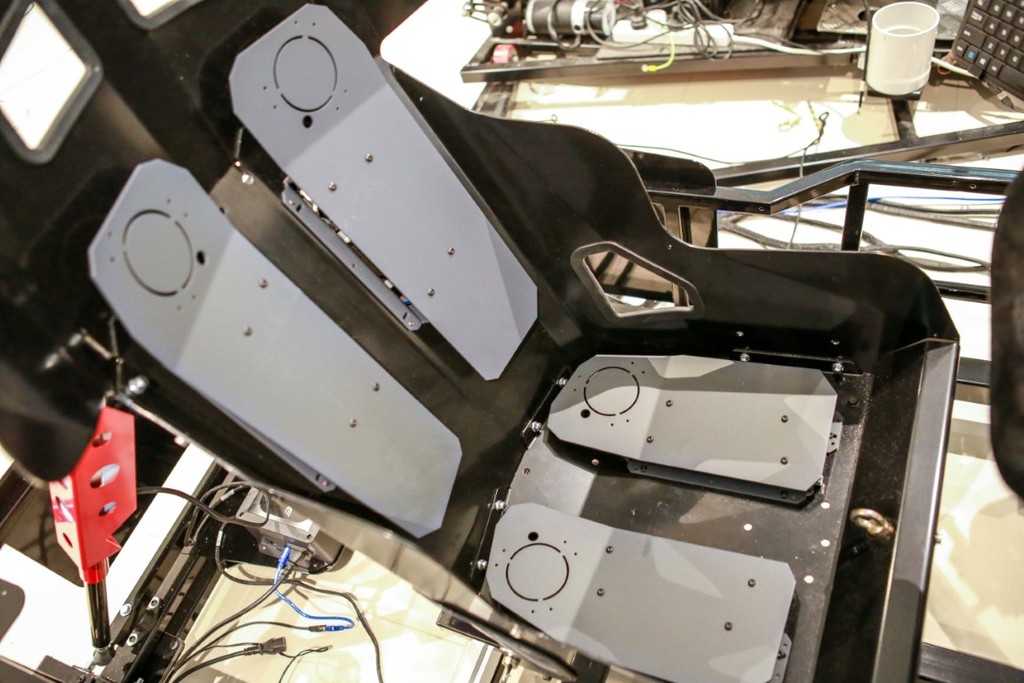

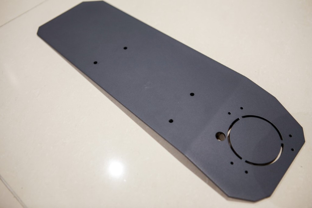

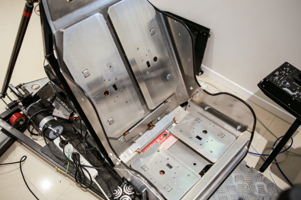

    5. Panels
    The panels have changed a lot since the GS-4, they are now longer and are curved so they make much better contact with your back and legs. Because of this it doesn't feel like you are sitting on panels like it did with the GS-4, it feels just like a standard seat. A little know feature of the GS-4 was that it had mounting holes for 4 Dayton bass shaker pucks. The GS-5 also has these mounting holes. If anyone is keen on seeing some of these installed on the GS-5 then I will buy a set and do a little review slash how to guide.
    This is what you have all come for, the first shot of the GS-5 naked. R18 NSFW :)
    The mounts for the Dayton bass shaker pucks, who wants to see me install a set?
    The panels are now curved to match the contours of the seat and your back now
    Compared to the flat panels of the GS-4

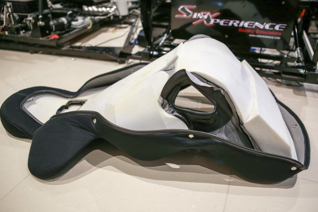

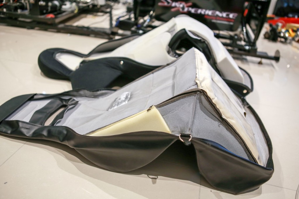

    9. The comfort
    I'm not going to lie, the old GS-4 was probably one of the most uncomfortable seats that I have used, but the GS-5 is the complete opposite, it is by far the most comfortable race seat I have ever used, like seriously, I have done 4-hour stints in it and it feels comfy as. The GS-4 literally had no padding at all, where the GS-5 has a ton of padding and it has this nice moulded leg support in between your legs, so your legs sort of fit in to these grooves. It is a slight bit wider than the GS-4. I have sort of also been luckily in that I have been able to test out the GS-5 at a whole range of body sizes. Back when I was using my GS-4 I was 167kg (370lb) which was pushing it for the GS-4, by the time I got my GS-5 I was down to 144kg (320lb) And I could fit nicely in to the GS-5, I continued to test it down to my current weight of 99kg (218lb) and it still feels comfy as, not too roomy, if I put my hands on my hips then they would be touching the side supports. I only have another 14kg (30lb) to go until I am at my target weight, so I will keep reporting in to let you know how the comfort is. That's the kind of quality testing I do, losing 68kg (150lb) just so I can test the seat at different body types for you guys :) :) :)
    The increased padding in the GS-5 cover, you can see the really large legs and bum support section.
    Compared the the GS-4 which had no padding, it is just racing on a cloud :)
    There are the legs supports from the top. I never thought I needed them but it makes it so
    comfortable.

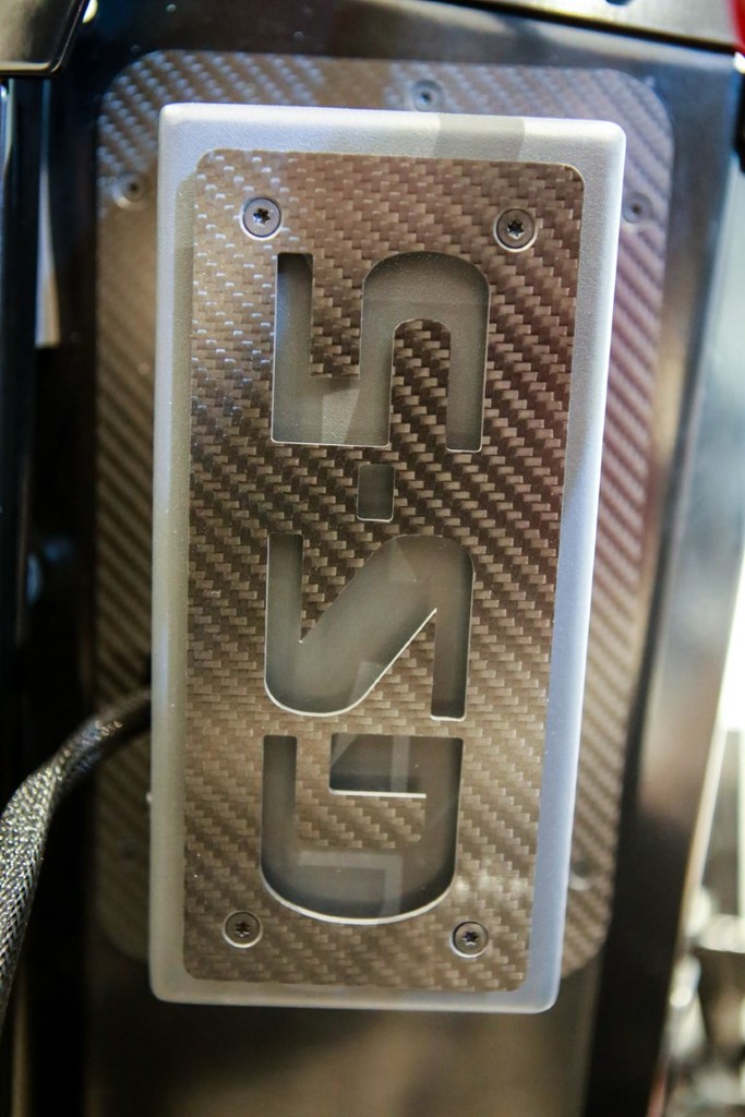

    14. Looks
    I just love the looks of the GS-5. With that murdered out black look, and the carbon fibre GS-5 panels on the back of the motor pods, it is one sexy looking seat. The GS-4 had a very industrial, almost DIY look to it, where the GS-5 looks polished and professional. It is a physically larger seat, due to the bigger headrest and shoulder supports so it does look more impressive on your rig.
    Some shots of the new motor pods
    And the beautiful carbon fibre GS-5 logo

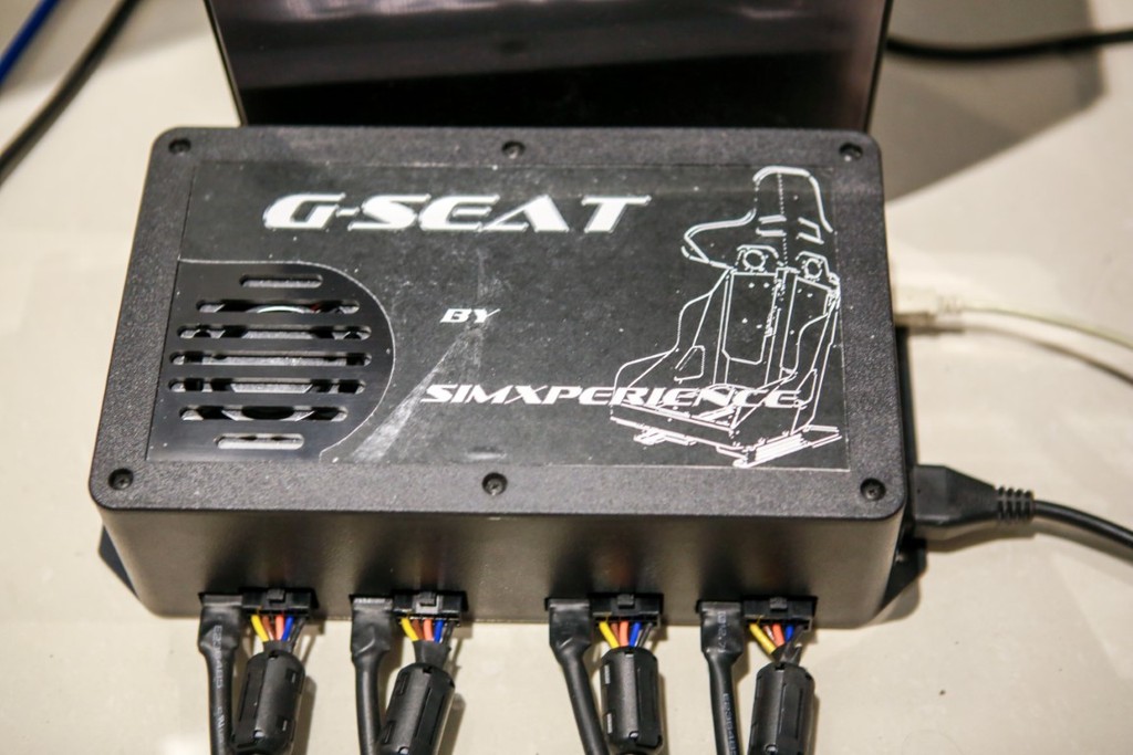

    15. Controller box
    With the GS-5 they have switched to a separate controller box, it is the same size and layout as SimXperience use for the SX-4000 on their motion rigs and the AF V1/V2, which is good because they are all the same mounting holes. At the moment I have it just sitting beside my Stage 4, I have the floor boards for the Stage 4 coming next week, so I will mount it to that when it arrives. There is plenty of cable length, so you can mount the controller box where you have room on your rig

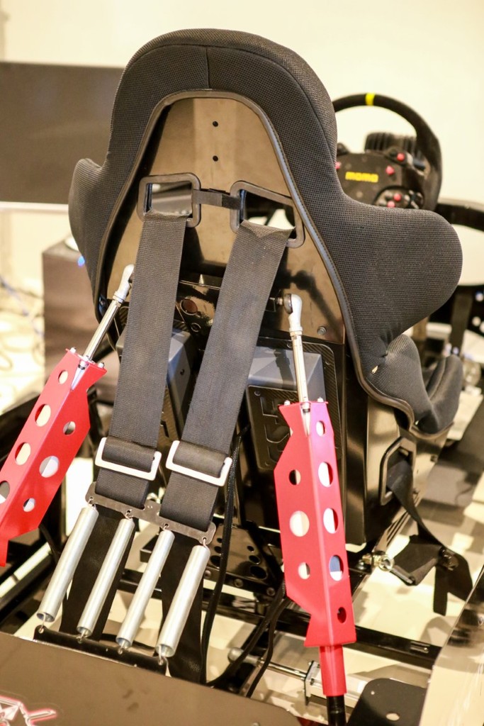

    17. Harnesses
    One recommendation that I feel enhances the GS-5 is to install a set of harnesses, they really pin you down to the seat, so you feel the pressure of the panels squeezing you against the belts just that little bit more.
    I use a little seat belt tensioning system, but if you have a static rig then you can just hard mount them.
