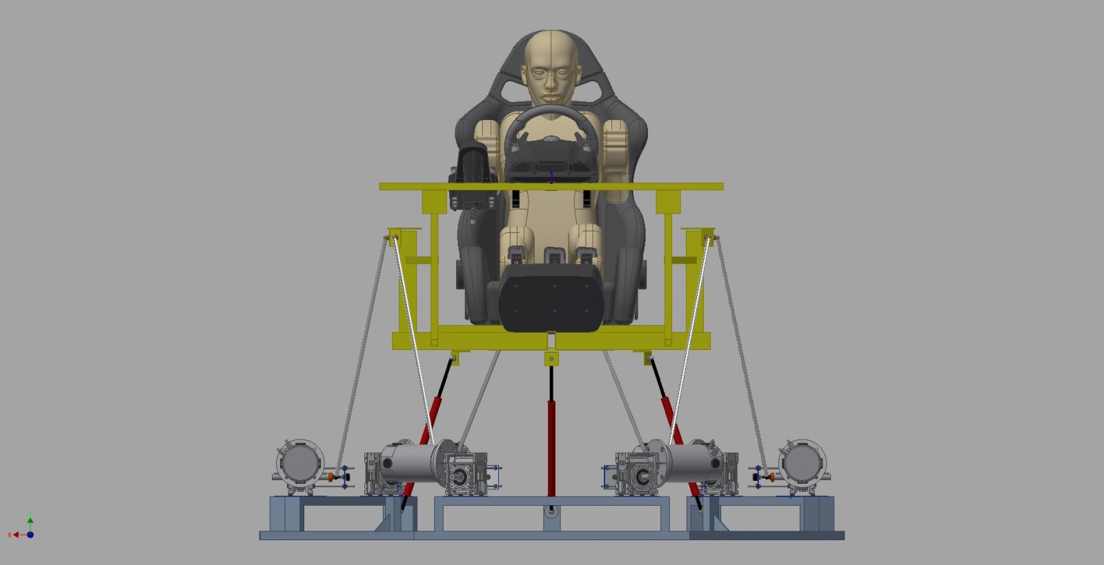

    Hello!
    As the DIY motion-sim topic, which I just recently discovered, turned out to be so addictive that there is no longer any spare time on weekends for anything except cutting, grinding and welding metal tubes, I am opening this thread to share my progress in building a 6DOF rig.
    I do not have any experience in this, but with a wealth of great advice available on this forum I hope that I will not make too many serious mistakes in the process.
    The idea is as follows: this will be a Stewart platform with 24V 500W DC motors, IBT-2 drivers and arduinos. It will be VR oriented with Rift CV1 for display.

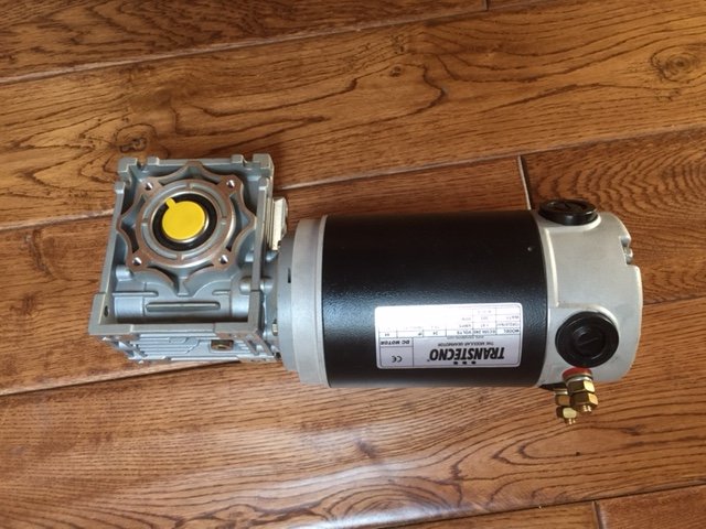

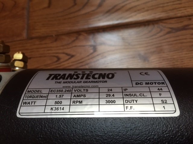

    1) Six Transtecno motors (350W nominal / 500W short peak for short periods). Nominal torque (S1 as the manufacturer calls this mode) is 1.12 Nm, peak torque S2 is 1.57 Nm.

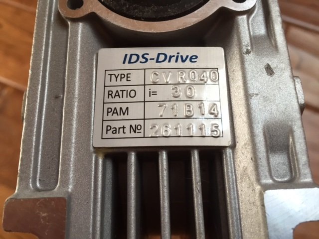

    2) The gearboxes are 30:1 with resulting torque between 33.6 and 47.1 Nm:

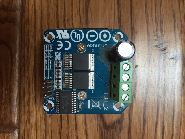

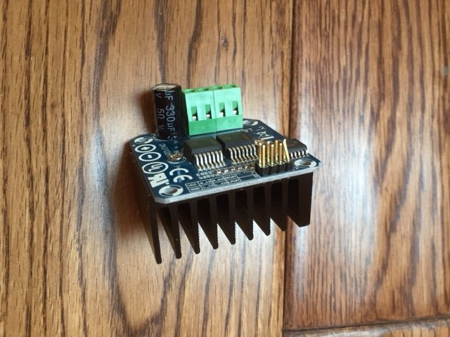

    11) Six IBT-2 43A motor drivers

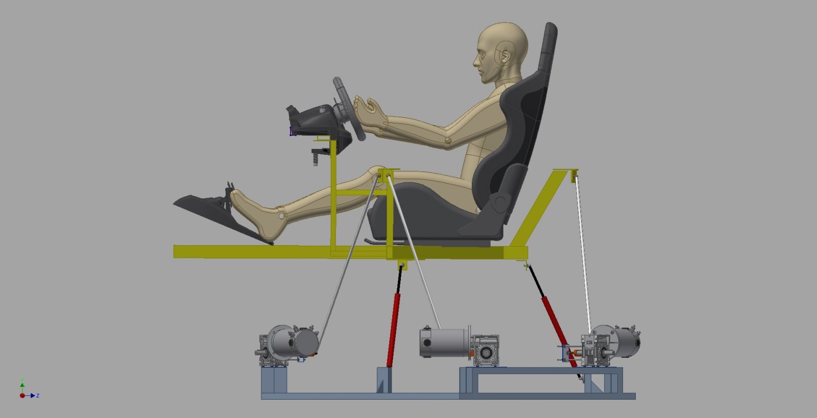

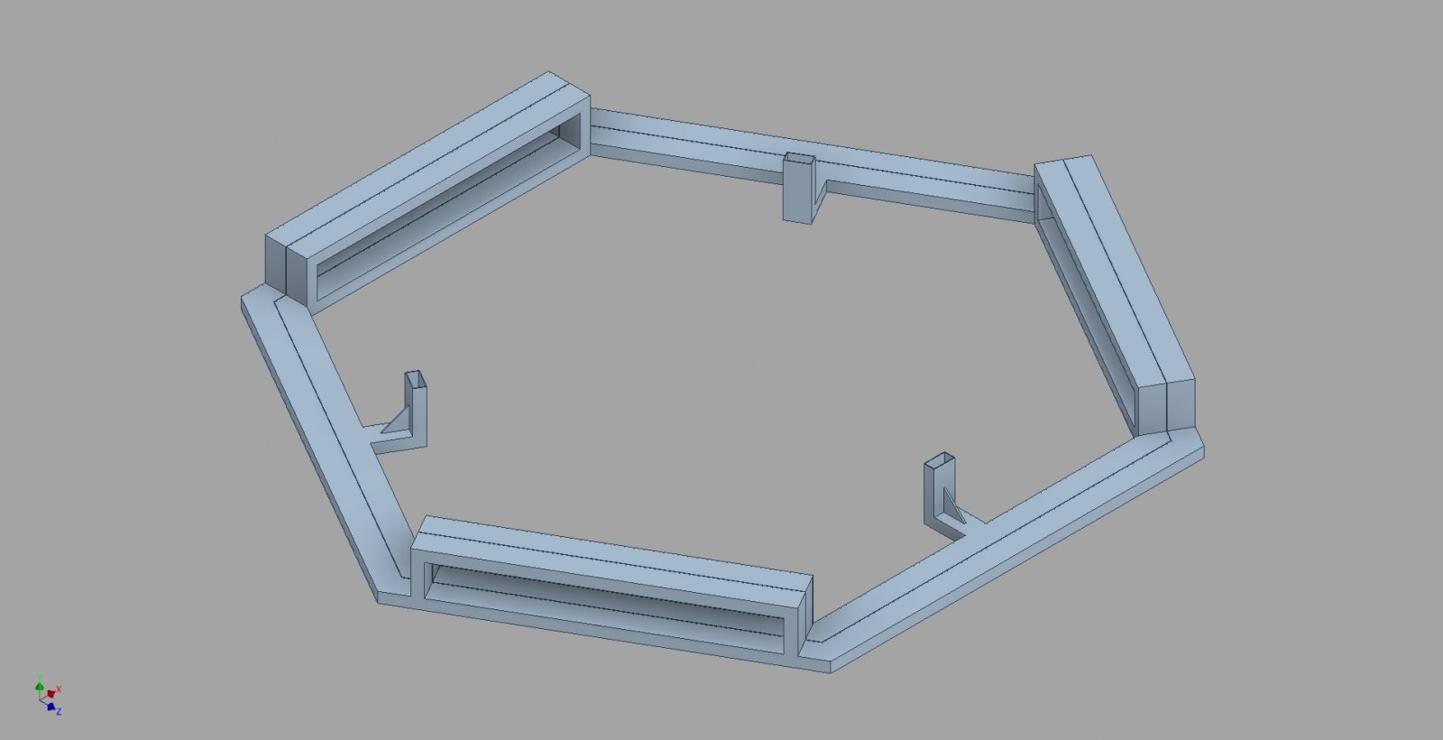

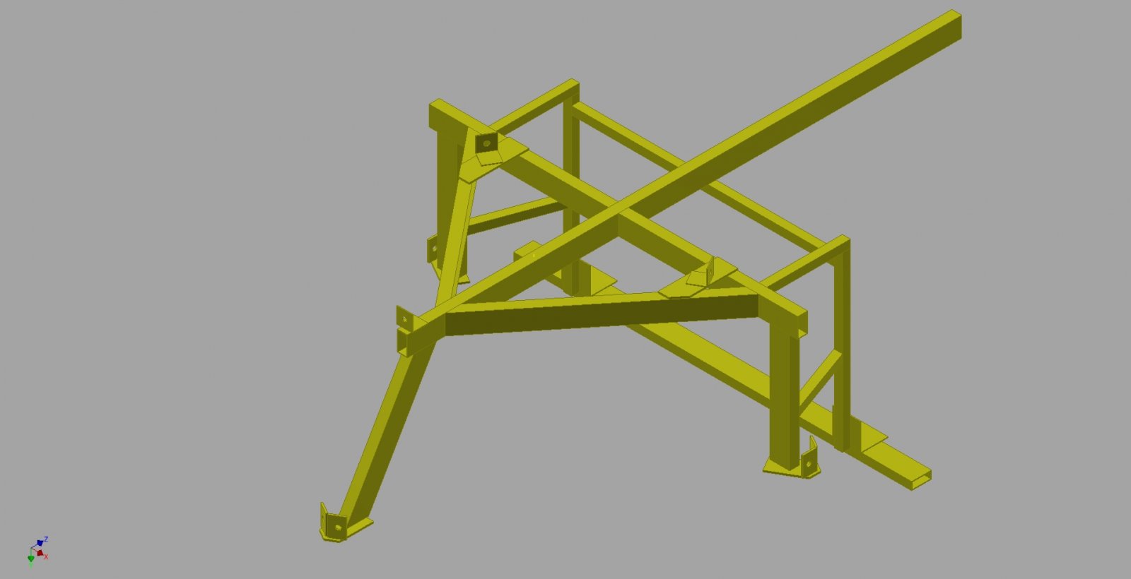

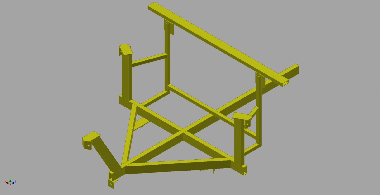

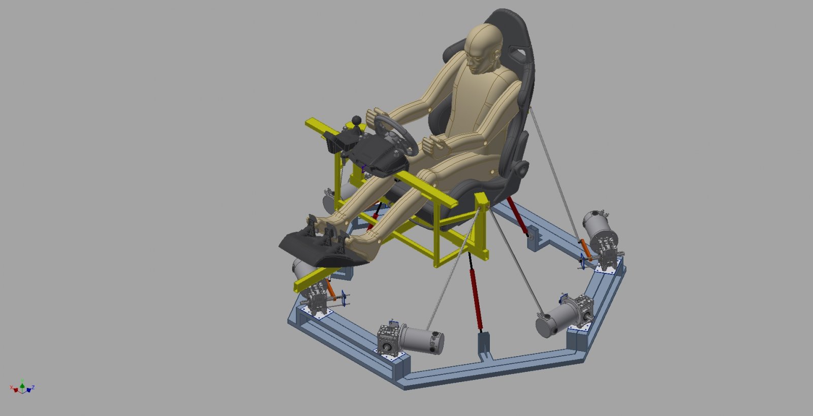

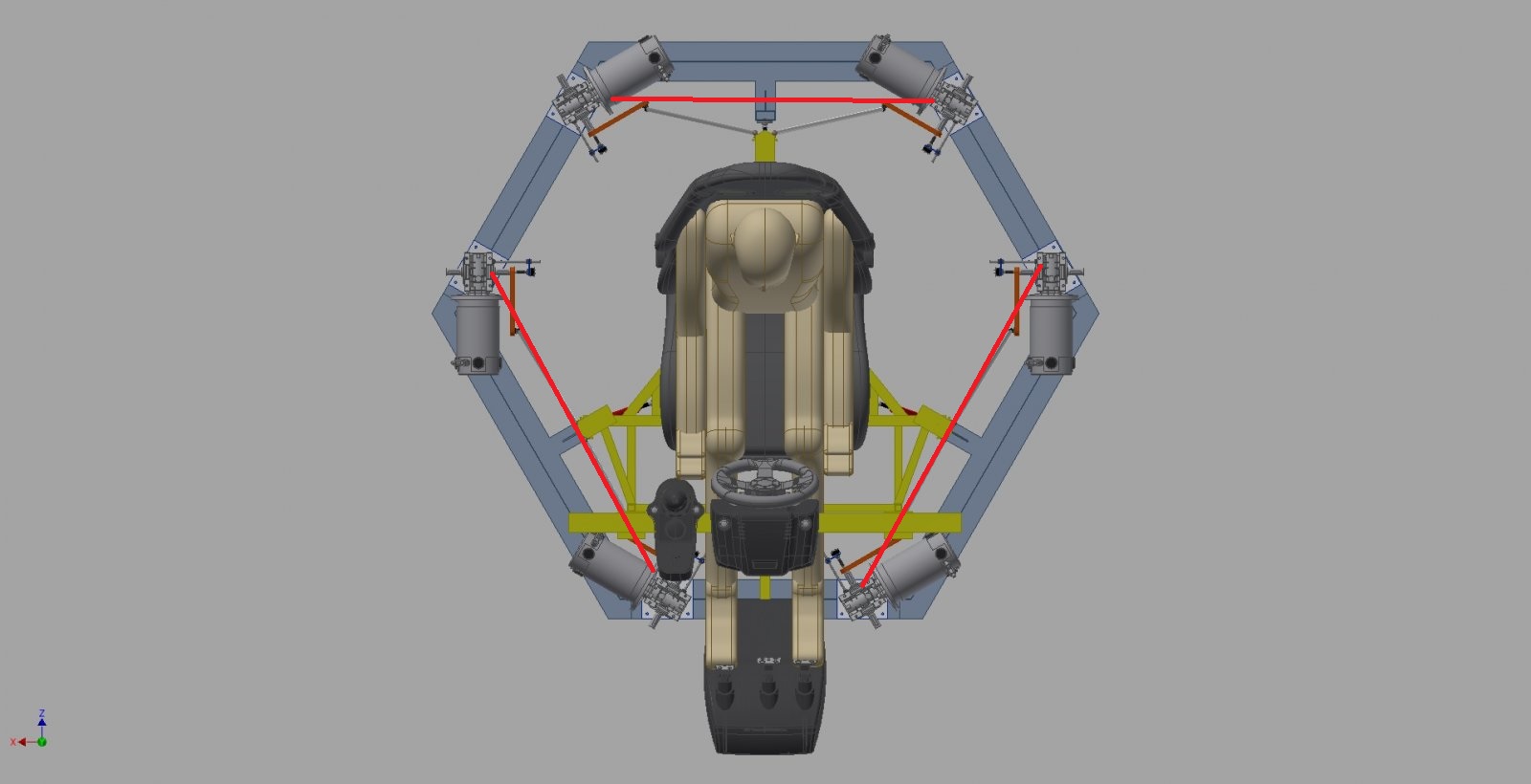

    The whole rig would look like this:
    base.jpg frame left.jpg frame top right 1.jpg frame top right 2.jpg frame upside down.jpg

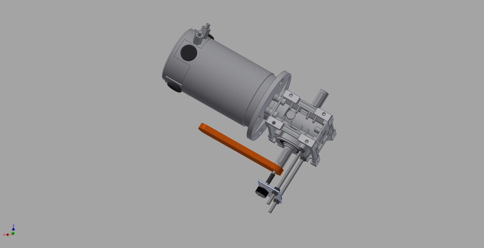

    Position sensors will be mounted like this, with tight rubber tubes serving as shaft couplers:

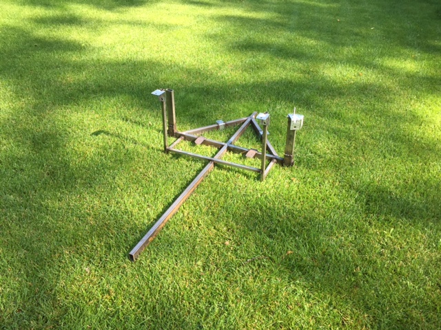

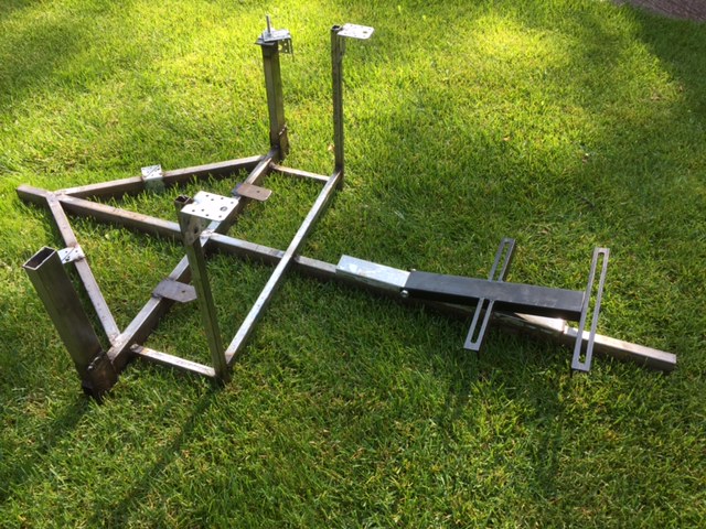

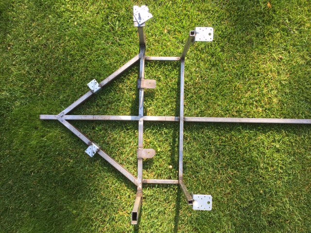

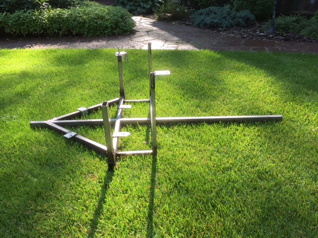

    Some of this has materialized already:
    IMG_3437 - копия.JPG IMG_3438 - копия.JPG IMG_3440 - копия.JPG IMG_3452 - копия.JPG IMG_3453 - копия.JPG IMG_3454 - копия.JPG

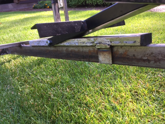

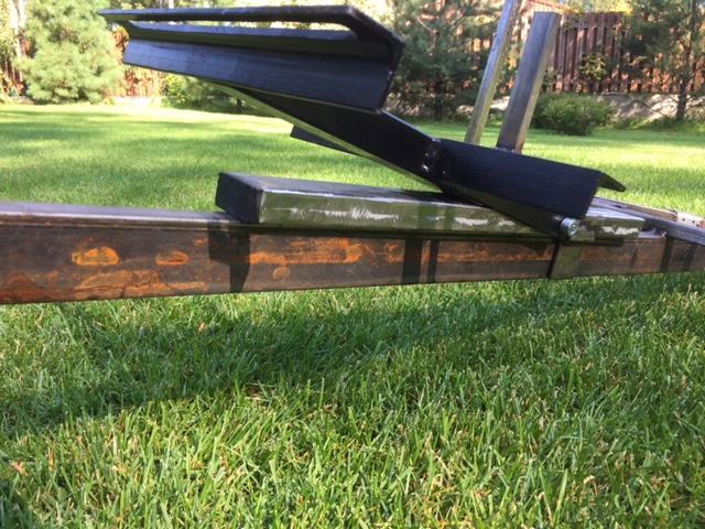

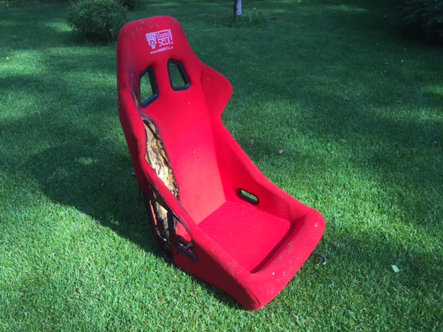

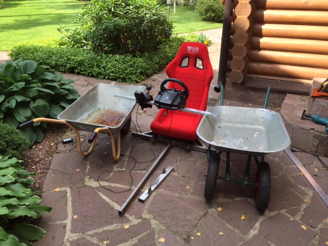

    The initial plan was to use the seat from simplistic static driving rig I already had, but after a successful experiment to prove that making welding corrections without removing the seat first is a bad idea I will probably need to get another one :)

    Excellent start!! :thumbs

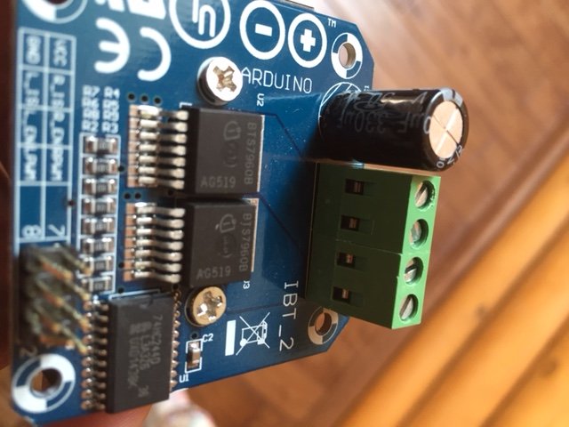

    I'd say that the Hbridge may be too weak to absorb peaks of current. H-bridge is "only" 50% above rated current
    motor 29A nominal
    Hbridge Maximum Current : 43A
    :D indeed!
    Be aware that a bug can lead to a lever full turn, breaking your pot mounts...

    Thanks!
    The drivers support 60A for 10ms, so I hope they will manage.
    True. I intend to initially place them on the other side of the motor shaft and only move them inside once everything is tested.

    I have a slight suspicion this seat was not approved for real racing use. :p
  5. Grigory
    Grigory Active Member Gold Contributor
    Jul 6, 2016
    202
    Moscow
    218Coins
    +305 / 1 / -0
    3DOF, 6DOF
    That's plausible :) It took it about 30 seconds to get to this condition before I got back with a water hose

    BTS7960 ICs used in these drivers have built-in current limiting. I am wondering if that would help.

  11. RacingMat
    2,237
    21,020Coins
    Mind that these are "cheap" Hbridges
    Industrial solutions are much more expensive ;)
    You can add some quick fuses @40A to prevent some smoking episodes...

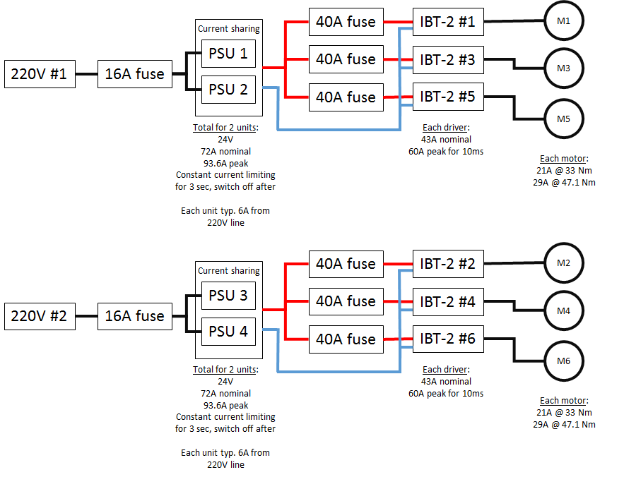

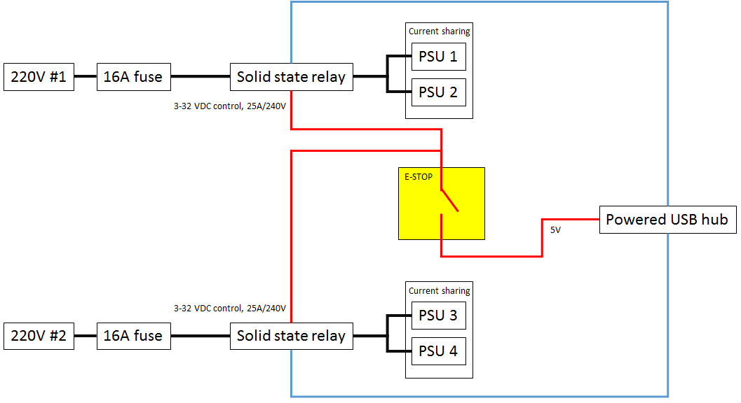

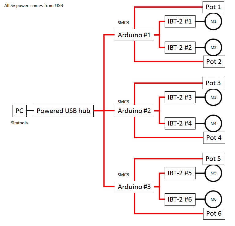

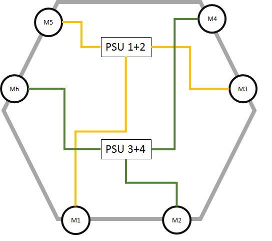

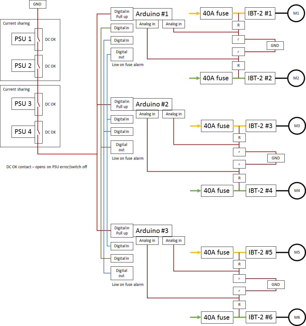

    Here is how I plan to wire everything:
    As there will be two power supplies each serving three motors, I think it makes sense to have each power supply take just one motor from each triangle side. I believe this should decrease chances that all three connected motors have current peak at the same time:
    I would certainly need two separate 220V circuits with 16A fuses. As recommended by @RacingMat, I will also put 40A fuses before IBT-2's:
    I want to have a safety mechanism to make sure that the whole rig stops if any motor loses power. Using "DC OK" contacts on SDR-960-24 PSU's to see if any of the PSU's stopped providing 24V and reading voltage after 40A fuses to see if any of those fuses was blown should do the task. Arduinos will halt the motors if there is any alarm:
    Logical connections will be as follows:
    Does it all look viable?

    E-stop will be wired like this:
  14. RacingMat
    2,237
    21,020Coins
    Good idea to use PSU "DC OK" contacts in serie!

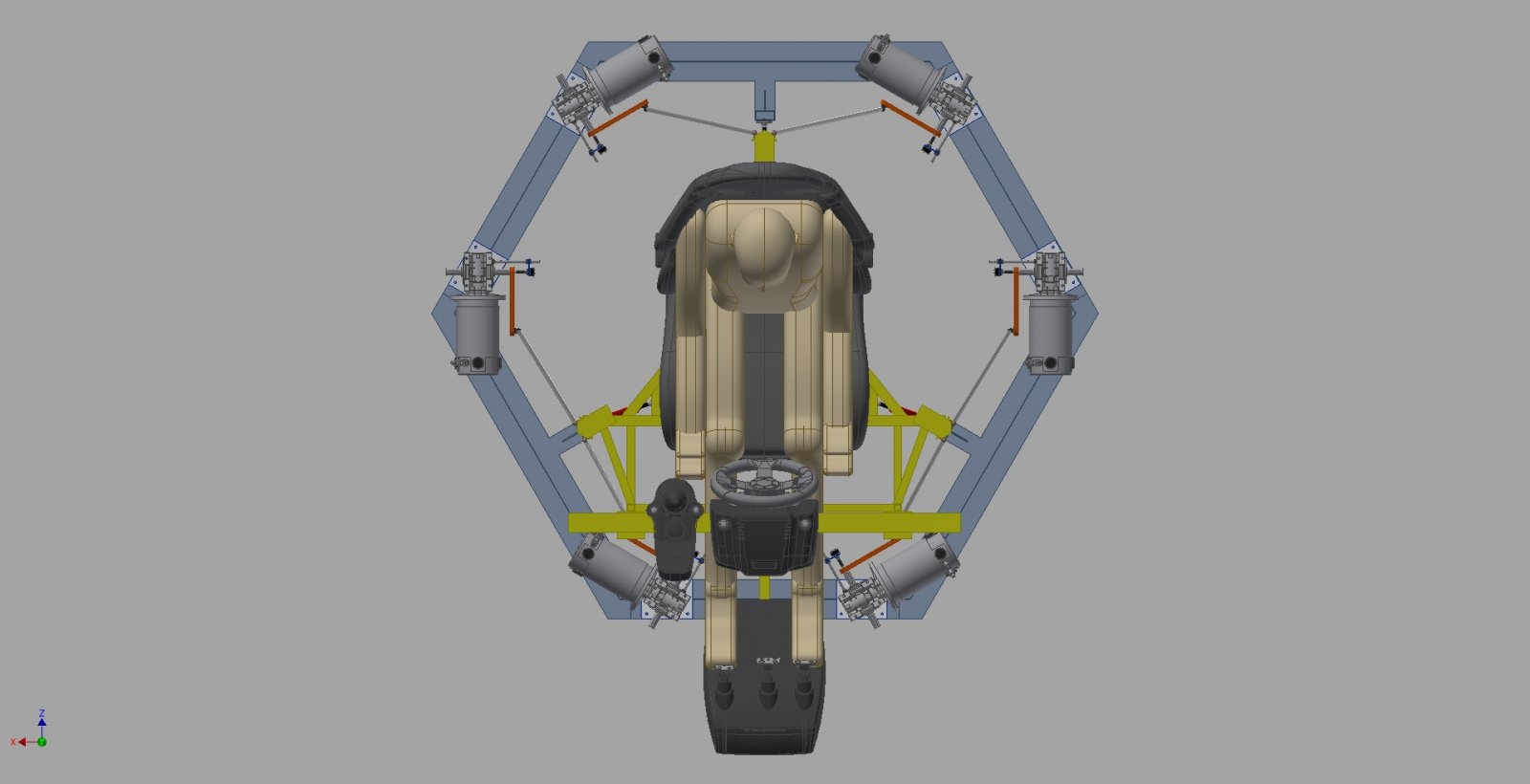

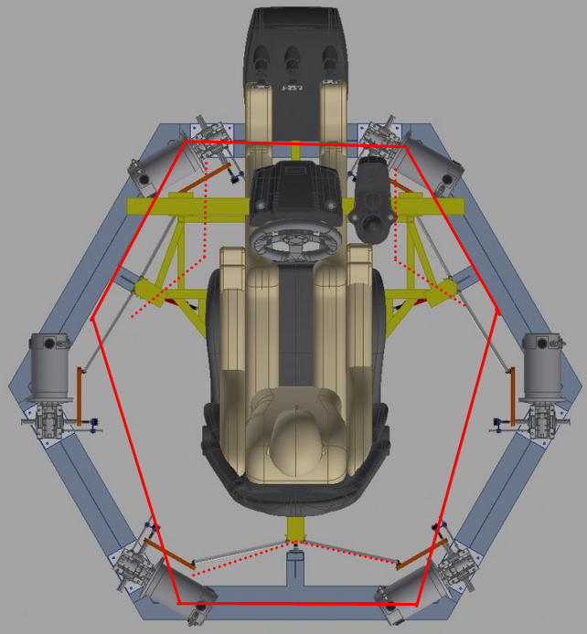

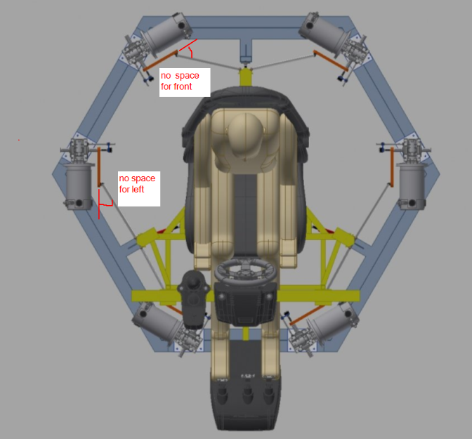

    Hi Grigory, Very wonderful design, give me a lot of inspiration.
    I'm working on my 6DOF rig also, but I have no weld tool, so I need find someone help me to weld the metal tubes, but I don't know how to use AUTOCAD, so I still have many doubts about the detailed dimension.
    Now I'm making my V2 wooden prototype to find the dimension. It's a clumsy method, looks it's not inoperative.
    Your sharing give me a lot of inspiration, but I have a question about your motor location, the rod ends have angle limited. I think there is no enough space. Maybe I'm wrong, do you have some special considering for the motor angle?

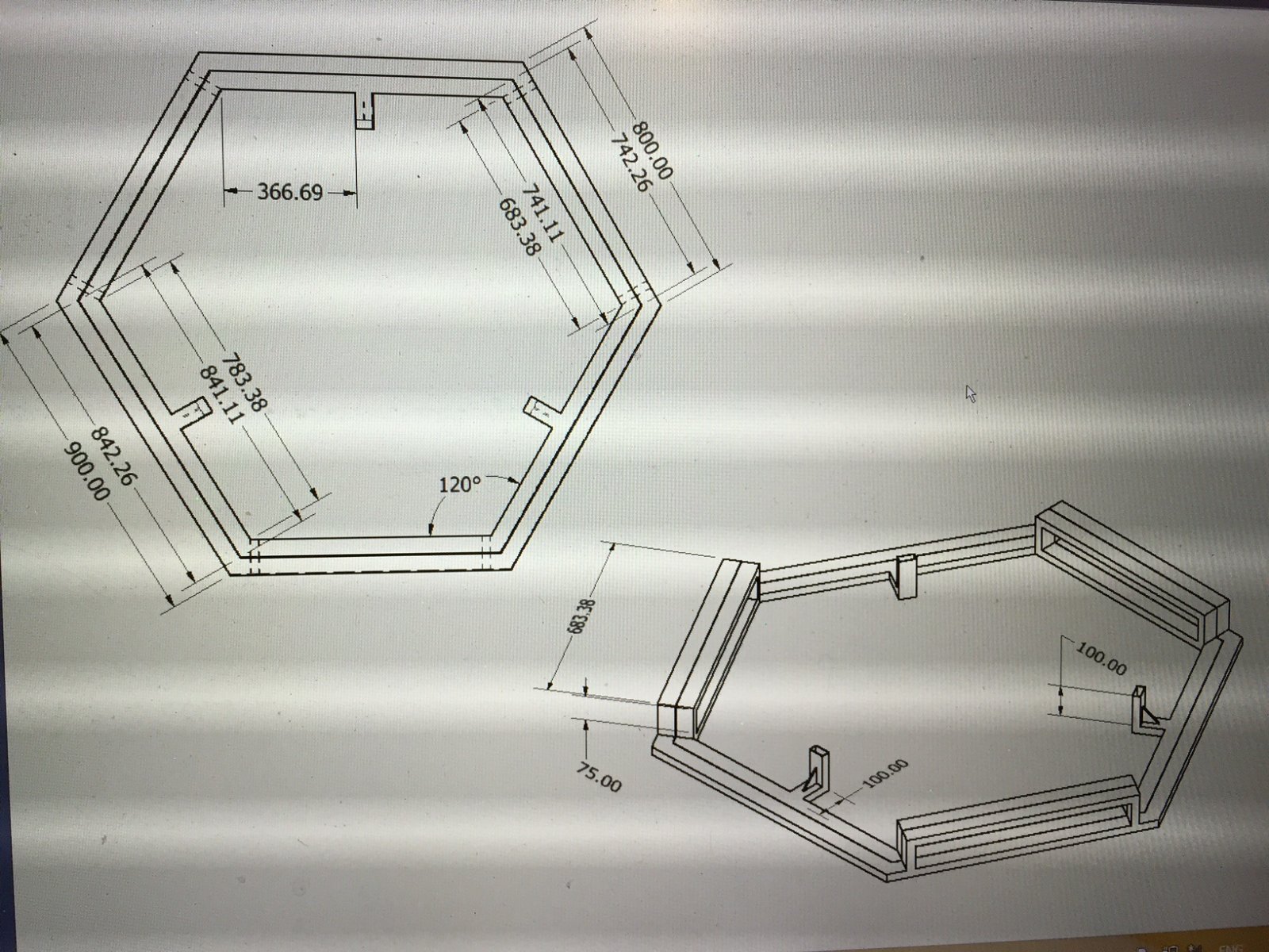

  16. Racing Mike
    Racing Mike Member
    Apr 24, 2016
    99
    Chile
    348Coins
    +34 / 0 / -0
    my prototype, as I checked the base will be Non-equilateral hexagons. like below :
    if use equilateral hexagons base, the length of side need be longer, occupy more space.
    my current length is about 600mm, how about yours?
  17. Grigory
    Jul 6, 2016
    202
    Moscow
    218Coins
    +305 / 1 / -0
    3DOF, 6DOF
    Hi Mike,

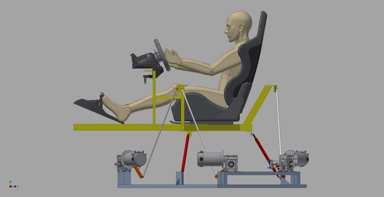

    I am not sure I understood the problem. My rod ends have 45° of angle range: 22.5° each way from neutral. As rotation around the attachment bolt is unlimited, I tried to make the plane of motor shaft lever parallel to the attachment plane on the moving platform. It seems to me that this way I will use that unlimited DOF more and the ones with 22.5° limitation a bit less.
    On the top view it seems like the rods are far from neutral angle, but it fact they are not:
    I do not have issues with movement when running simulation, but in any case I will be able to rotate/re-positiont the motors when testing the actual assembled rig.

    Here is is:

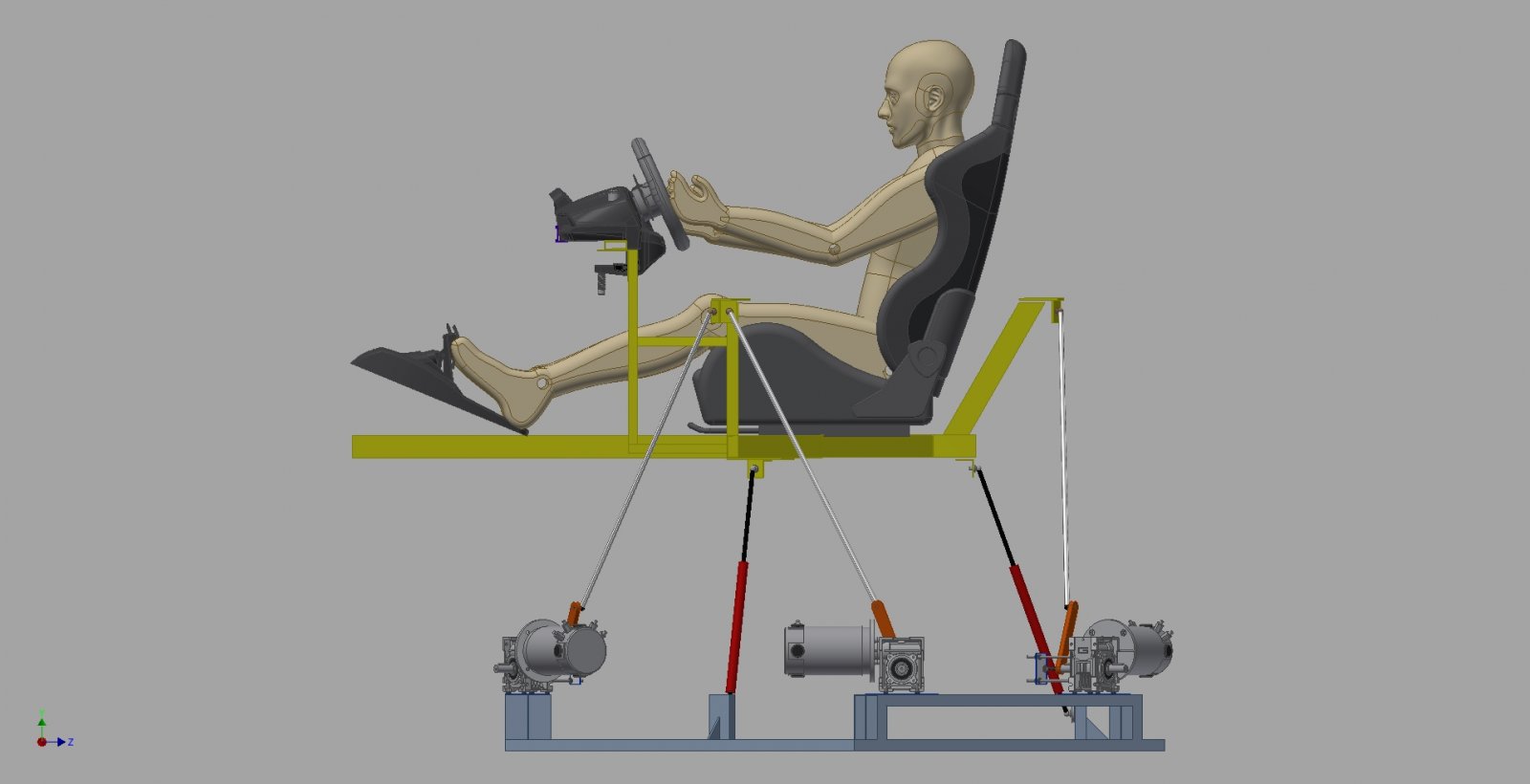

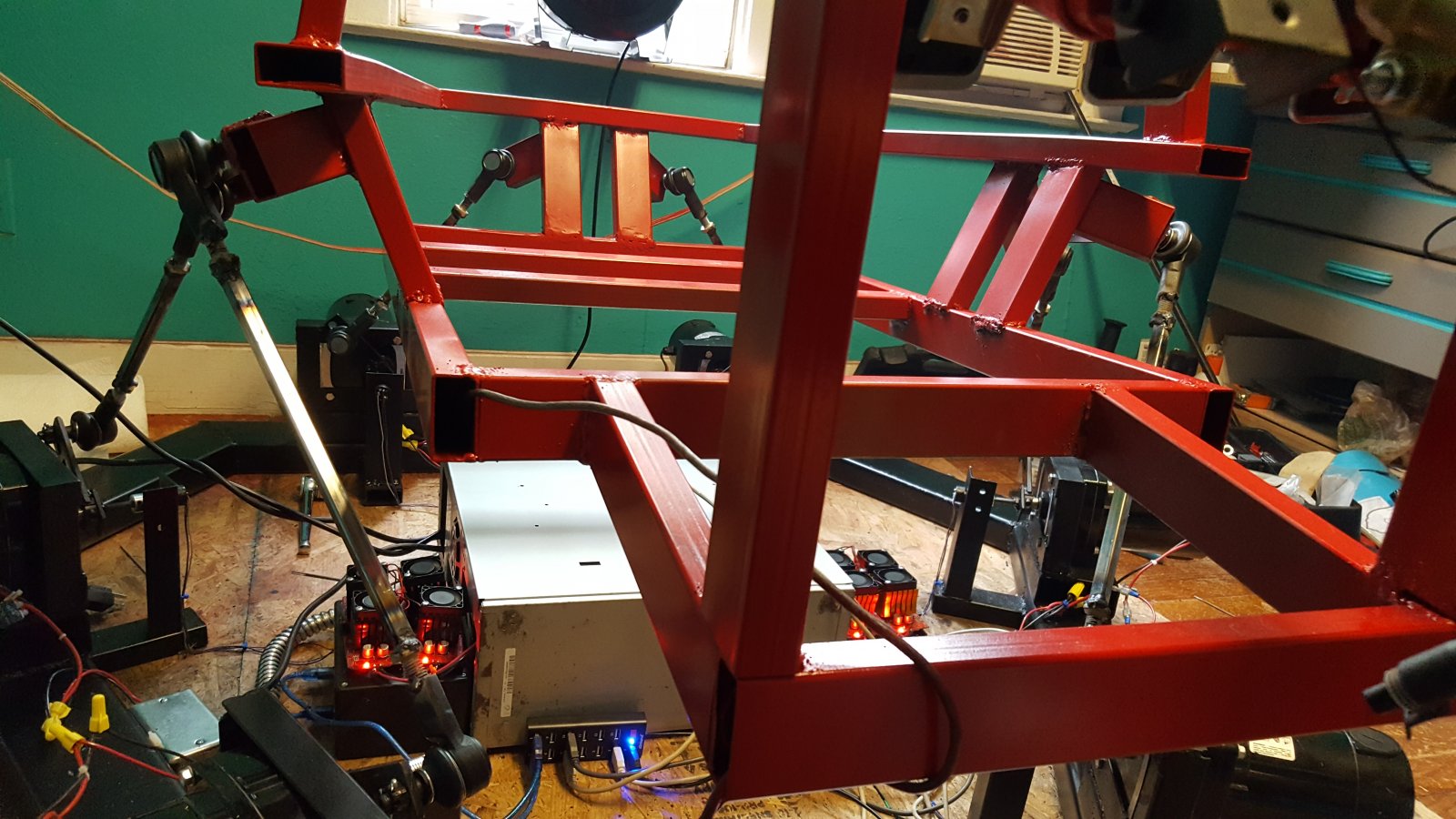

  19. bruce stephen
    Jun 7, 2015
    1,286
    general contractor
    michigan
    9,114Coins
    +1,243 / 9 / -0
    First let me say nice work so far. One possible issue i see is the mounted angle of the motors, in relation to the cockpit, appears to be putting an awful large amount of lateral force on the rods and motors. I suggest turning your motors so the rods/levers line up with the lines I have added. I believe this will reduce stress on your equipment as well as taking advantage of the direction of travel.
    I would also suggest rotating the levers 180 degrees.
    this is may illustrate a little better what i am saying.
  20. Grigory
    Jul 6, 2016
    202
    Moscow
    218Coins
    +305 / 1 / -0
    3DOF, 6DOF
    Thanks. Indeed, I just did not think about this. I certainly do not want to put too much pressure on the lock rings on the motor shaft.
