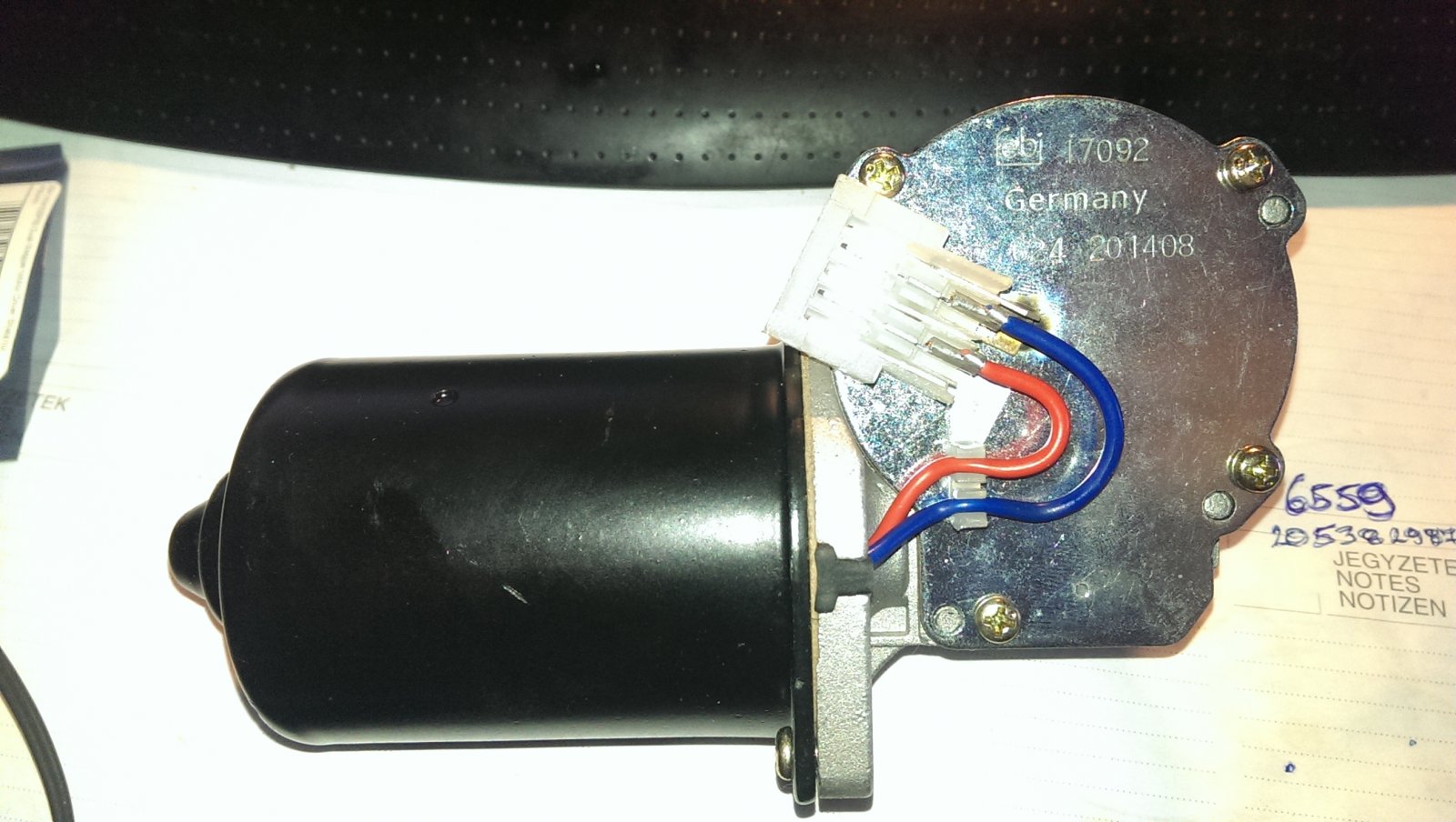

    Got my wiper motors from a local car parts shop, its a VW wiper motor made by Febi, the two brand new with 1 year warranty were about 40EUR.

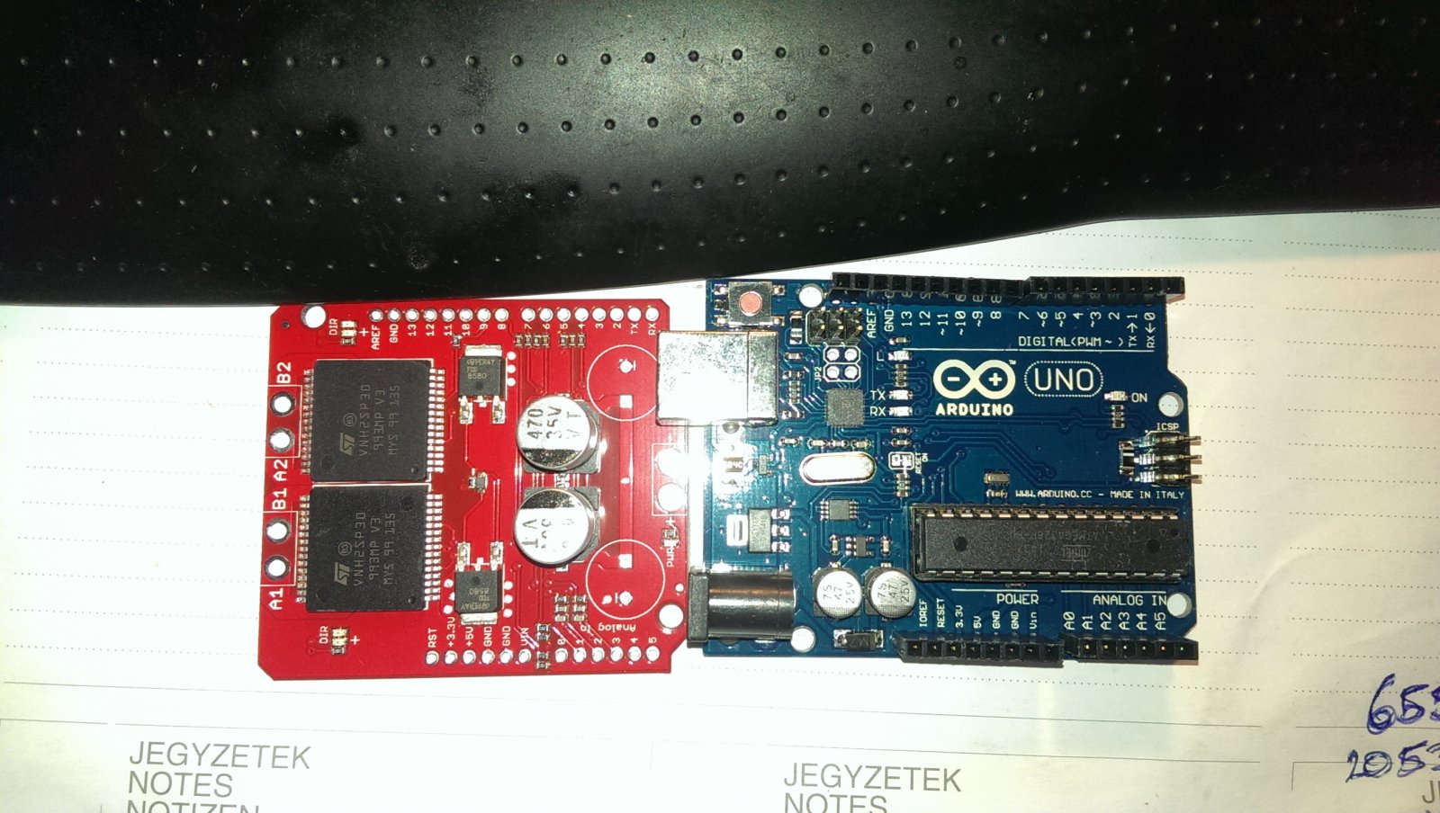

    Got an Ardunio from UK:
    http://www.ebay.co.uk/sch/i.html?_f...E+Arduino+UNO+Rev3+R3+328+ATMEGA328P&_sacat=0
    And a Monster Moto also from UK:
    http://www.ebay.co.uk/sch/i.html?_f...iver+Monster+Moto+Shield+for+Arduino&_sacat=0

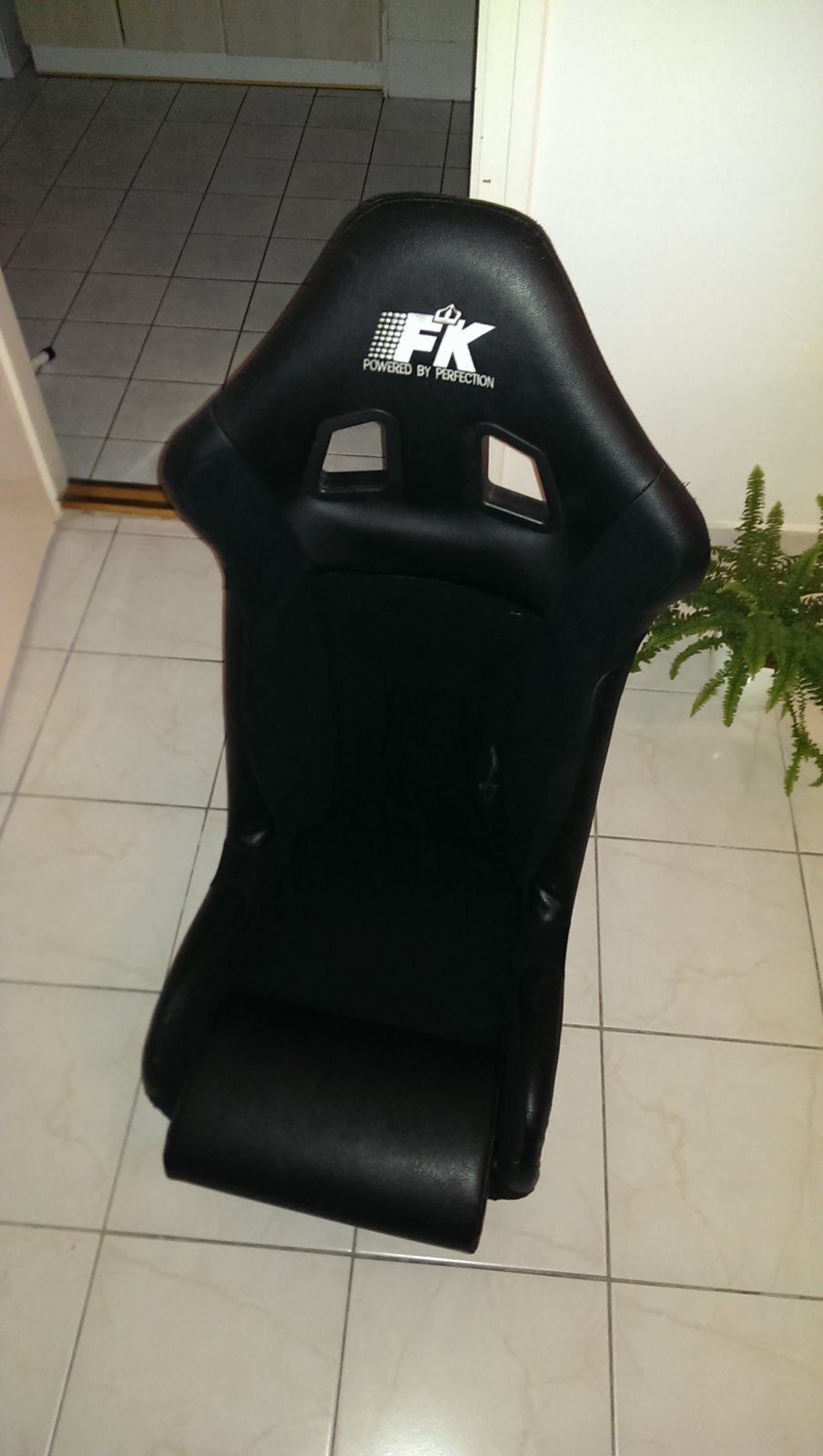

    Got a used racing seat for about 50EUR.
    Rest of the photos coming later :)

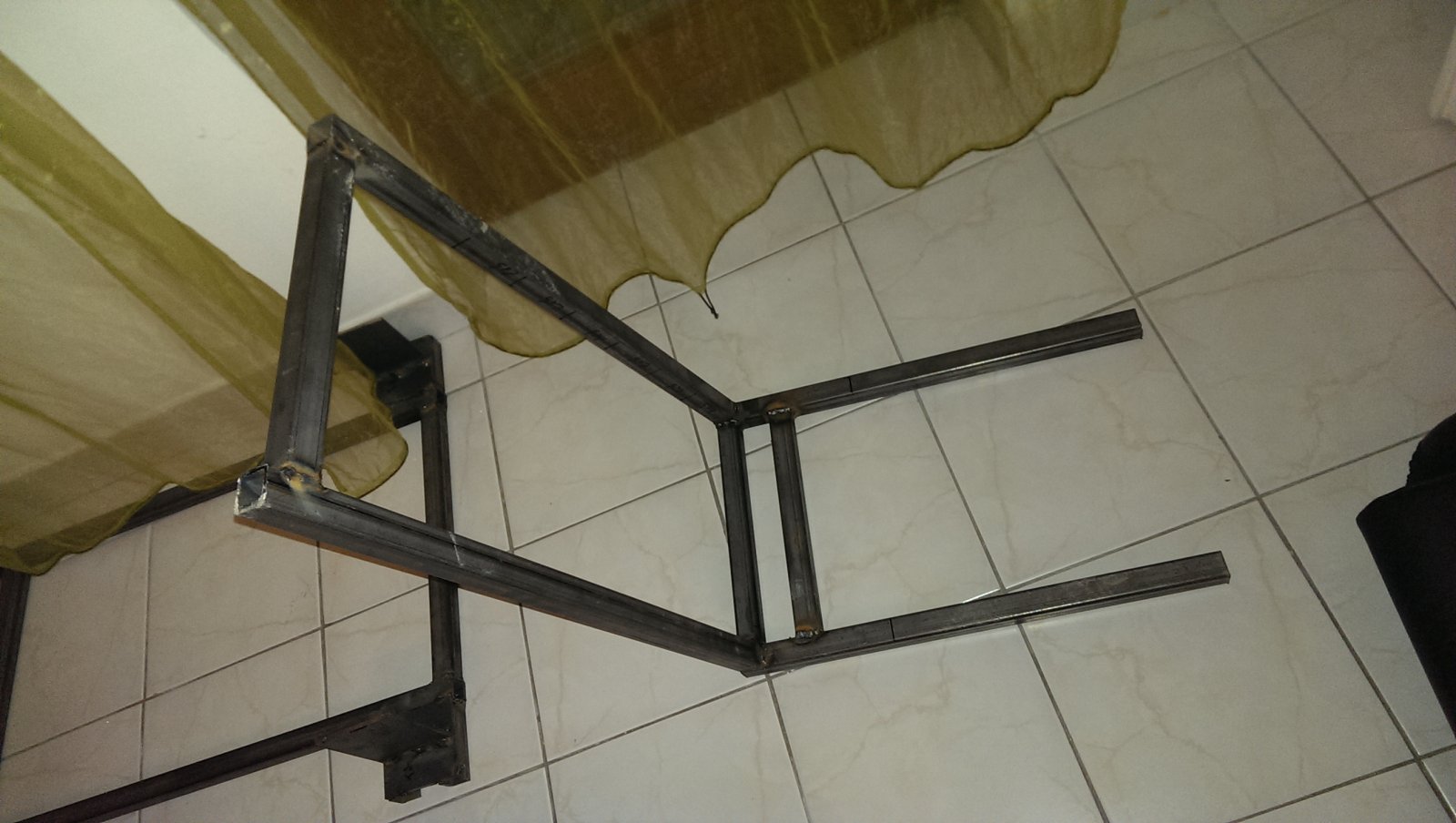

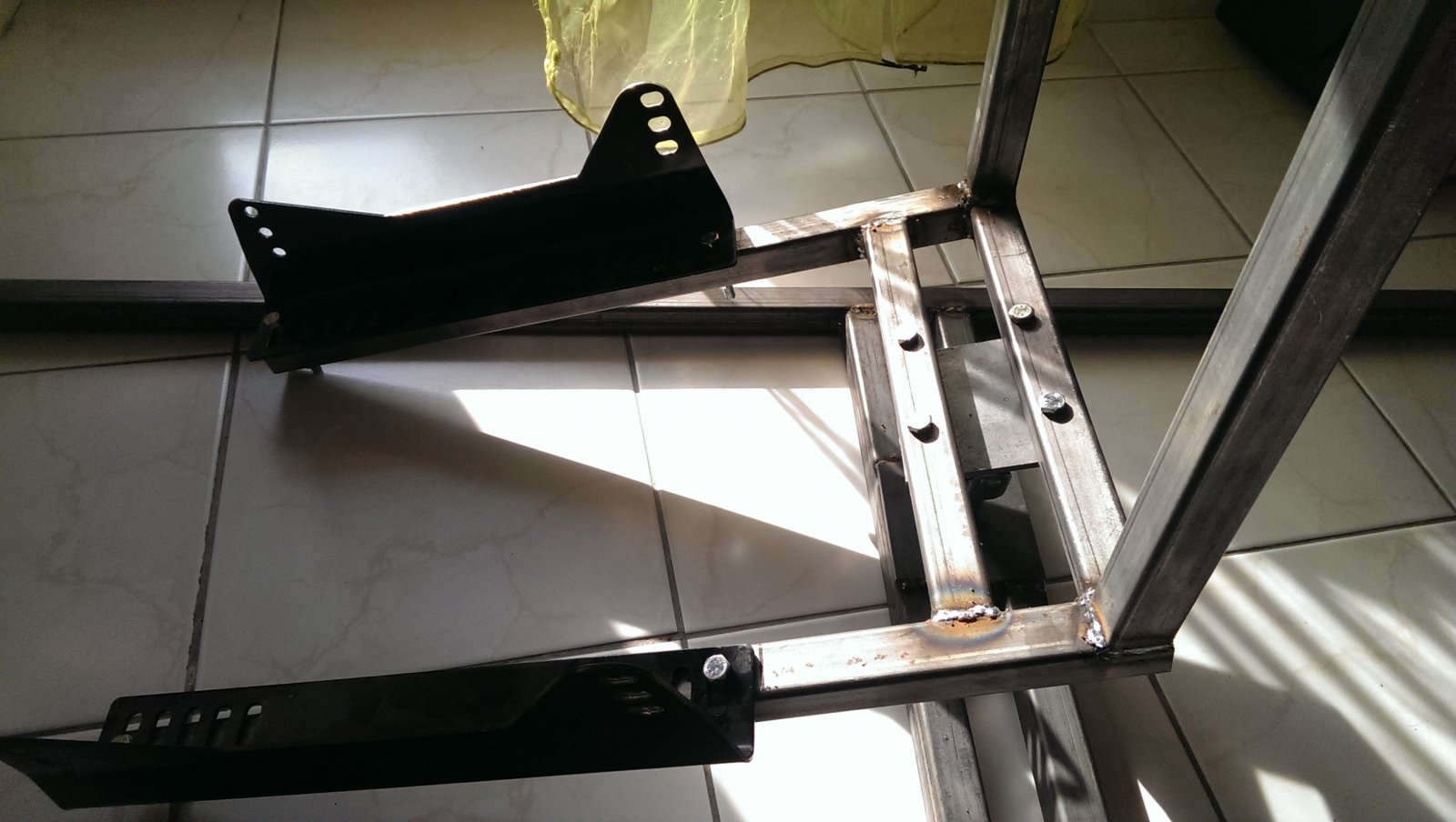

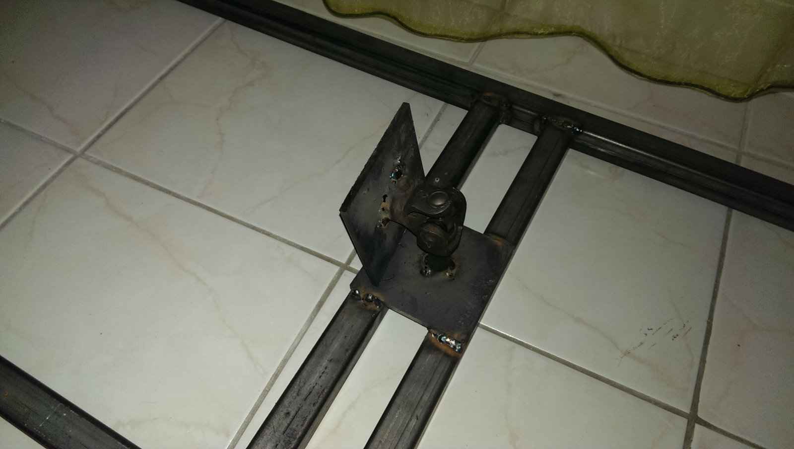

    The joint that will keep the seat is from a scrapyard, I was told it was a steering extension rod for some car. Gave about 10 EUR for it.

    Nothing wrong with farming bits out where needed. Some electrical work is inevitable with a sim, but it is pretty straight forward and at least 12V is safe.
    Th steering uni joint will be fine, just make sure it is welded securely as it takes some punishment in actual use.

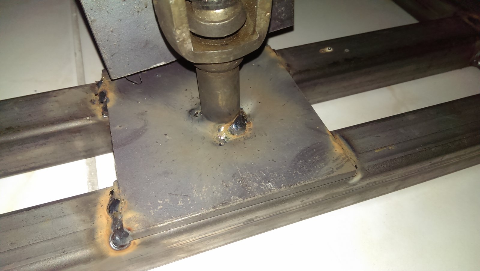

    Do you recon I should get additional welds for the joint?
    I rather not have my ass drilled through by a join while racing heavily :)
    21,506
    150,656Coins
    +11,018 / 55 / -2
    The photo is not really clear but on the base of the post facing the viewer it did not look like it had been welded all the way around, though that may just be discoloration and my poor eyesight. Pays to check though.

    No, do not turn on the photo apparently Welding, board to see 4 small brackets over each dimension for better support.

    You were right guys, welds look a bit weak...

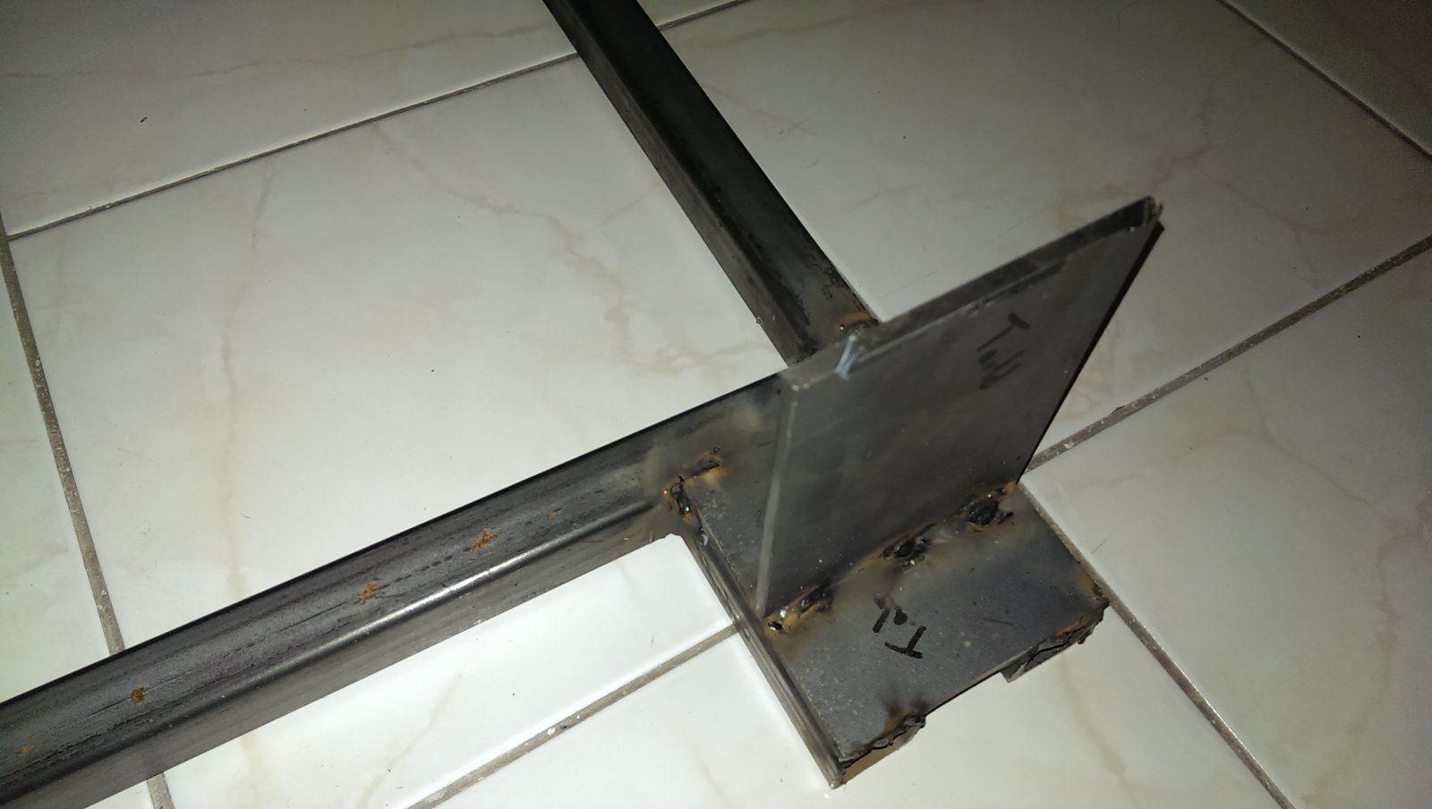

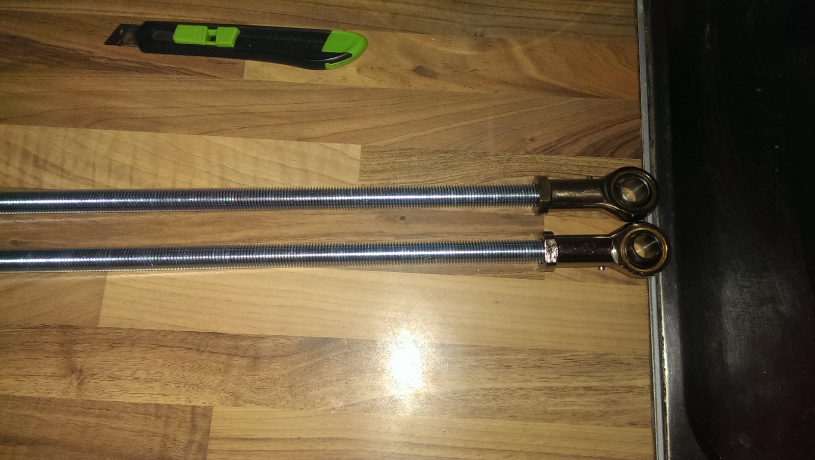

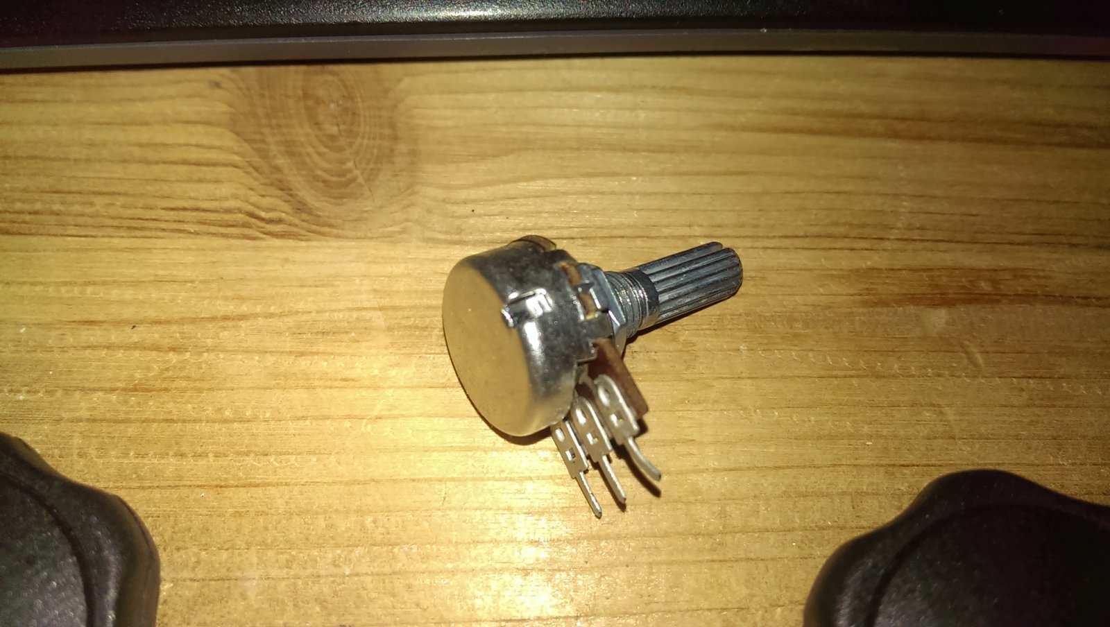

    Managed to get my ball joints and the 1 meter long treaded rod, tomorrow we are preparing the electrical connection with the two 10K Ohm potmeter which can take up to 0,4 W. Hope it will last! IMAG0177.jpg IMAG0179.jpg

    From the close up at least to my eye welds look strong enough.
    Are those pots cermet pots?

    I'am only concerned about the extension rod weld, the other seem fine to me too.
    Unfortunately they are not cement ones, those had a cost arount 10 EUR which I felt too much as the motors were 20 EUR, so I got these to test. They are mid level, not the cheapest but not the most expensive... Hopefully they will hold! :)

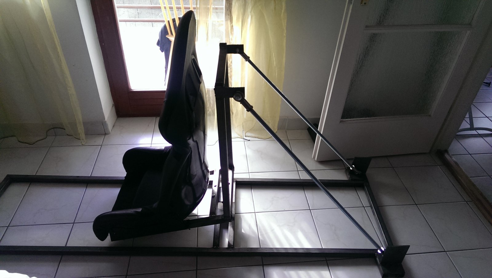

    Well got a little held up by my electritian friend so so electornics for me this weekend... Pretty disappointed, but the again growing up means you have to learn patience!

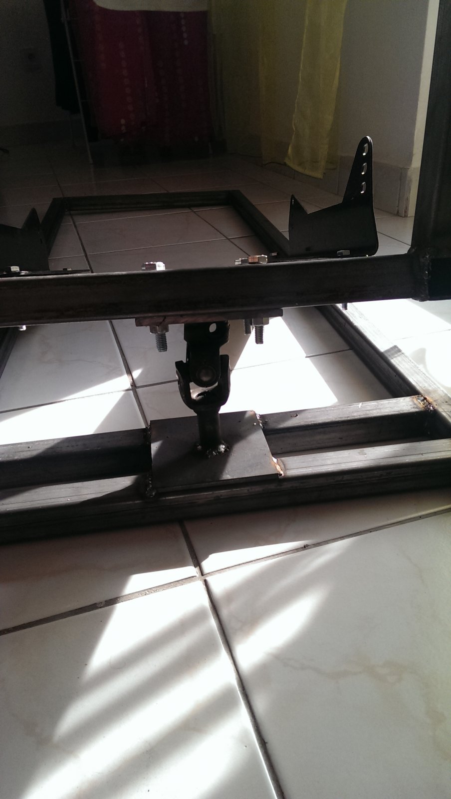

    Until then managed to "learn" how to sharpen a drill bit on a desk grinder using no special tools and have built up the seat to the cage holding it.
    The cage had a bad angle so I have corrected that yesterday with my friend :)
    Hopefully the electornics will be ready on Monday and I can start programing the Arduino!

    How does it balance with the uni joint so far back?

    Not sure, but my though was to have the joint near my weight center (I thought when sitting down that should be near my buttom?!) so that it would be easier for the motor to move me back and fort.
    Is my method wrong?
  19. SeatTime
    2,573
    28,320Coins
    Agree with @noorbeast that won't work very well, the balance point for a seat mover is closer to being under your bottom, not at the back of it. Take the seat part off the rig and sit on it with a round pipe under it, you will soon find the correct balance point/position to affix your uni joint.
