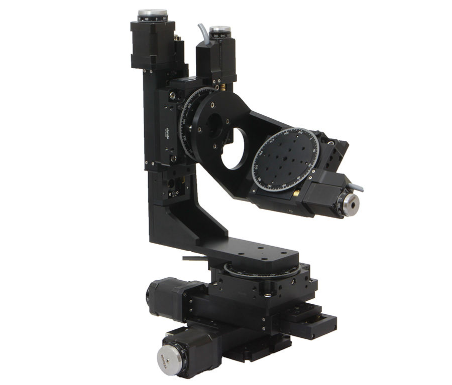

    Hi All,
    My name is Hodeifa, I am from Indonesia. Currently I am still looking around
    of my build concept. My usage plan is for car racing and roller coaster.
    Only from a brief visual observation, currently I am not quite happy with 6-dof
    hexapod build, because I feel it can't give enough rotational movement especially
    for playing roller coaster. But once again this is only from my visual observation.
    After looking forward, I felt 6dof with 6 stage axis seems promising because each
    degree moves independently that can result more movement in each axis.
    Unfortunately I can't find anyone implement 6 stage axis for big load. One way I
    feel it should be an exiting concept but on the other hand has a high risk. Probably
    anyone can share opinion about this.

    Hi @MrHodeifa , what is a 6DOF with 6 stage axis? Maybe a drawing/diagram of what you are planning to build may help members understand and give an opinion.

    Dear All,
    This is the idea taken from a small model. Just need to upscale :o:. 6stageaxis.jpg

    You will need very strong actuators as each one is carrying all of the weight. With a hexapod design the weight is shared.

    Yes, I realized that. I will need power mostly for vertical movement (Heave), meanwhile for horizontal and other movement I will not need that much power (Just my rough assumption).
    I am counting that to make 25 cm/s of heave of 300kg of load it will take 1 hp (750 watt) CMIIW.
    I might be only using half of it, 12.5 cm/s, is this enough?
