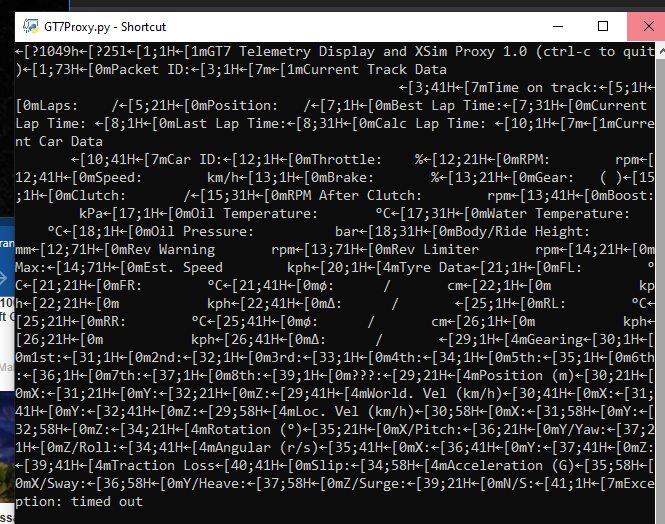

    I am having some issues running your plugin with V3 Beta simtools.
    1) I start the plugin and then start the GT7Proxy. About 2 seconds after the proxy starts and data is being read from the PS5 with GT7, the simtools app exits. This happens every time. The app does not exit until it starts getting data from GT7. I am able to run other game plugins in V3 Beta without any app crashes. I am running Windows 10 x64.
    2) The Gt7 Proxy output is not being formatted correctly for me in a CMD prompt (Python 3.9):
    I am happy to try to help debug this issue, but I'm a noob and just getting my first 2dof rig working so I'm not up to speed on how plugins are written or how they can be debugged.
    If you have any thoughts on what might be going on or something to try, I'd love to get this working/ help workout any bugs.

    12
    79Coins
    For anyone who is having issues with windows and the GT7Proxy output format, I took the @vthinsel GT7Proxy.py and added curses to it so I could see the output correctly. The window resize is not as clean as I would like, but I can see the data correctly now. I don't believe I broke anything since I was just playing with the console formatting. You will need to pip install windows-curses to use it. I tested under Python 3.9.13.

    GT7 proxy is responsible for taking the GT7 published telemetry data and converting it into the form that the SimTools GT7 Plugin can consume. On the machine that is running the proxy, the UDP ports 33740 and 33739 must be opened in your firewall. Normally this would be the machine that is running SimTools (but doesn't have to be). What issue are you seeing specifically? Are you seeing the data fields in the GT7 Proxy update from the PS5 running GT7 (in a race)?

    12
    79Coins
    I don't use the .exe proxy. If the window is closing on you, it's because there is an error. In order to see the error, you need to run a CMD window, cd to the proxy location and run it so you can see the error output.
    I use a cmd like:
    python Gt7Proxy.py --ps_ip <ps5_ip_address>
