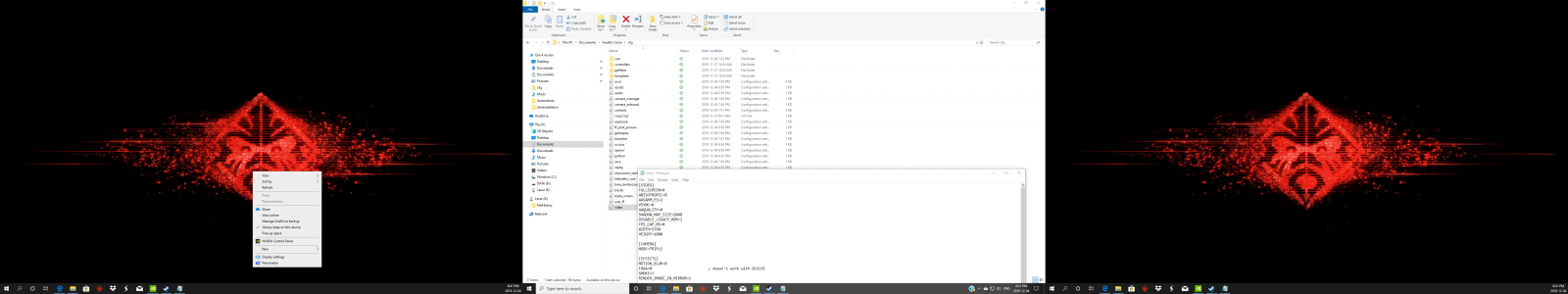

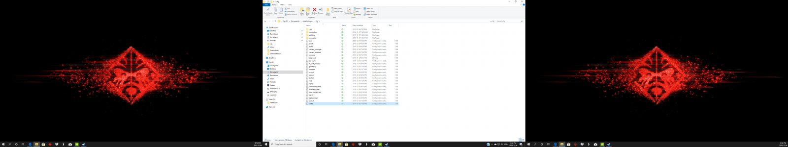

    so was no way able to get it running simply thru game setup and Project Cars2 worked no problem, so after some digging was able to find out that by going into documents then into assetto folder-open up the cfg folder then go to video open that file and edit the screen width to 5760, saved it then back into game, now resolution showed 5760 1080 and with game set to triple and full screen rendering off there it was.
    this sorta stuff is outta my comfort zone however learning more all the time :)

    sorry getting used to posting screen shots

    no idea, what you talk about. if you set your resolution with nvidia surround or the AMD Equivalent, you must be able to see and set the resolution in Game. Maybe the point is hard to find, but def. no editing of the ini's nessesary.

    did all of that went thru the steps many times and could never get option to select 5760 res. o went with editing and working good
