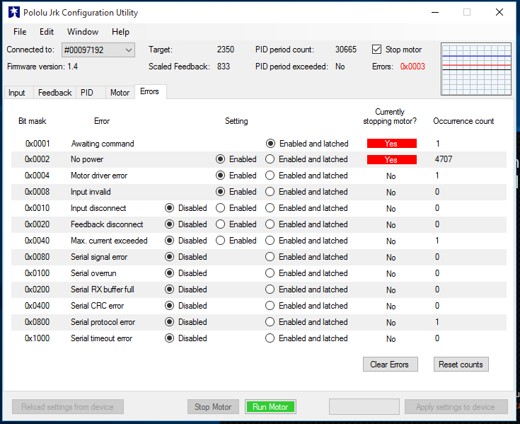

    Hello, if there is already a topic coving this I apologize in advance!
    I am looking to get 3 robust power supplies for my motion rig. I have had two different ones and the first set was mostly stable but wasn't able to run the Max Power % in Sim Tools higher than 98/99 depending on game. I switched to a higher wattage power supplies and now they are even worse and have to run them around 94%. (I'm not sure if maybe i just got a hard used batch and that is my issue). I am wanting to redesign my enclosure for all of my electronics and want to get this sorted out first so Im confident i have a metal enclosure big enough to hold everything.
    This is the power supply that I had the first go:
    Genuine HP Proliant DL380 575W Hot Plug Power Supply 321632-001
    This is the power supplies that i am running at the moment:
    Dell Poweredge 2950 750w Power Supply C901D JX399 X404H NY526 JU081
    I am using JRK's with these motors:
    http://www.ebay.com/itm/GEAR-MOTOR-...-25-1-ratio-/351066992384?hash=item51bd392f00
    Any help would be hugely appreciated and thank you again!

    Just a thought, are you sure its your power supplies, as it could also be your JRK settings. I may be wrong but am guessing you may be getting overshoots. Care to post screenshots of all settings?
    @bsft and others have reported good outcomes with JRKs and 12v 40 amp cheap LED PSUs from Ebay.

    not really a car or game specific just when motion is really working it (i.e. wreaks). but the thing is its not moving the motors far its just fast back and forth in a short distances since i have the axis turned so far down.
    The reason I'm somewhat skeptical of the Dell's are one i got was DOA, will power on etc but as soon as your plug anything into it it trips (even a simple computer fan). And they were rather cheap, I got 6 for $45 (pretty sure that included shipping too). and more over the Voltage output is 11.74-11.80v. What is your voltage output on yours @Nick Moxley ? I know you have/had those and liked them a good bit

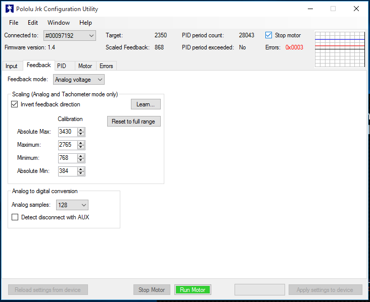

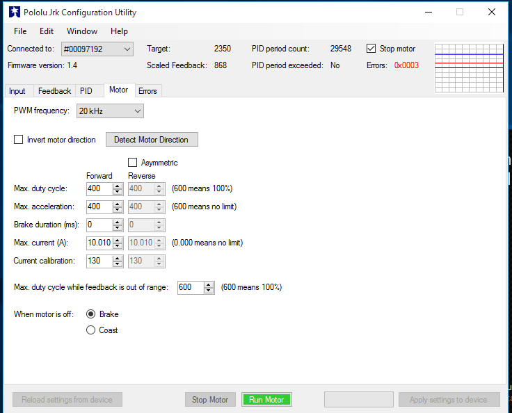

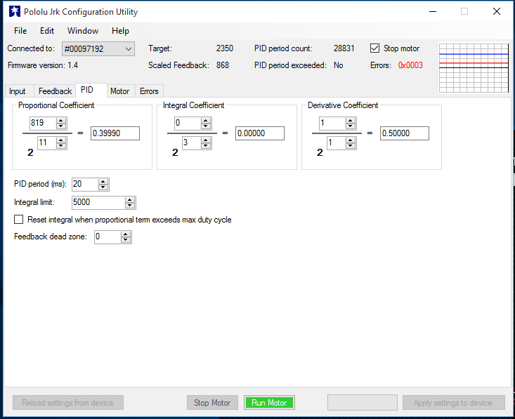

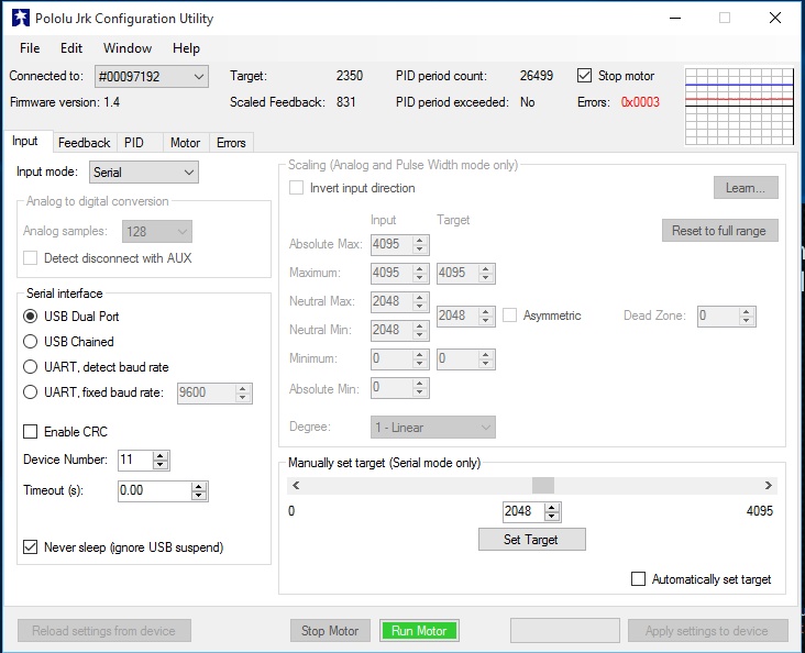

    all right, so ive attached screenies from all tables of the config utility as well as the settings text file just incase there was something in there you guys wanted to see that i didn't happen to get
    thanks again the help guys
    edit: the power supplies were off at the time of the grabs so the no power error was legit

  10. bsft
    @rundmg
    Raise Integral limit to 10000
    Raise analog samples to 512
    Raise max current to 0 (unlimited)
    Apply settings

    sweet thanks @bsft the max current actually was 0.00, i was playing with that before thinking it was pulling too many amps from PSU and forgot to change it back. I made the other adjustments as well and will give her a shot once I get a chance.

    A couple of additional suggestions.
    In the Motor tab set When Motor is off to Coast.

    Yes. Give profile fixes a try . Its difficult to keep total percentages at 100. But you found like the rest of us , drop main level down a bit. PID looks ok. I will have a look again when i get home

    Also @rundmg , you're using motors at 66% (max duty cycle and max acceleration @400/600) so there's plenty of room to increase values.
