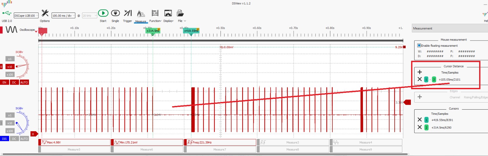

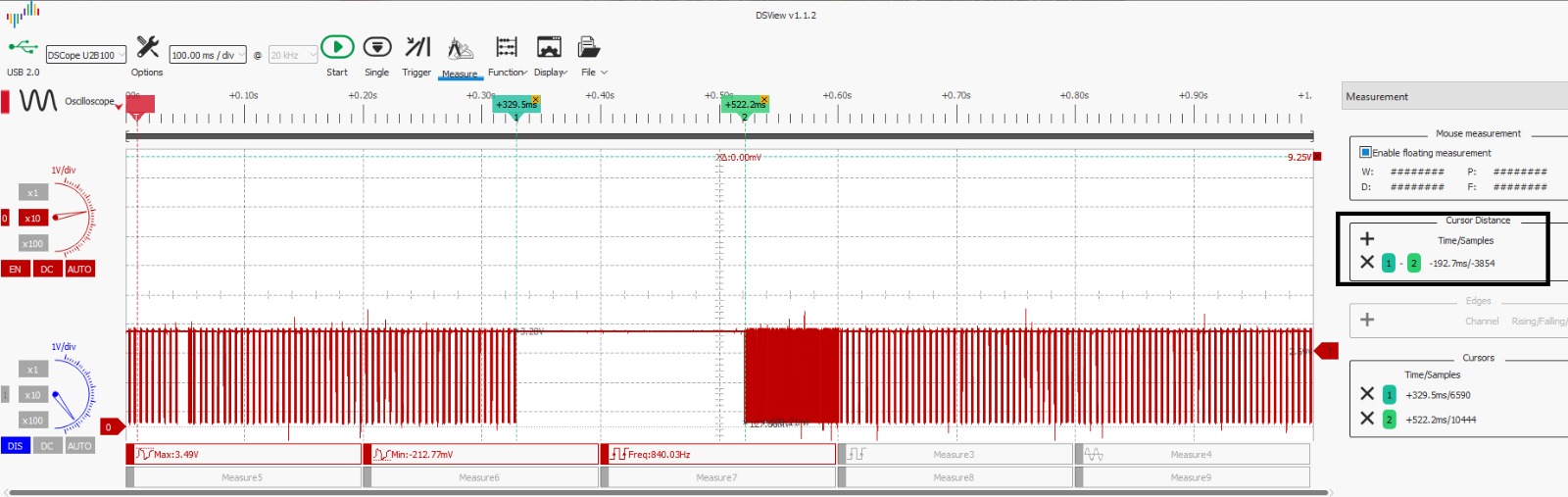

    Hi everyone,
    I'm building my own interface but I'm facing a problem. Using FlyPt mover it gets to stop to transmit the packets then the mover sends the "buffered" packets all in one time making some glitches. In the attachments, you can see the packet that gets stop then send the unsended packets compressed in a little time, and this causate continuous bursts, I have picked these diagrams from the serial with an oscilloscope. Someone can advise me on how to let it send the packets the most continuously and regularly as possible? Does someone already face this problem?
    Thank you in advance 0b6df4b5-3262-4209-8e0b-17f154fec40e.jpg 5a28befa-dbd1-429d-a58e-f1a8e75ba527.jpg
