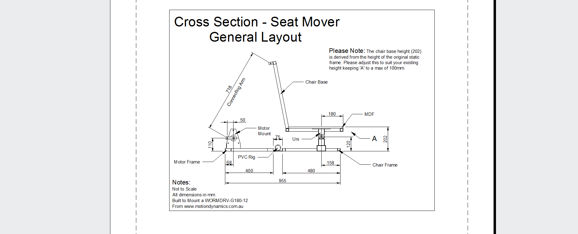

    Rear is what you require at the shoulders mate, the most efficient way to transfer power, further you move from the pivot more inaccurate motion will be but with clever profile writing this can be overcome.
    Forget about xsim mate, there is better (internet free) software being beta tested and if your sim is ready for testing, you can gain access to setup your sim, 24 games supported so far and is growing weekly.
    There is another driver on the horizon too, Kangaroo from Dimension Engineering, which will allow you to drive 12/24v Motors at 60amps with peaks up to 100amps. I need to buy a sabertooth before I can confirm this is a viable driver for Sim Tools. In theory and research it all points to being a good of the shelf alternative for DIY Sims.
    An example of one running , Jrks, 12v 200W DC Worm Gears on Sim Tools.

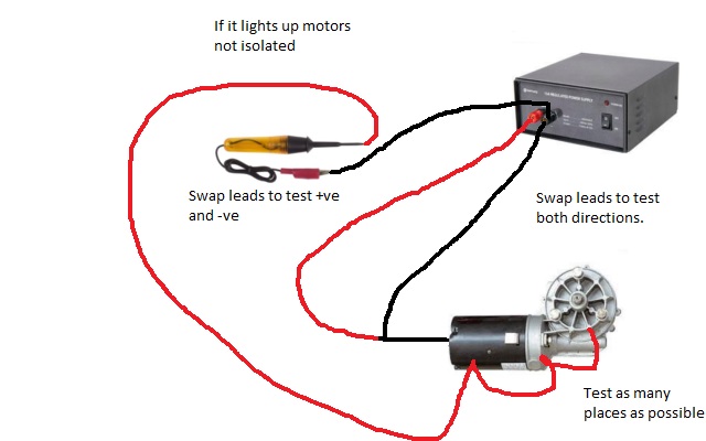

    If you are going to use wiper motors from cars as a start, then make sure you earth isolate them.
    car wipers are usually earth to the case and feedback voltage with bugger any controller.

    Again, if you are going to use wiper motors, refer to my post above about earth isolate them.

    Well I went to the junk yard today and got 2 decent wiper motors, although not ideal for the final version as a learning experience I feel they will be fine. They work with the sabertooth 2x25 I just got and I am in the process of talking to Rene about getting a copy of the software to try out the kangaroo with, I still have to go out and get some limit switches to go with the kangaroo and some better pots ( any recommendations as to type and ohms?). Soon I will be getting down on the frame after getting a seat this week hopefully. When I really dig into the software I'm sure I'll have more questions, just a little update.
    Edit: quick update as per Bsft's advice I isolated the motors, I cut off the lead inside the housing going to the slow speed brush and used a soldered jumper to power the negative side. This allows me to use the one single connector to the motor and isolates it at the same time.
