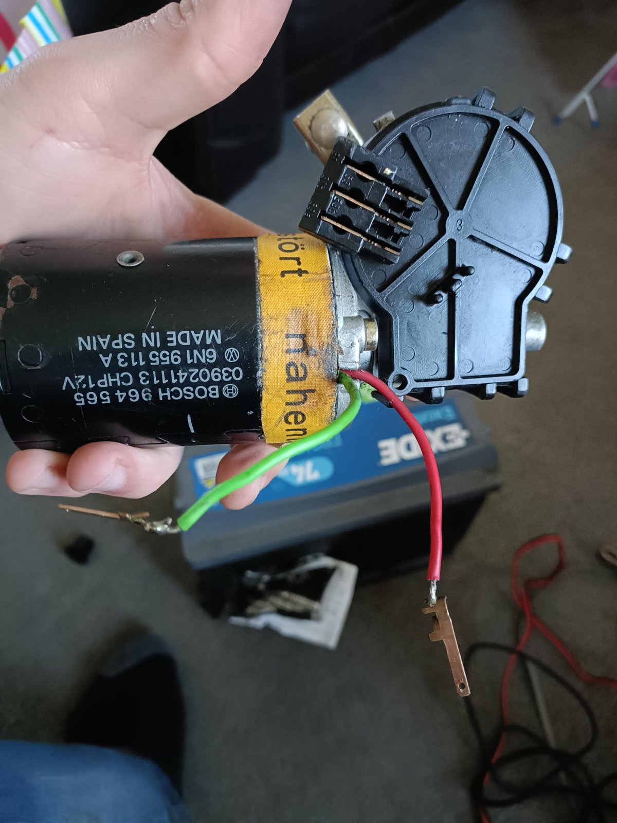

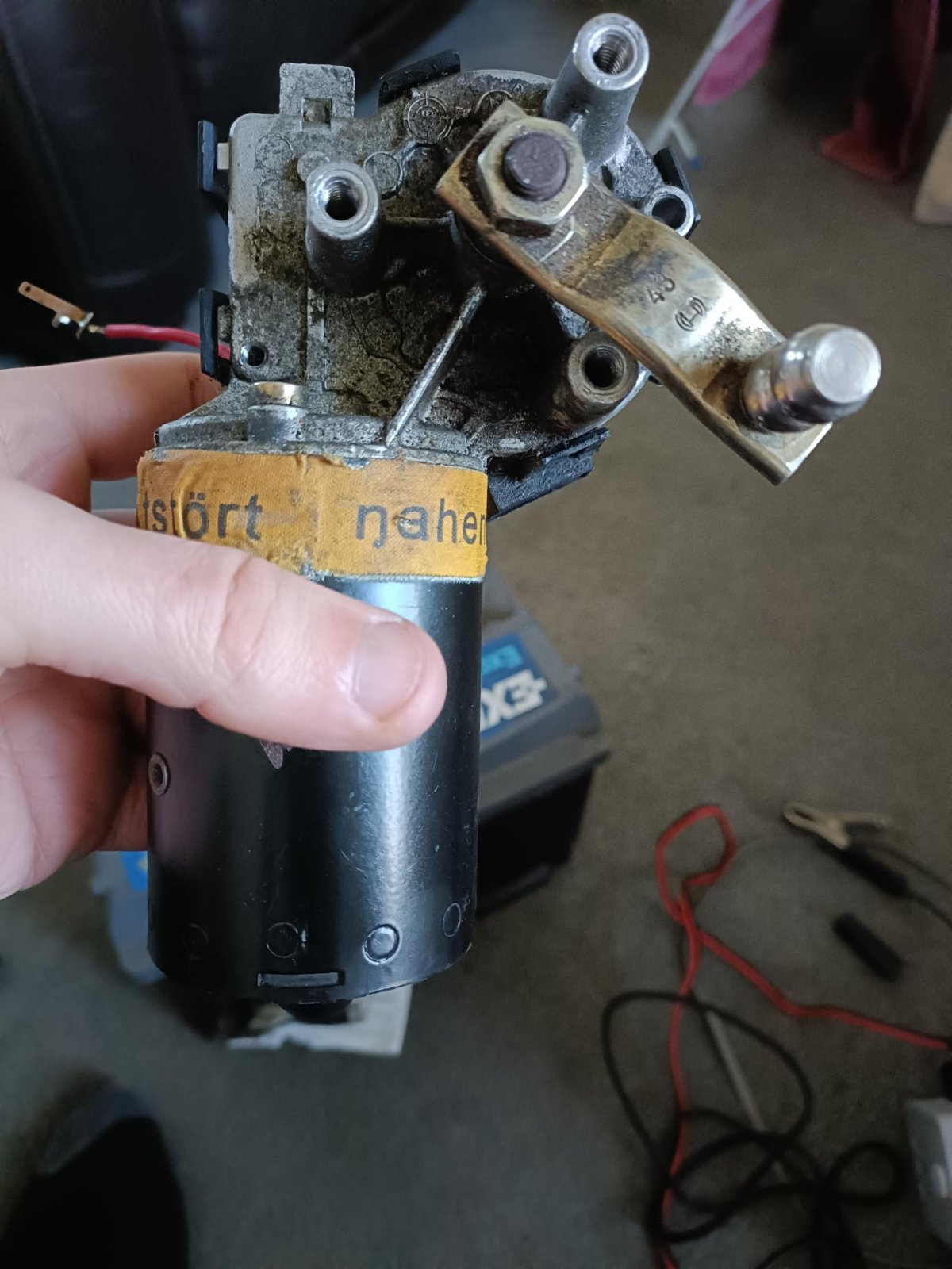

    So my dad had an VW front wiper washer.
    Quick test showed its powerful, so going to start testing with it and see if it has enough power or not.
    Did some very quick test and its about 60rpm and over 300w at stall.
    Need to upgrade my rid first as my current rig is wood, and will be to heavy,
    Going for extruded aluminium 40x40 with T slots,
    Will cost me about £120 in parts
    Going to start with a 12v 40amp power supply, and put 20amp fuses for each motor to avoid blowing the PSU. I know if I run my motors to stall it will blow the fuse, but for now I'm making sure my parts are going to work. Then ill be getting my second PSU if the one I have is good enough quality.
    Ill be using 40amp h-bridge driver for each motor and using
    SMC3 Arduino 3DOF Motor Driver
    in mode 2 with the h-bridge driver.
    Then going to find the centre of mass of my rig and install a ball joint there.
    I'm going to mount the rig off the ground at the same distance as the motors in neutral position to give me the most range even if I don't use it.
    Iv worked out that with the motor I have should have about 8 degrees of motion for breaking and acceleration. so 4 degrees each way.
    I have a few questions.
    Would the above rotation be enough in VR? 8 degrees forward and back, roll rotation can be more on my rig worked it out to about 30 degrees 15 each side.​
