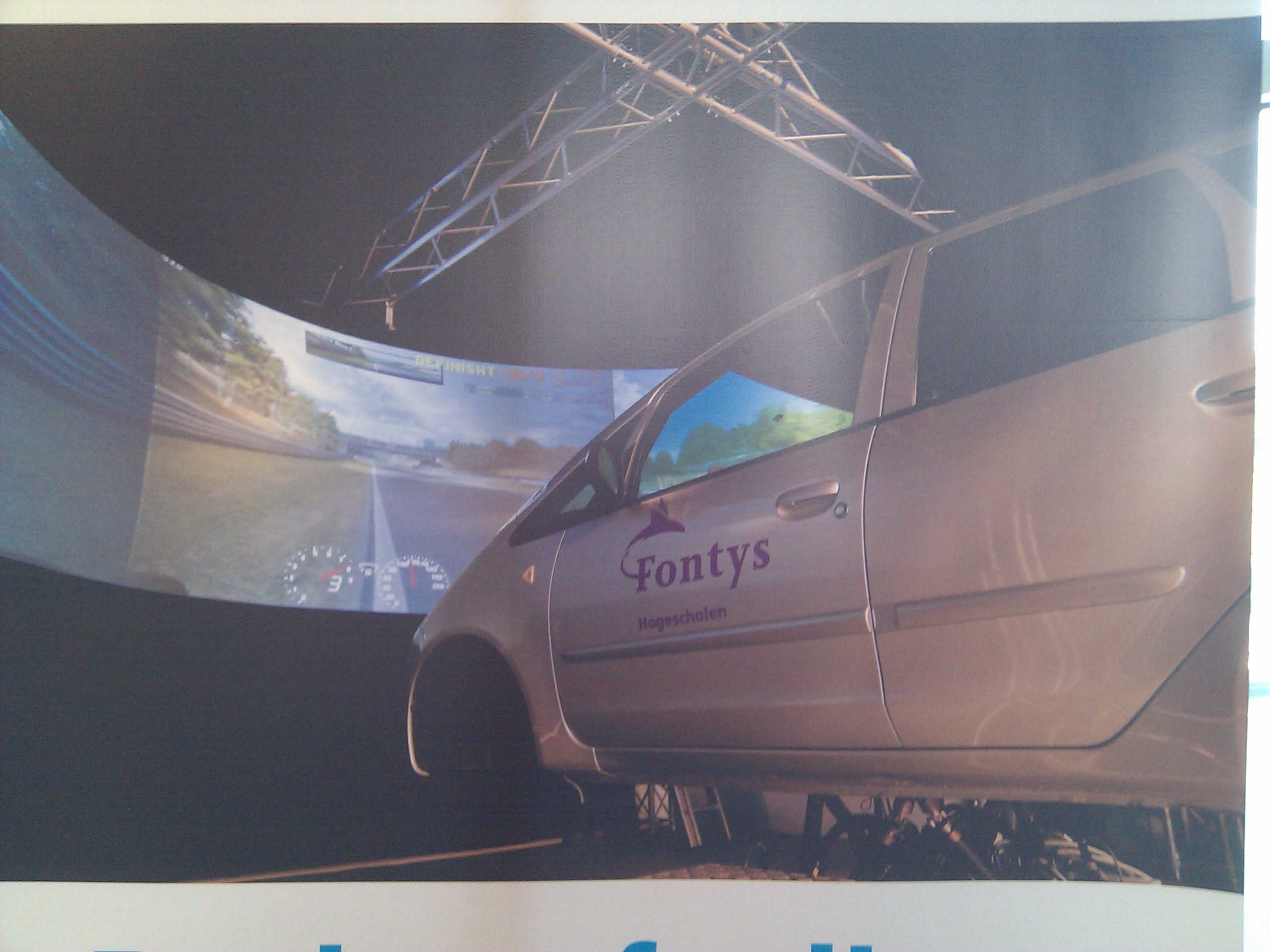

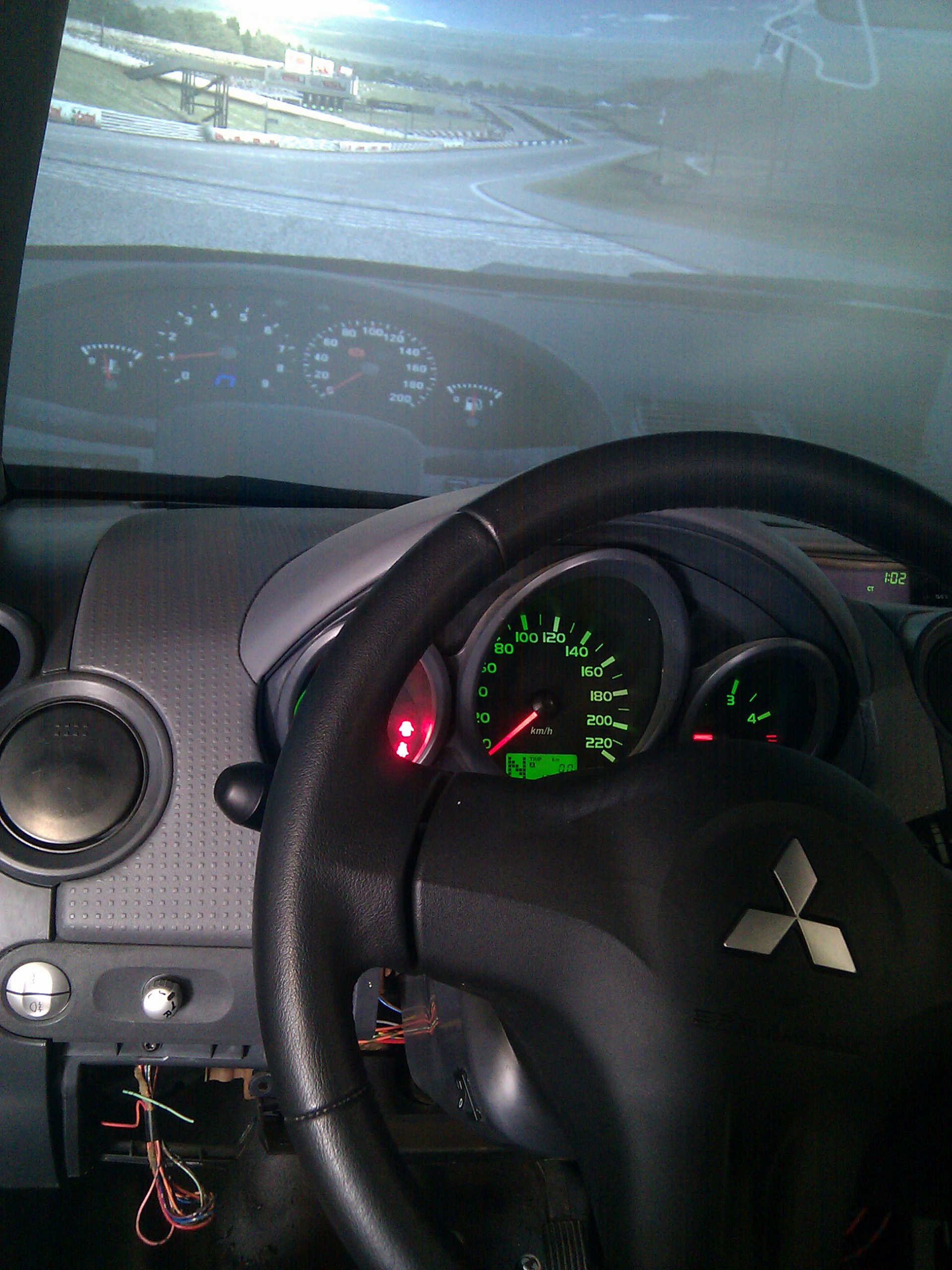

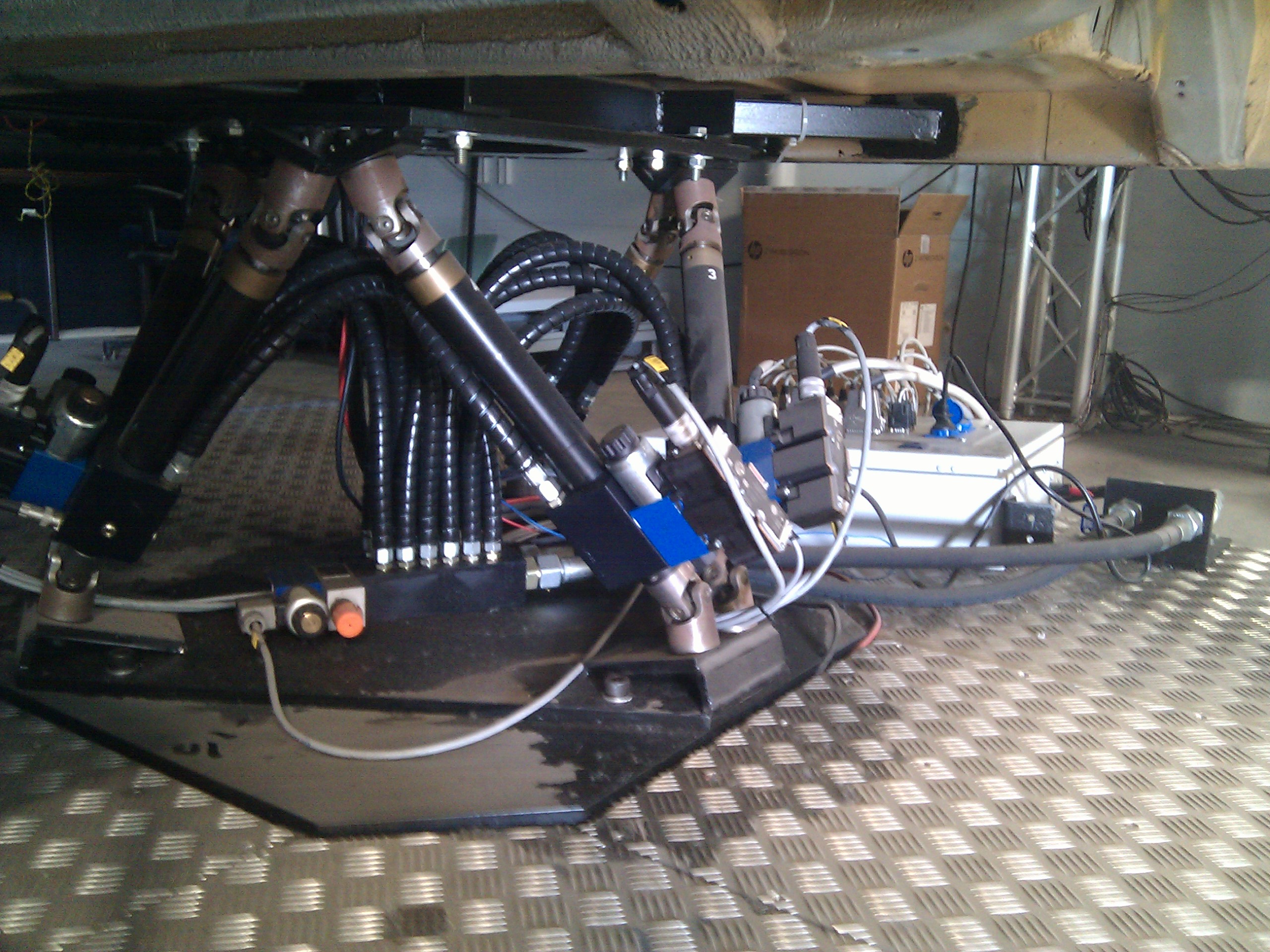

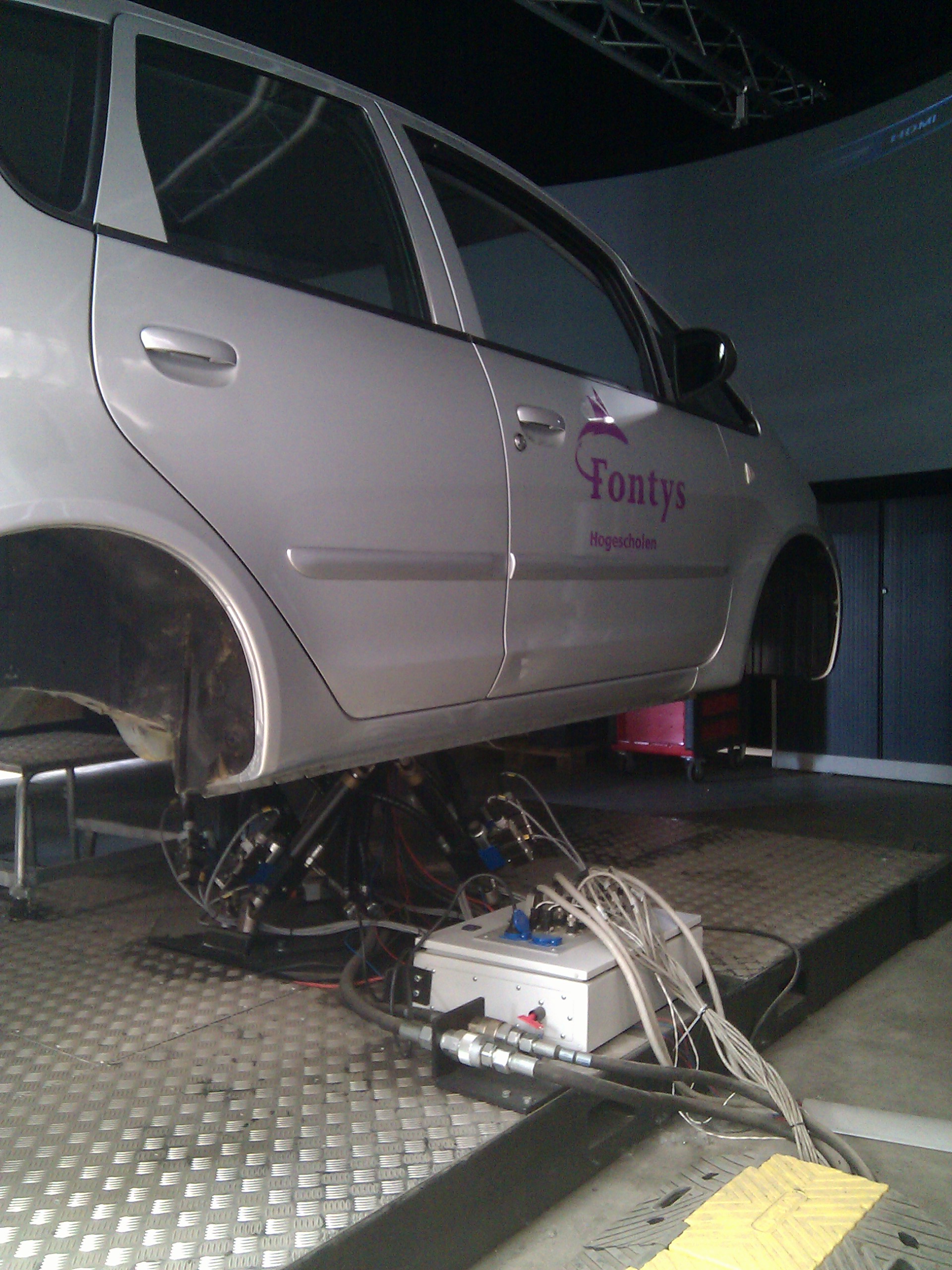

  11. Fontys
    Fontys New Member
    Sep 18, 2013
    11
    Helmond, The Netherlands
    15Coins
    Motion platform
    Pictures :) p.s. Stupid dropbox; they showed fine for me.

  12. RaceRay
    Nov 8, 2006
    4,657
    Hamburg, Germany
    23,875Coins
    +2,037 / 13 / -0
    Dropbox does not allow hotlinking. So please download the pictures to your computer and than use the forum upload function:)
  13. value1
    Jan 9, 2011
    2,184
    Zug, Switzerland
    14,946Coins
    +3,328 / 11 / -1
    Wow! Impressive! :cool:
    The next time I'm in Eindhoven I'll come visiting you and you have to offer me a ride on your simulator! :D
  14. RaceRay
    Nov 8, 2006
    4,657
    Hamburg, Germany
    23,875Coins
    +2,037 / 13 / -0
    Absolutely impressive!!! Its funny to see that the pure 6DOF mechanic is smaller than the most home motion simulators here:D
  15. Fontys
    Fontys New Member
    Sep 18, 2013
    11
    15Coins
    Motion platform
    Being able to have a direct connection between the bottom frame and the platform instead of needing moment arms surely helps that fact. Well, that and the fact that there's a 0.5m cube hydraulics cabinet out of sight ;)
