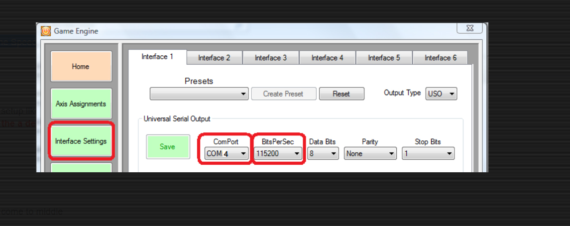

    I have tried loading the config files from the arduino servo model program and racingmats 2dof wiper motor arduino with the same message each time. "Not a valid simtools preset file". I am dragging and dropping the .cfg files into the preset installer box with the wrench on it. Any ideas?

    The quickest resolution would be to manually enter the Interface Settings for @RacingMat's code, the one difference from this photo is that for SimTools 2 in Interface Output it should be R<Axis1a>L<Axis2a>

    Thanks. I noticed on his post that his Output Type is set to USO. This doesn't show in my Simtools 2.

    Select Serial in Interface Type.
