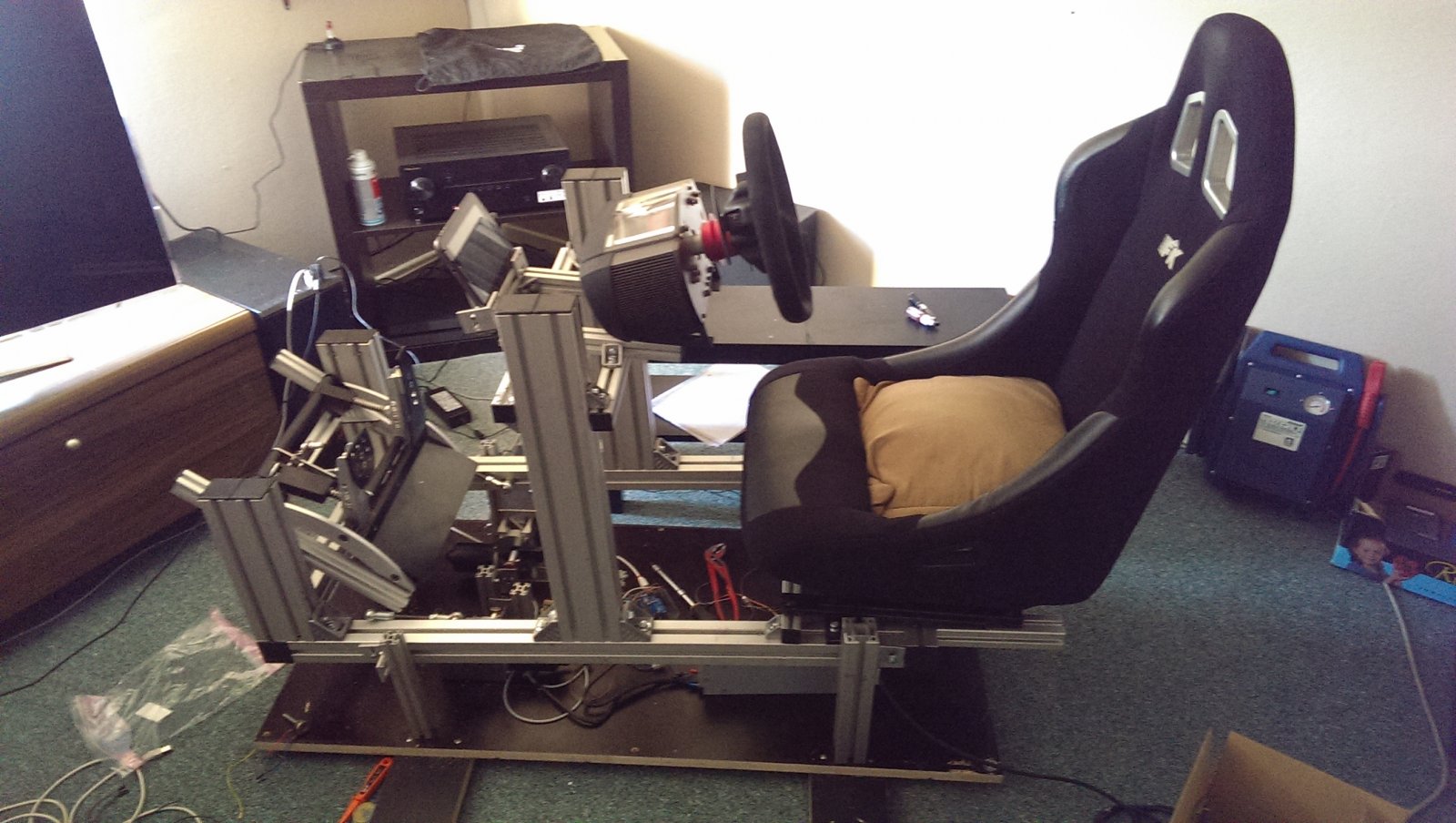

    Hello community . I 've started a simulation project with 2DOF .
    I have finished the frame . Now I have Arduino UNO and MotoMonster bought and wired shild . So far so good. But now the problems begin .
    Have taken from me the racingmat instructions .
    Have the max and min set potentiometers . Then the motors rotate at the start ever in one direction .
    The motors I ground away .

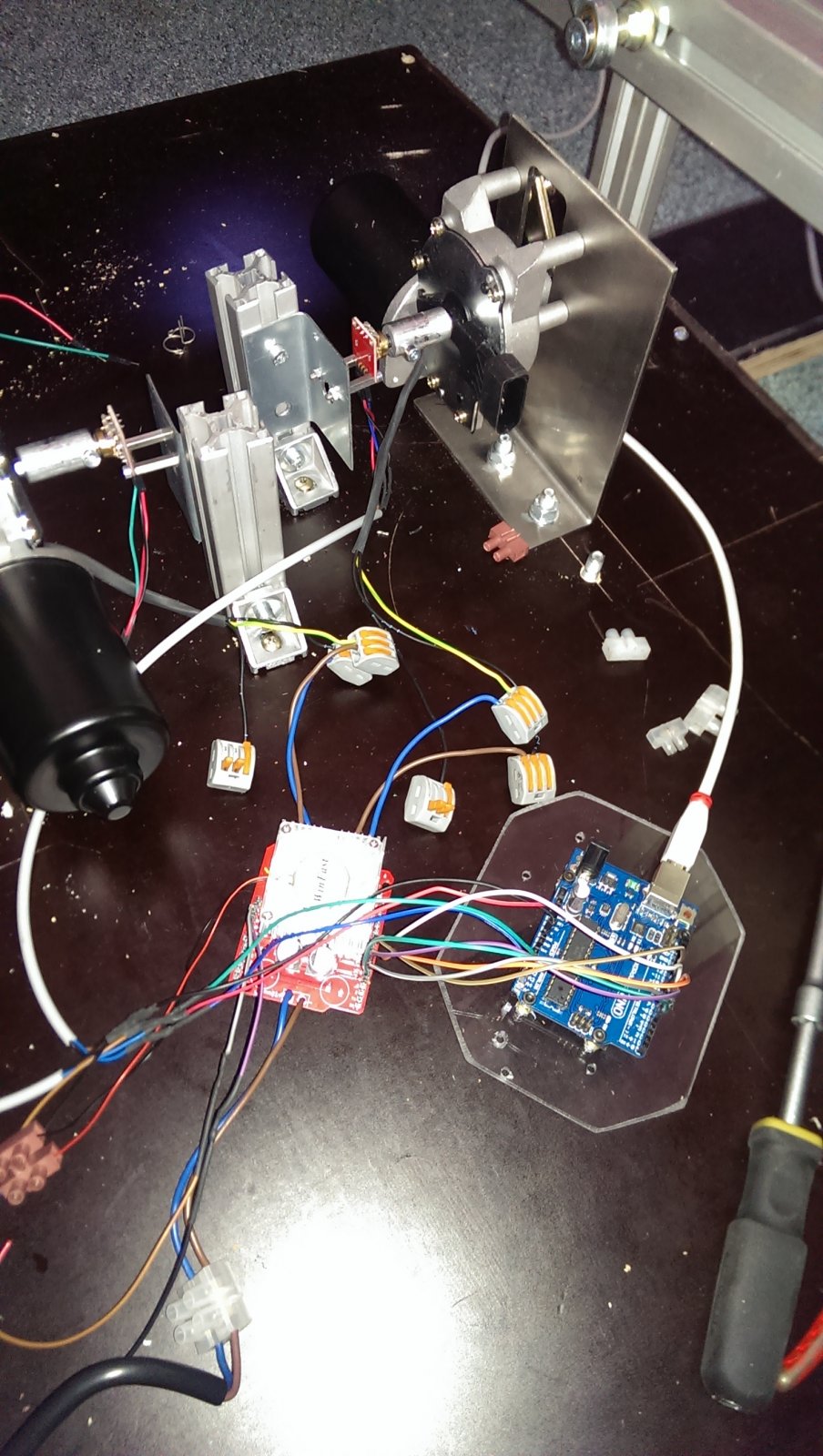

    This are the images

    What did you do so far? I cannot advise you if I know rather nothing about your gadgets. We need:
    • HQ photos from the Ard and MM
    • You could take a video to show us what you are doing and what exactly happens

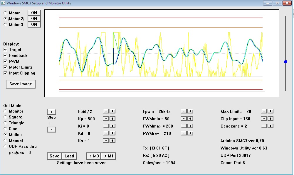

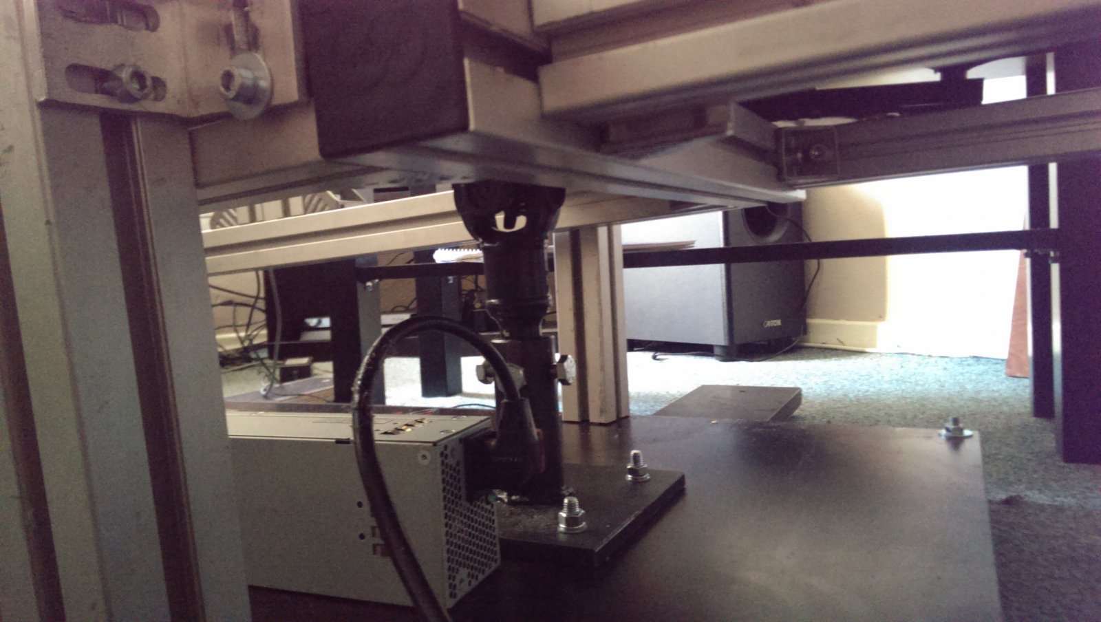

    thanks for answer. ihave only a bad camera .
    i have make what tombo said. thanks.
    the motors and potis run.
    but the plugin is what i need that the game give the signals to moto monster.
    or iss this wrong thinking?

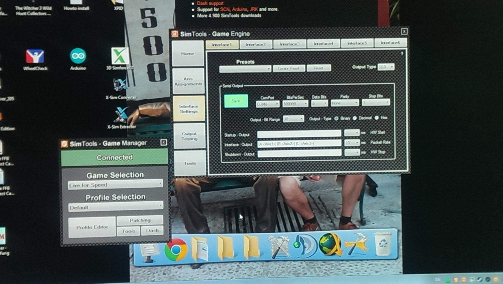

    i have new pictures from the setup smc3.
    thanks at all

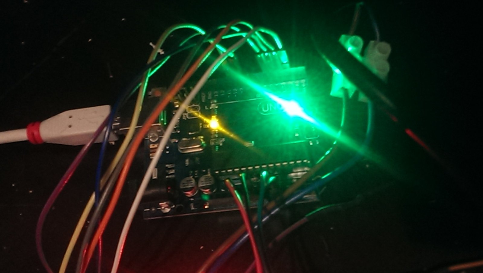

    the signal from arduino to shild is okay.

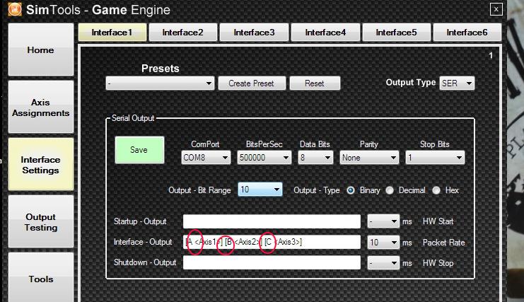

    so habe das alles hinbekommen. nun habe ich auch das Plugin von projekt Autos.
    alles nach anleitung eingefügt und gepatcht. aberrrrr
    Wenn ich nun Ausgangsprüfung im simtools gehe, keine Funktion.
    im Spiel das selbe!
    habe ich noch irgendwas vergessen?
    habe available mit Raceroom Versucht. Genau das selbe.
    eigentlich müsste es doch ohne Plugin Auch beim Ausgangstest gehen oder nicht?

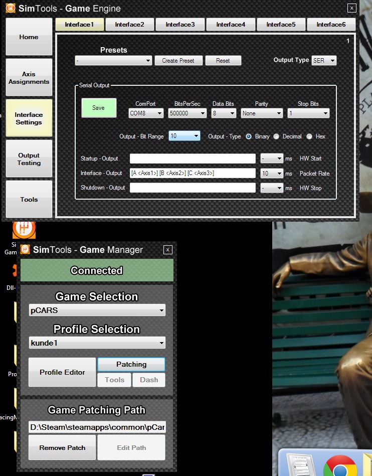

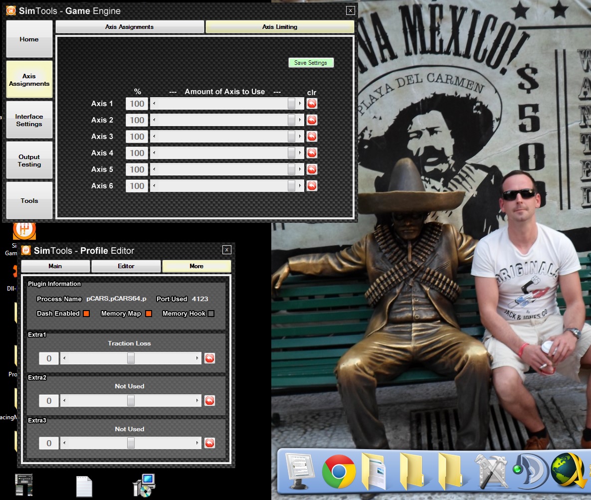

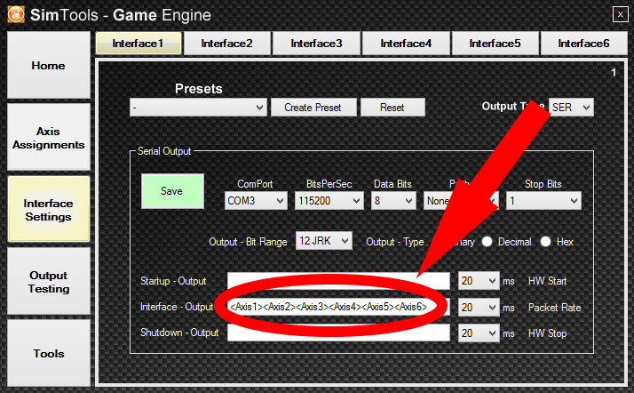

    Did you define some axes in the interface settings:
  14. Pit
    3,012
    30,472Coins
    +3,097 / 31 / -0

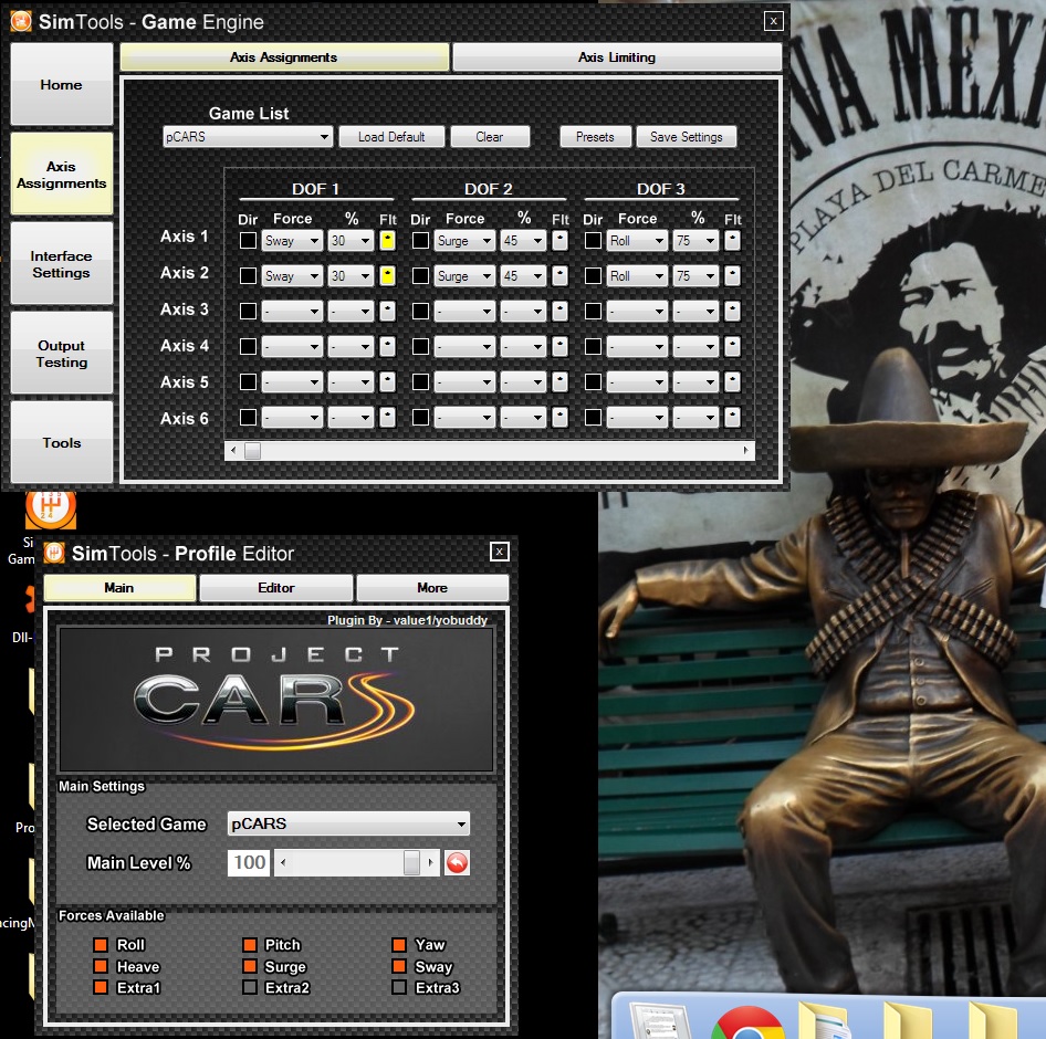

    no support without screen shots of all your settings, including SMC3, Simtools, Game Manager, Game PlugIn etc. :)

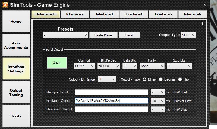

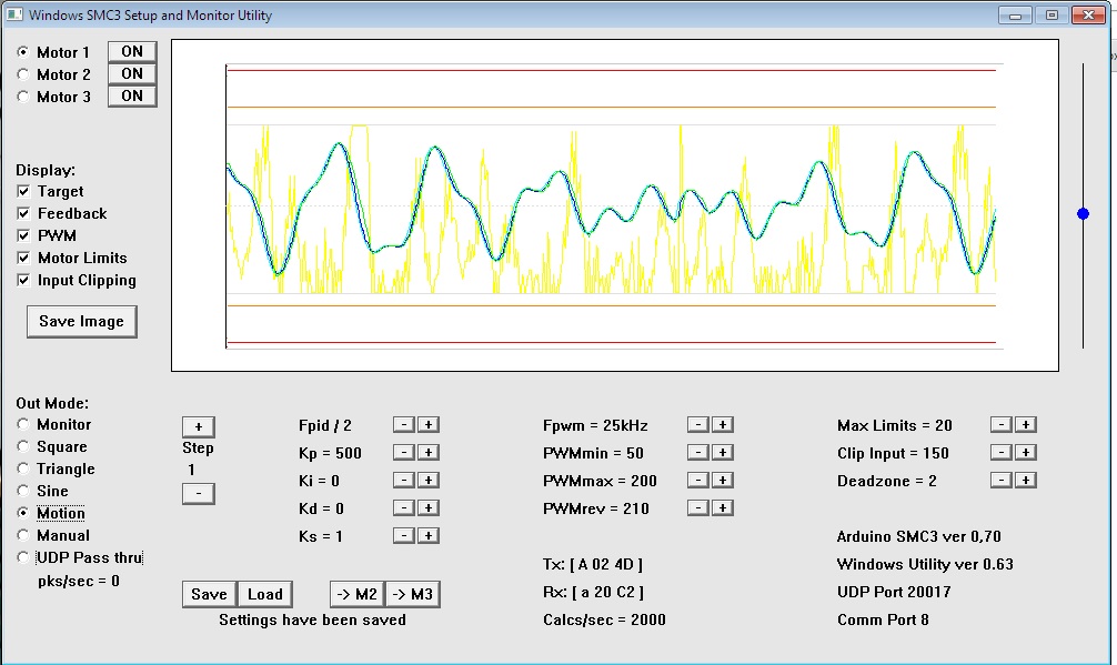

    so da haben wir die Bilder.
    ich denke das ich das setup richtig eingerichtet habe.
    hoffentlich:)

    I found the fault...
  18. Pit
    3,012
    30,472Coins
    +3,097 / 31 / -0
    Du verwendest Leerzeichen, da dürfen aber keine stehen.
    you are using blank spaces, but they must not to be used here...
