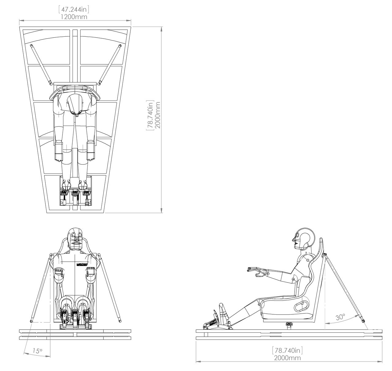

    This will be 3DOF with a metal frame structure. Here is a preliminary CAD.
    I'm planning on 30degrees back and 15 degrees to the side. I weight 84kg and say my seat weights 15kg. This will be a seat mover. I dont expect anyone much heavier than me using.

    Your plans should result in a really fast well powered rig, capable of some pretty brutal movement with say 80mm CTC levers off those motors.

  10. bsft
    Hello, frame looks just fine but Id suggest 50mm CTC levers, not 80mm. Thats from 4 years, 14 build experience.
    And yes, the software motion profiles can be "softened" a bit.
    What control boards are you using?
