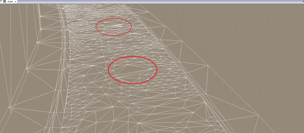

    Fact, you not getting uber fine details from your Gear motor's does not mean they cant produce said Uber small details. When i can pin point a 7 sided tri in a Physical mesh on one of my Favorite tracks. Im pretty sure my motor's/Tuning are doing their job.
    Fact my motor's are 4+ years old, have 1000+ game hours on them and still provide the ultra small details Kunos and other Legit laser scanned tracks offer.
    Fact @24 seconds you can hear a good oscillation with No game volume as I was exposing a damper issue that was fixed with a Physics polling rate update

    Great you have 1000+ hours on your rig. How many on an scn rig? Did you run your triangle mesh test on scn? What other tests have you run on both scn and gear motor? Until they are equal with equal amount of time spent tuning the systems you're comparing apples to internet videos.
