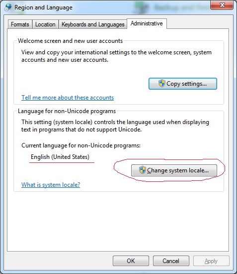

  4. yobuddy
    5,374
    50,295Coins
    +5,149 / 18 / -0
    Please try this buddy,
    Let me know how it goes...
    Take care,
  5. papak69
    papak69 New Member
    Oct 8, 2017
    Slovenija
    124Coins
    SCN6, SimAxe, Arduino, JRK, Motion platform, 6DOF
    So I change the locale (if it is not setup like that) to English (United States)?

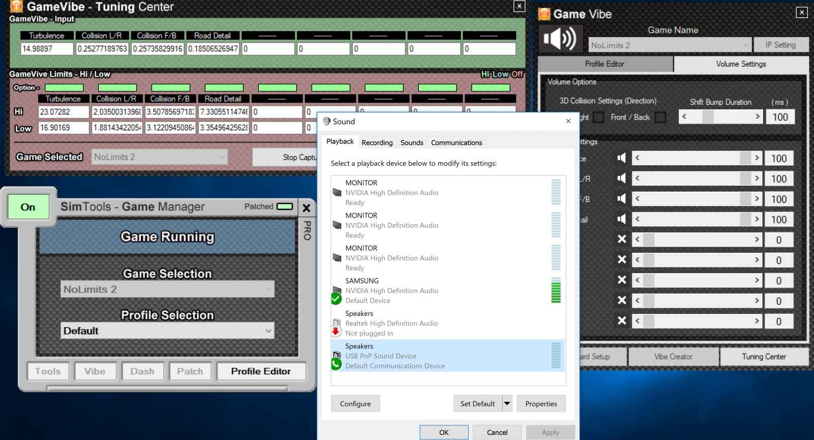

    Hi all
    I had been enjoying my Game Vibe/buttkicker for about a week and now for some reason it is not working anymore. I can hardly detect any output from game vibe sound card when running the game. I have gone into game vibe sound testing and verified that they all worked well. As I turned on the sound test I can feel/hear the buttkicker working forcefully. however when I go and run the game then I can barely detect any vibration. If I glue my ear to the seat then I can hear some weak rumbling but it hard to feel anything. I tried the tuning center several times but I am still not able to get it to work.
    My sound card is a USB and this is the one I configured to work with game vibe. As you can see from the picture it shows pretty much zero output level. In the picture my internal sound card is used for outputing the game sound onto the samsung tv. that works without issue and shows a strong output level.
    could someone help me out?
    thanks
  8. yobuddy
    5,374
    50,295Coins
    +5,149 / 18 / -0
    @stargazer,
    Are you running the current version of all apps buddy?
    What does your sound card setup look like?
    Take care,

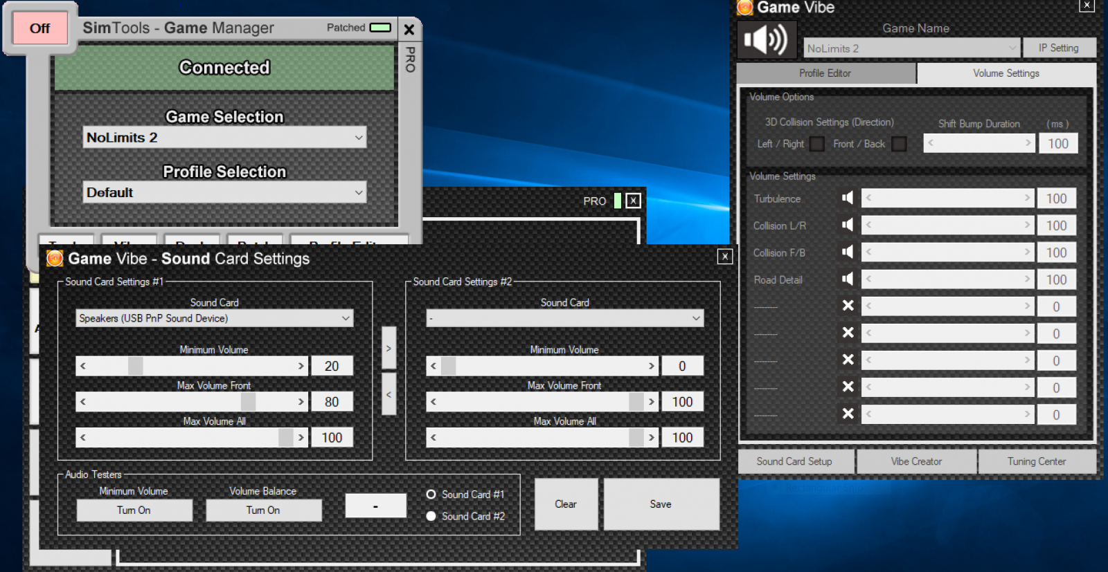

    @yobuddy , do you know where I can get the sound card config?
    Yes, I am running the the latest version of simtools.
  10. yobuddy
    5,374
    50,295Coins
    +5,149 / 18 / -0
    Its the bottom left button on GameVibe's main gui.
    Chat soon,
  11. stargazer
    stargazer Active Member
    Jun 29, 2018
    129
    Electrical/Computer Engineer
    Boston,USA
    811Coins
    +35 / 0 / -0
    3DOF, Arduino, Motion platform, 4DOF
    here is a picture of my sound card setting. It is set to output to the usb sound card.

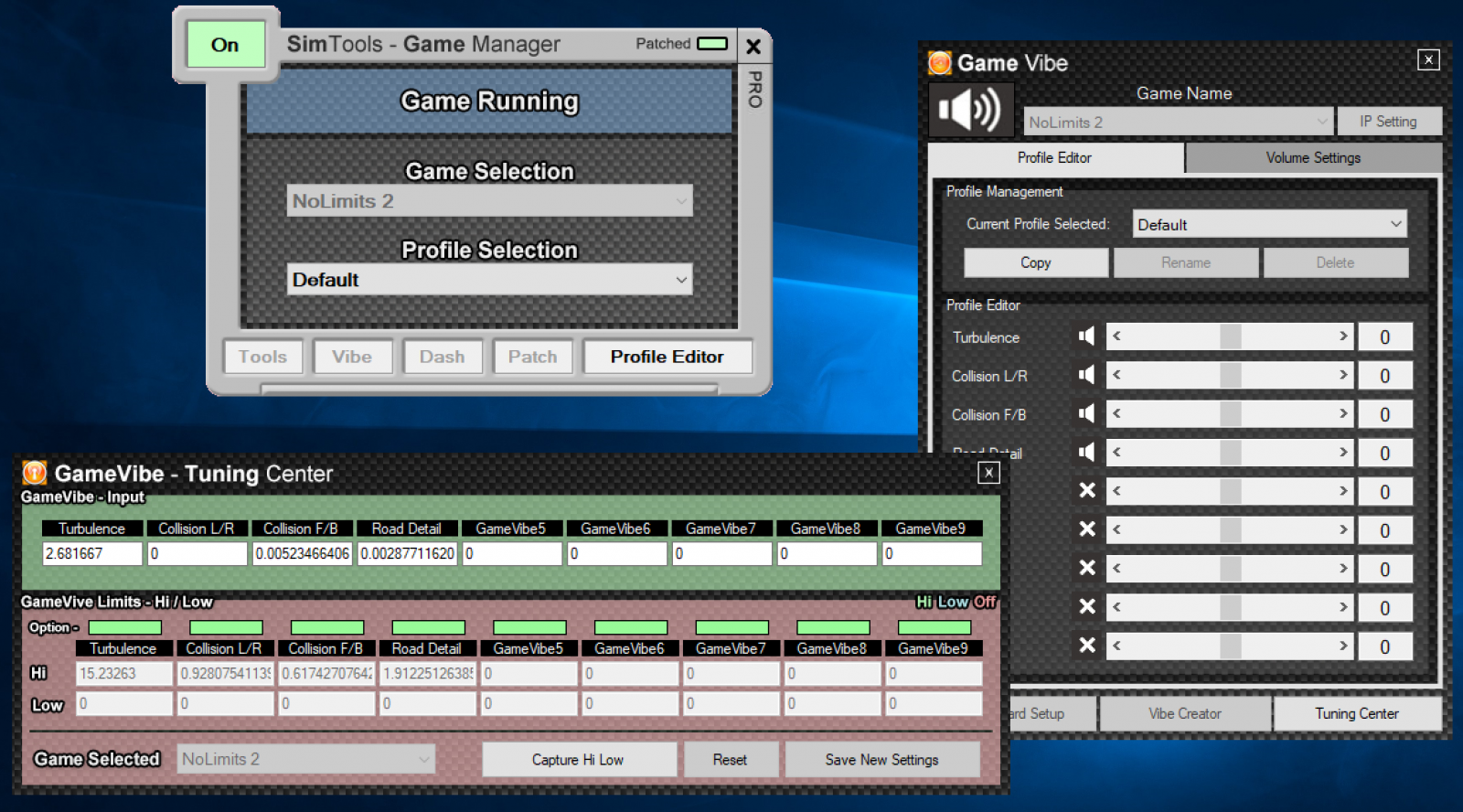

    May I see you profile Editor page please.
    Everything else looks ok so far I think.

  13. stargazer
    Jun 29, 2018
    129
    Boston,USA
    811Coins
    +35 / 0 / -0
    I changed the sound card to another usb port and I still had no vibration from the buttkicker.
    The picture show the profile editor for the game.
    I also made a video to show that the buttkicker is working during audio output testing, but during the game it just has no vibration at all.

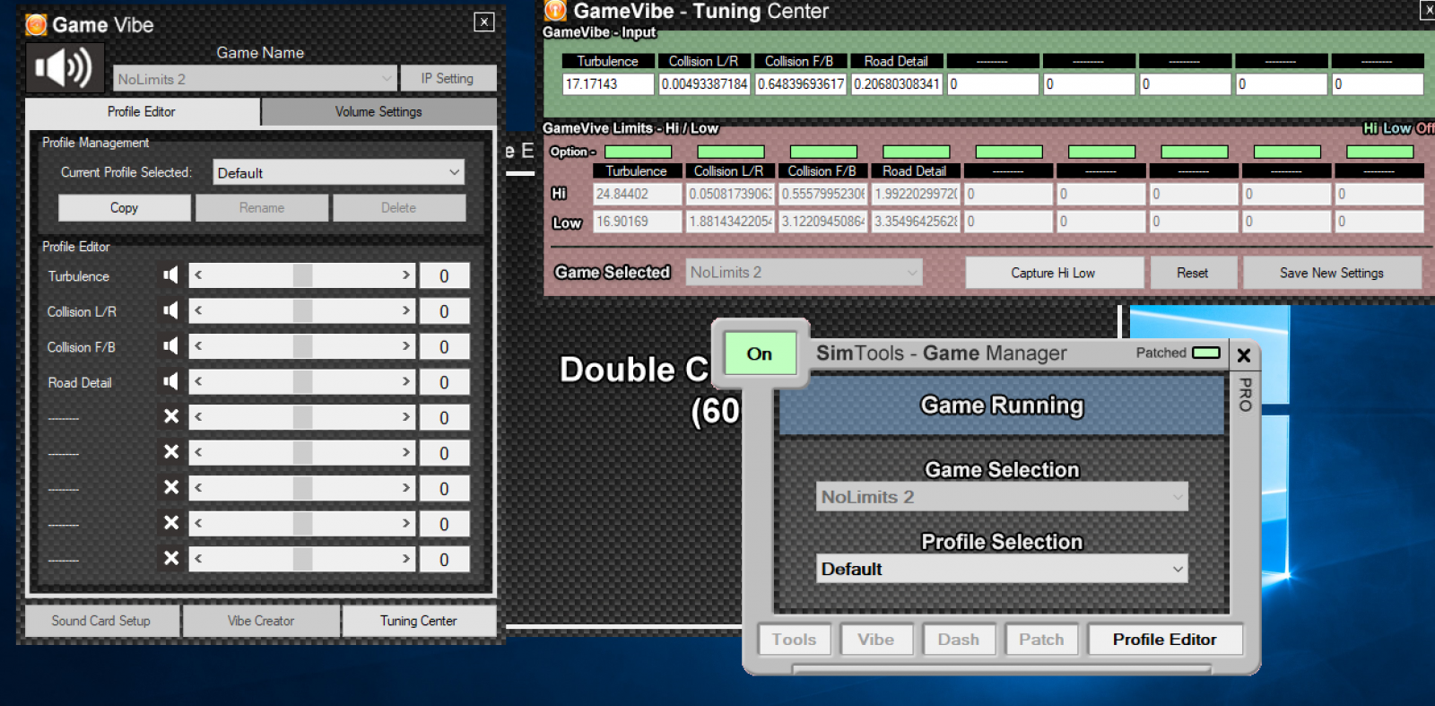

  14. yobuddy
    5,374
    50,295Coins
    +5,149 / 18 / -0
    For the collision and road detail it looks like your Hi values are lower than your Low values?
    (This would cause no sound at all I believe.)
    I would suggest removing GameVibe all together (say yes to remove old files and settings, and reinstall.
    It would be the fastest way to reset GameVibe and get it working again I think.
    Take care,

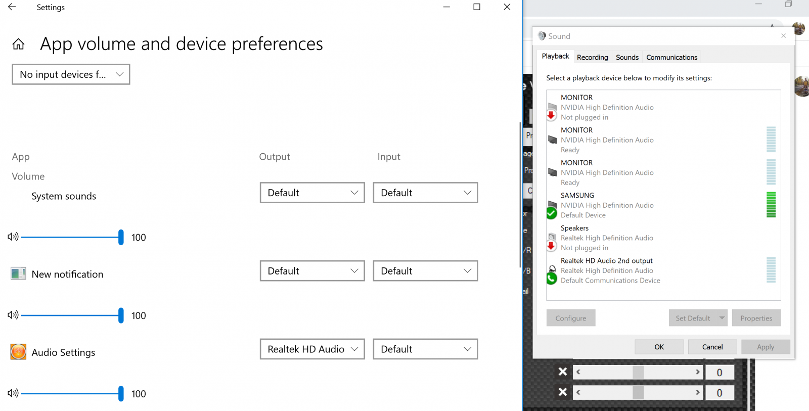

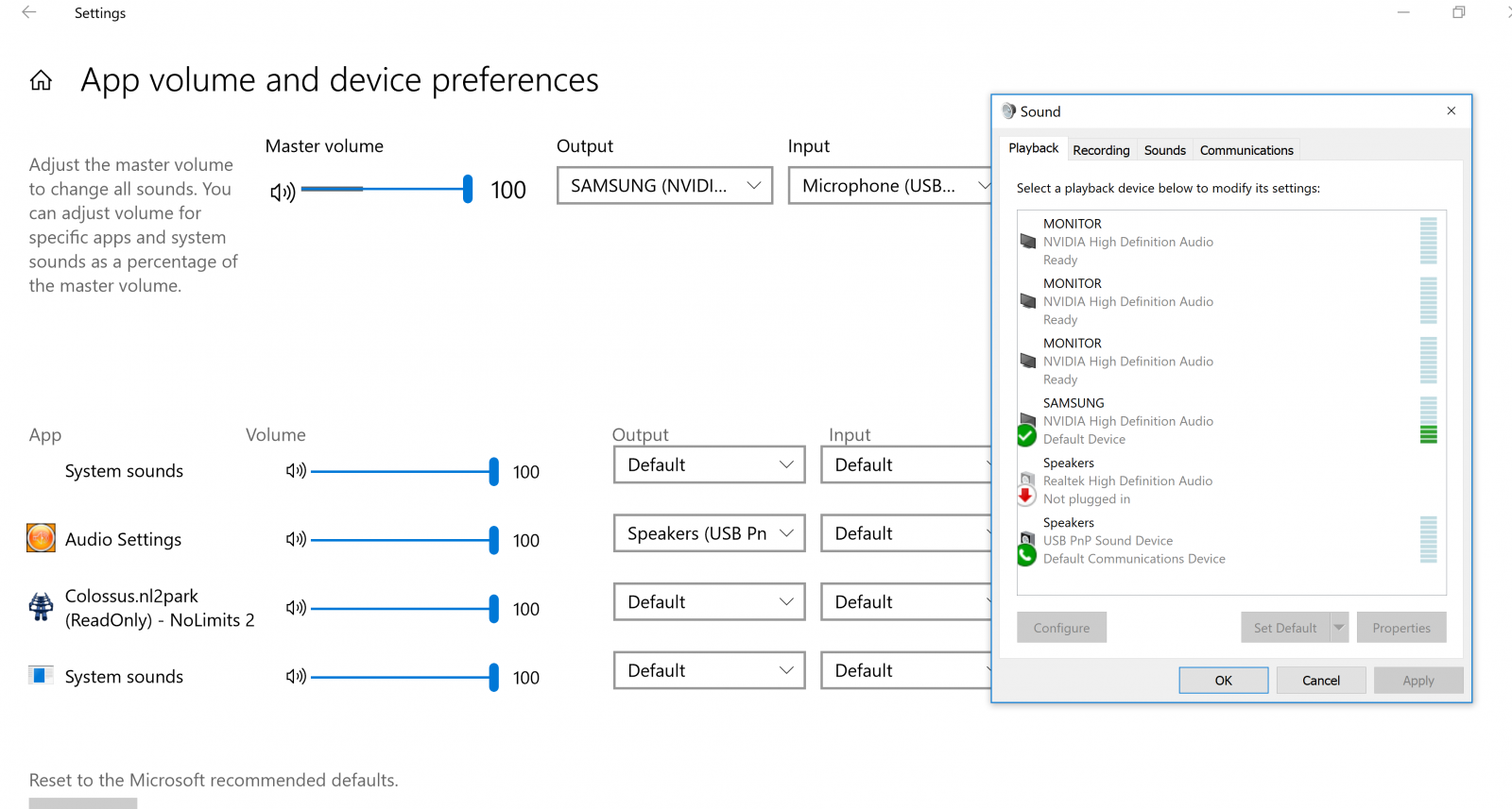

  15. stargazer
    Jun 29, 2018
    129
    Boston,USA
    811Coins
    +35 / 0 / -0
    hi @yobuddy
    I uninstalled and reinstalled game vibe. It still did not work. as you can see from the windows setting and status, there is no output detected on the usb sound card which is the one connected to game vibe. The second picture show the hi low values in the game vibe tuning.
  16. yobuddy
    5,374
    50,295Coins
    +5,149 / 18 / -0
    @stargazer,
    Can you swap the sound cards, use the usb for game sound and the built in one for GameVibe.
    I want to see if the problem follows to the new card.
    Also, if you would please, zip up and send this folder to me so I can take a closer look as to what may be wrong.
    %localappdata%\GameVibe
    Out of curiosity, have you tried another game by chance?

  20. stargazer
    Jun 29, 2018
    129
    Boston,USA
    811Coins
    +35 / 0 / -0
    I tried the language setting but still getting no output from game vibe during the game.
