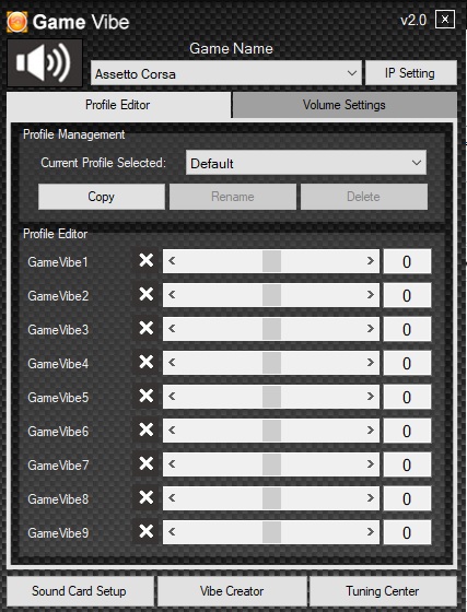

    I just recently upgraded my DIY license to a Pro one so I could run GameVibe with Assetto Corsa, but I have some questions regarding the setup. I was trying to set up all the effects before starting things, but when I select Assetto Corsa from the drop down menu at the top of the GameVibe window the effects list below it just says "GameVibe1", "GameVibe2", etc. It doesn't populate them with the effects that Assetto Corsa puts out. I have the same problem in the Tuning Center in that I don't know which effect is which for tuning them to set the highs and lows. Do I need to reinstall a plugin or something?

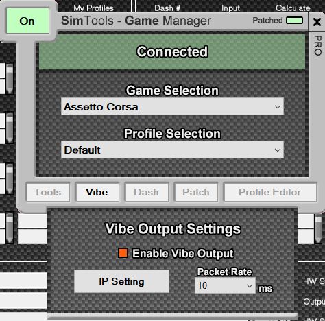

    have you enabled vibe in game manager ?

    Yeah, I think I had to do that for the game list in GameVibe to even populate. Wondering if I need to reinstall a plugin or something.

    Ah, that's interesting. The values only fill out when the game is active. They showed the correct names when the game launched, but weirdly they went back to "GameVibe1" and so on when I closed Assetto Corsa. Makes it a bit weird to try to get settings worked out before you play though.

    Well, it kind of works, but it's a bit of a hassle. If I have Content Manager open (my Assetto Corsa launcher), the names show up correctly, but when I'm trying to run tuning center the values zero out as soon as I close a race, which makes it tough to adjust them. Just seems like it doesn't work the same way that I thought I remembered the axis setup working for SimTools in general. I don't necessarily have extra screens to play with at my sim rig station, and all my stuff is VR so it's hard to play and look at a menu at the same time.
    Mostly just seems odd, that's all. It works fine, just fiddly to set up.
