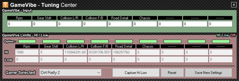

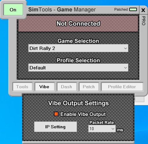

    Finally got to work on a new simulator, and im testing game vibe with 4 transducers first. I did some testing in Dirt, and all the data is recording live in the tuning center, but nothing out on the transducers. When i try in test, they all work fine. I checked the boxes with Vibe on the Game Manager, and checked the IP. Guess there is nothing wrong with the patch or the game when data input is showing on Vibe ?

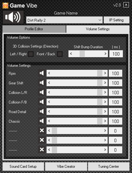

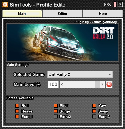

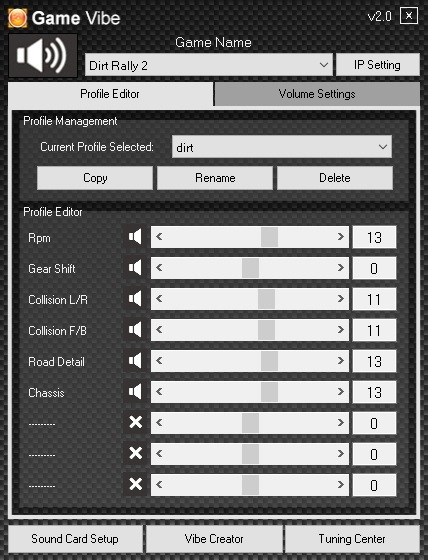

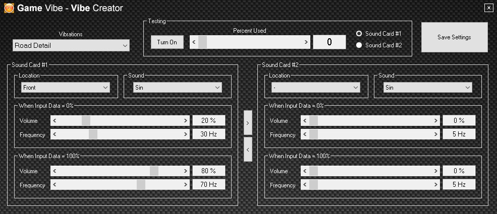

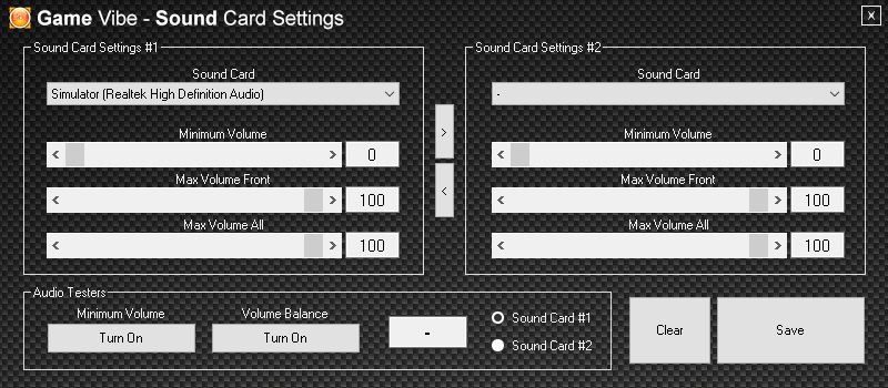

    Thanks for reply :) Game manager and Game vibe ?
    Uten navn1.jpg Uten navn2.jpg Uten navn3.jpg Uten navn4.jpg Uten navn5.jpg Uten navn6.jpg Uten navn7.jpg

    Just checking, does game vibe have a dedicated sound device, as it looks to be using onboard Realtek?

    Yes, I have the Realtek sound card dedicated to game vibe, and another one for main sound :)

    When I use the Turn On testing everything works perfect.. and when i run Dirt in windowed mode, I can see the live data coming from dirt to the Tuning Center. So it seems to work from Dirt2 -> Game Manager -> Game Vibe. and from Game Vibe -> sound card -> amp. Just not all together when i playo_O

    How do i check the version ? Do the Game Engine need to run for game vibe to work ? Yeah, followed the manual. Thanks for the tips :)

    It was 2.5.1, but I removed it and reinstalled. works now! Thanks! :D
