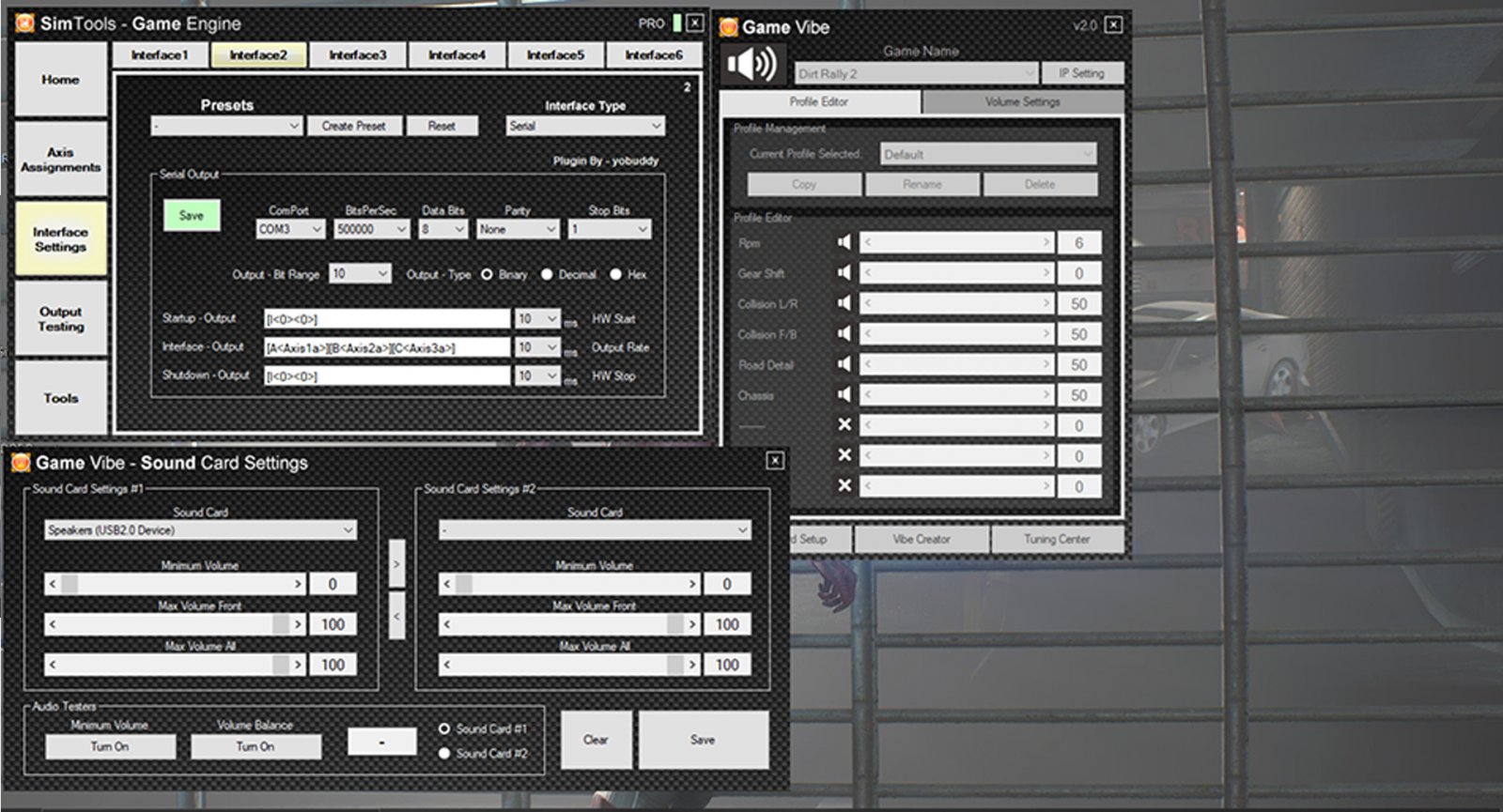

    Hi guys I am new to this sim racing so please bear with me I bought a SRS shakekit and was not very happy with it so i decided to go the DIY Route and bought the parts needed and it works fine in SimRacingStudio app but when i use the Simtools GameVibe it works in test mode but not in the game any suggestion. the SimTools app is green so I presume it has detected it but not setup correctly, I have tried YouTube but no setup or troubleshooting help there, Thanks for any help.

    Can we see some screenshots of your simtools settings including game vibe tuning centre please @philip bristow

    Here are the images i hope they help, thank you.

    your hi and low values in tuning centre are zero, your motion is all working ok yeah ?
    just start with whats below and that should give you something then dail in from there.

    No the motion is a nightmare i do not understand it at all with the Simtools software But with SimRacingStudio it works straight away it is a pity there is no discord as I cant believe that I am the only new person who is having all these issues.
