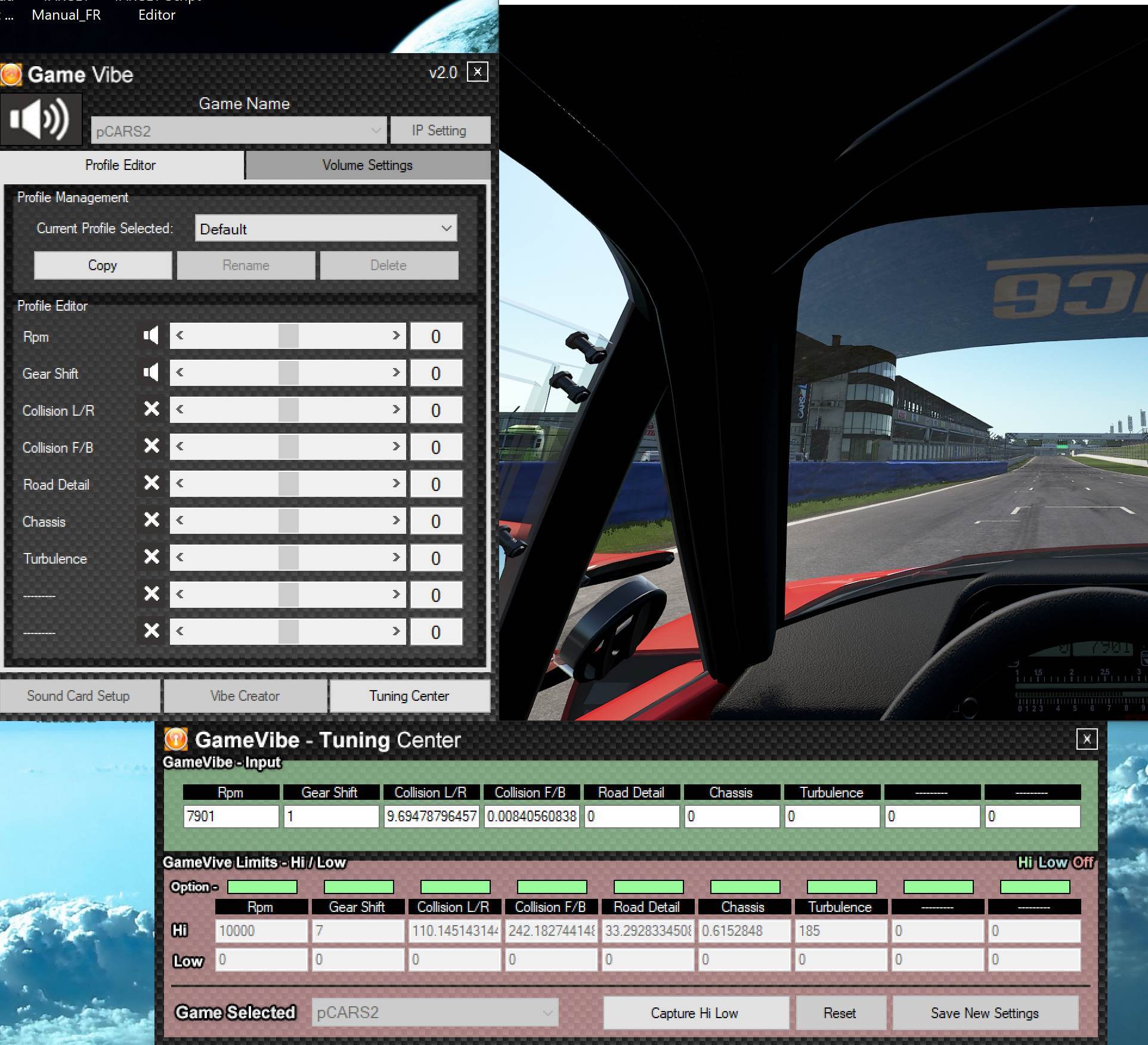

    I have a problem with game vibe
    I chose two effects gear shift and RPM
    WITH project car2 the gear shift effect works perfectly
    the RPM or has stopped the effect is at maximum and decreases when the engine goes up
    what’s going on?
    thanks

    Could you please post pictures of all of your settings.

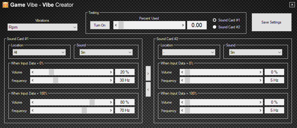

    Click on "Vibe Creator" then select RPM.
    Then click "Turn On" under testing and slide the percent used slider back and forth.
    Feel free to adjust the "When input = 0%" settings, and also the "When input = 100%" settings to get it to work how you want.
    Here is what mine looks like:
    Hope this helps.

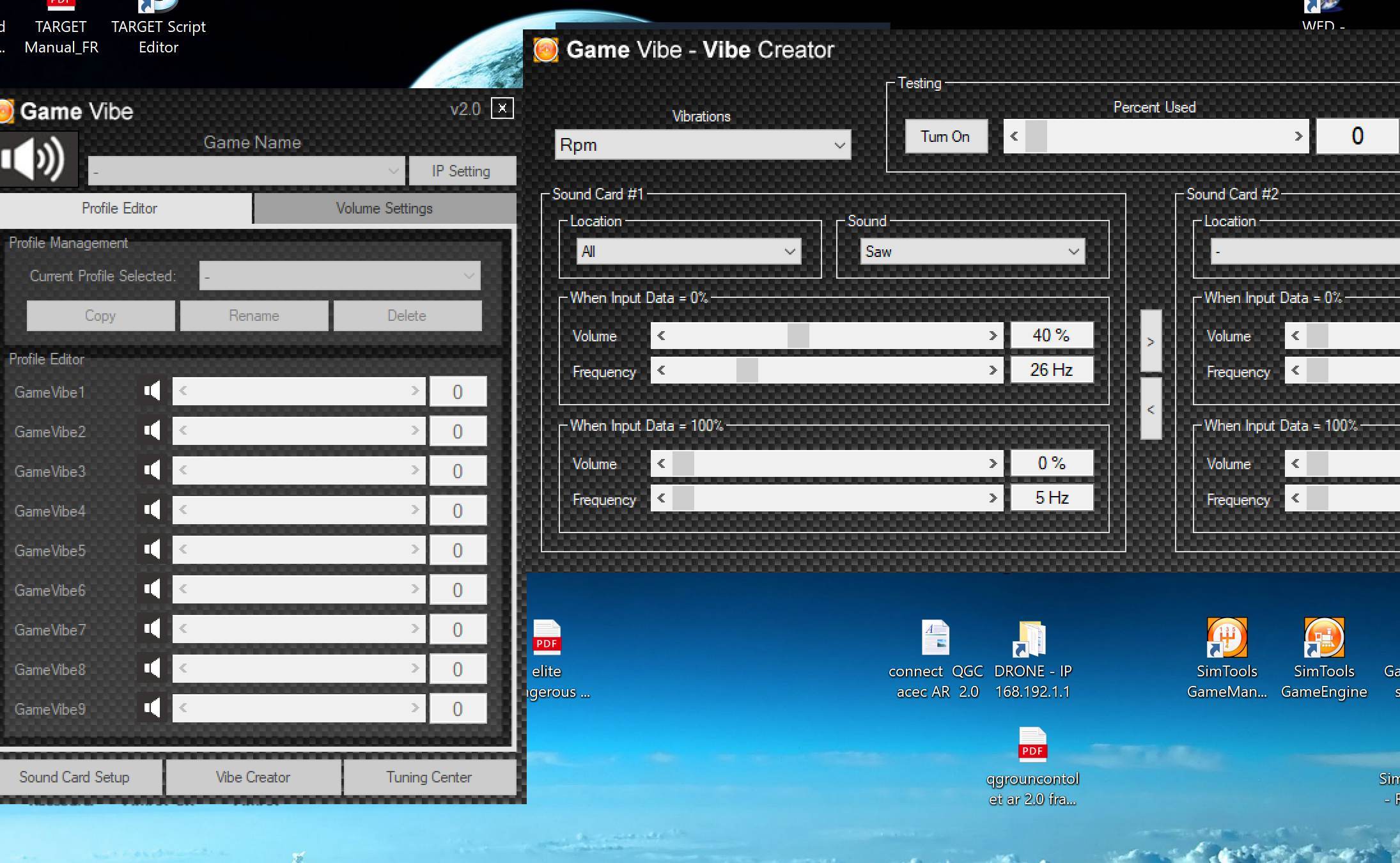

    here you can see[​IMG] [​IMG]

    the solution does not work
    here are my settings above

    You have 0% set in 'When Input Data = 100%' in Vibe Creator, when it should be something like 80-100% volume.

    @noorbeast is correct.
    You have it set currently to play at 40% volume when input is at 0%, and go down to 0% volume when input is at 100%.
    Take a peek at the two bottom right sliders.
    Adjust those and you will be good to go!
