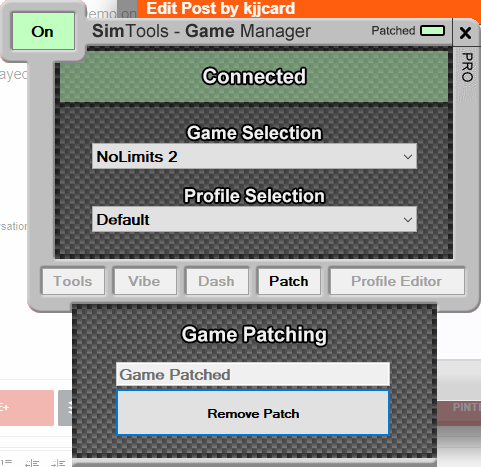

    Hello.
    I have something to ask.
    My license is Pro.
    I now want to run the NoLimits 2 Roller Coaster Simulation Demo on my machine.
    So I downloaded the plugin and put it into the updater.
    Then I turned on GameManager, hit Patch, and then hit PatchGame.
    The message to find the game path is not displayed.
    That's right. - See photo
    What should I do in this situation?
    Is that because the game is a demo?
    The LFS game proved to work well.
    Thank you.
    This is Google translation.

    The demo doesn't output telemetry I believe.
    And with the full version you need to add "--Telemetry" to the startup command.

    In the image it looks like it is already patched.
    Nolimits2 demo does not work. The full version yes.

    I bought a genuine product - I applied a ticketing. But still the motion platform does not move .... Is there any solution for this?
  6. yobuddy
    51,383Coins
    +5,202 / 19 / -0
    @paulopsx2 is trying to help you in the other thread.
    respond to his PM @kjjcard.
    I'm sure its something simple buddy.
