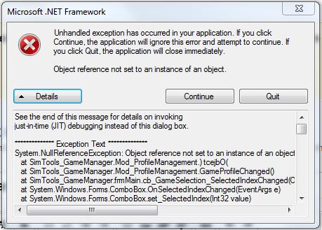

    Norton quarantined Game Manager. I restored and excluded from future scans. Now I get a dot net framework error upon launch. Unhandled exception. Object reference not set to an instance of an object. I've attached a pic of the error.
    Help Please.

    Delete the 2 folders found at:
    "C:\Users\(your user folder)\AppData\Local\SimTools\GameManager\GameProfiles"
    Folders are "LastUsed" and "Profiles".
    This occasional problem is fixed in v2.2.
