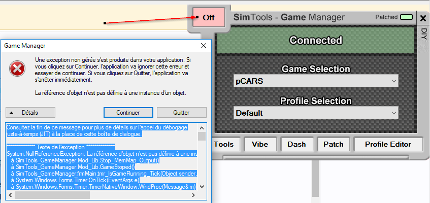

    GameManager is crashing when I click on ON, on the top left corner :
    Any idea ? Any old remaining component I should clean ?

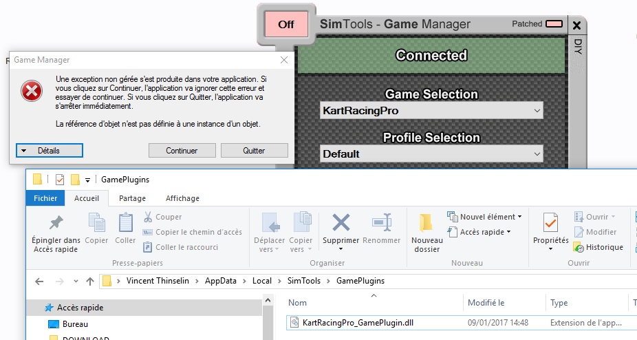

    I started to isolate the culprit by moving all plugins as you said and add them back one by one. The problem is more frequent as soon as I add the KartRacingPro plugin.

    KRP is defenetly one to look into :
