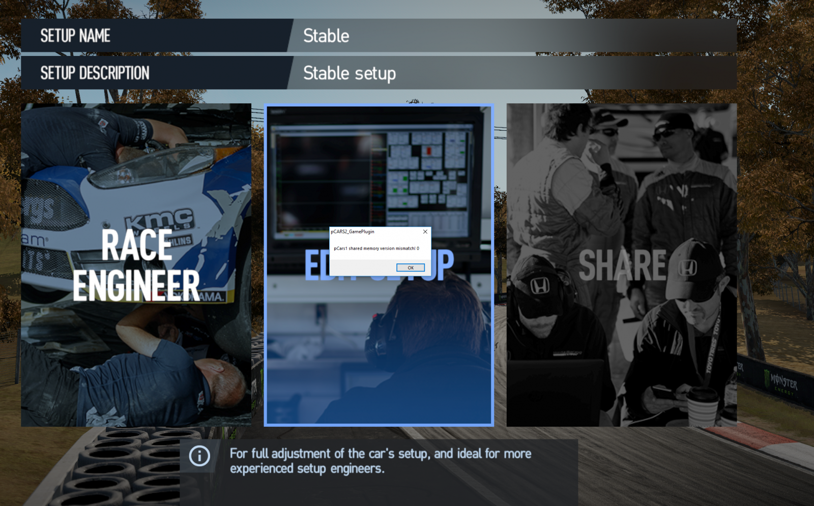

    Hey guys, after some help please. I have a built a 2dof using some old prosimu scn6 actuators and control unit. i loaded the lastest version of simtools on, and the lastest plugin, for project cars 2.0.5.4 i think. everything works great but after a race it would stop and i get this message.
    I only Play pcars2 so im not sure if it will happen to others, im running simtools on anoither machine with plug in 2.0.40 and it works flawlessly.
    I have my game outputting pcars2 data as i also run sim commander for tactile.
    to get it working again all i have to do is close off game engine and game manager and she works again.
    Im on a i5 6600k with a 1080ti 16gb ram.
    also with my other rig, it asked to limit motion to when the car is moving, but this plugin doesnt?

    Try switching the Shared Memory option via the Options screen, under Options→System→Shared Memory→ to the opposite option, likely Project CARS 1 if you have it set to Project CARS 2.
    As an aside the Pro version of SimTools uses Game Vibe for transducer support, you may want to try it at some stage.
