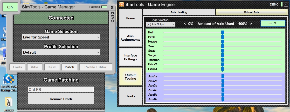

    I have LFS and Sim Tools 2.1, and configured Axis Assignment and Interface Settings,
    then I patched LFS through game manager

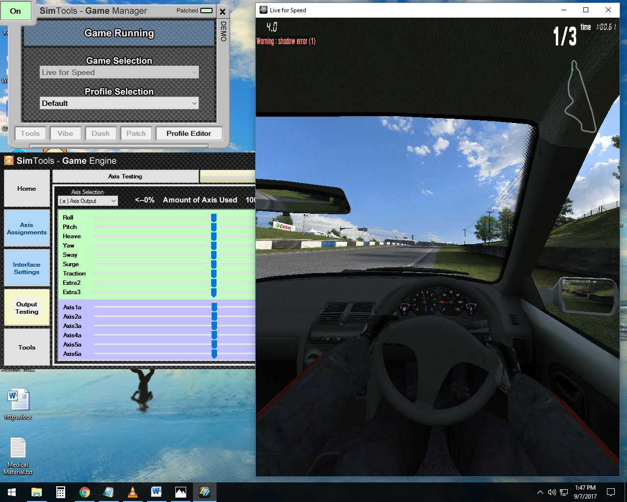

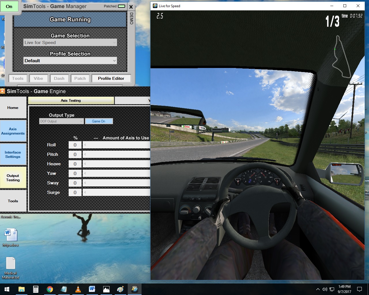

    but playing the game makes no changes to the sliders in Output Testing -> Virtual Axis,
    What should I do next?

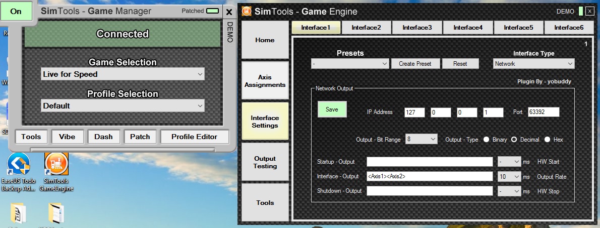

    Interface Output must be <Axis1a><Axis2a>

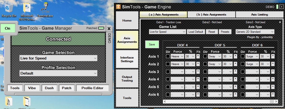

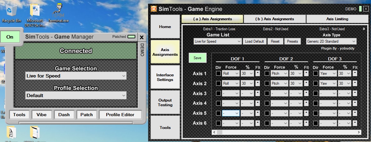

    Also, output testing uses the "Default" axis assignment.
    The "Default" axis assignment should be setup, as it gets copied for all new game plugins installed.

    Thank you very much, it starts working after writing <Axis1a><Axis2a>
