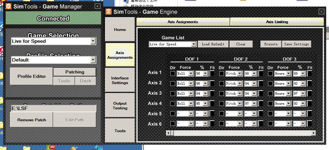

    Hello everyone: I want to help!
    This week My downloaded "SimTools"
    Run "LiveForSpeed" does not change, and is 0.
    My poor English, the following is the picture
    To change the "cfg.txt" files? How to change?
    :sos

    Hi 741852cp
    Can you please post a screenshot of the axis assignment page and the interface settings page?

  3. yobuddy
    51,377Coins
    +5,202 / 19 / -0
    If you have no assigned output then the engine realizes it does not have to process anything and you will get no output.
    As Thomas suggested, please post a screen shot of your axis assignments and the interface settings page.

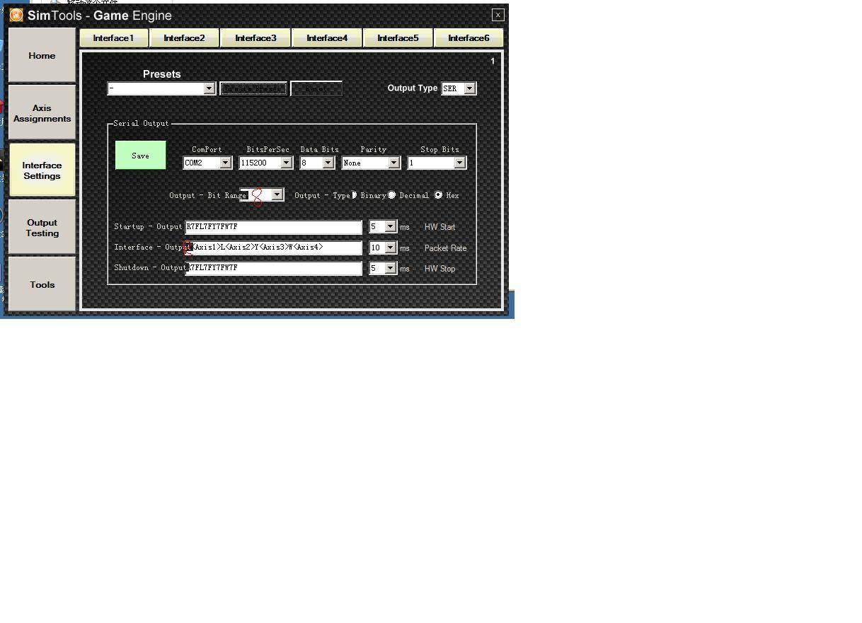

  5. 741852cp
    741852cp Member
    Nov 21, 2010
    62
    china
    106Coins
    +9 / 0 / -0
    2DOF, AC motor
    Grateful to you quick guidance.
    My setup diagram here:

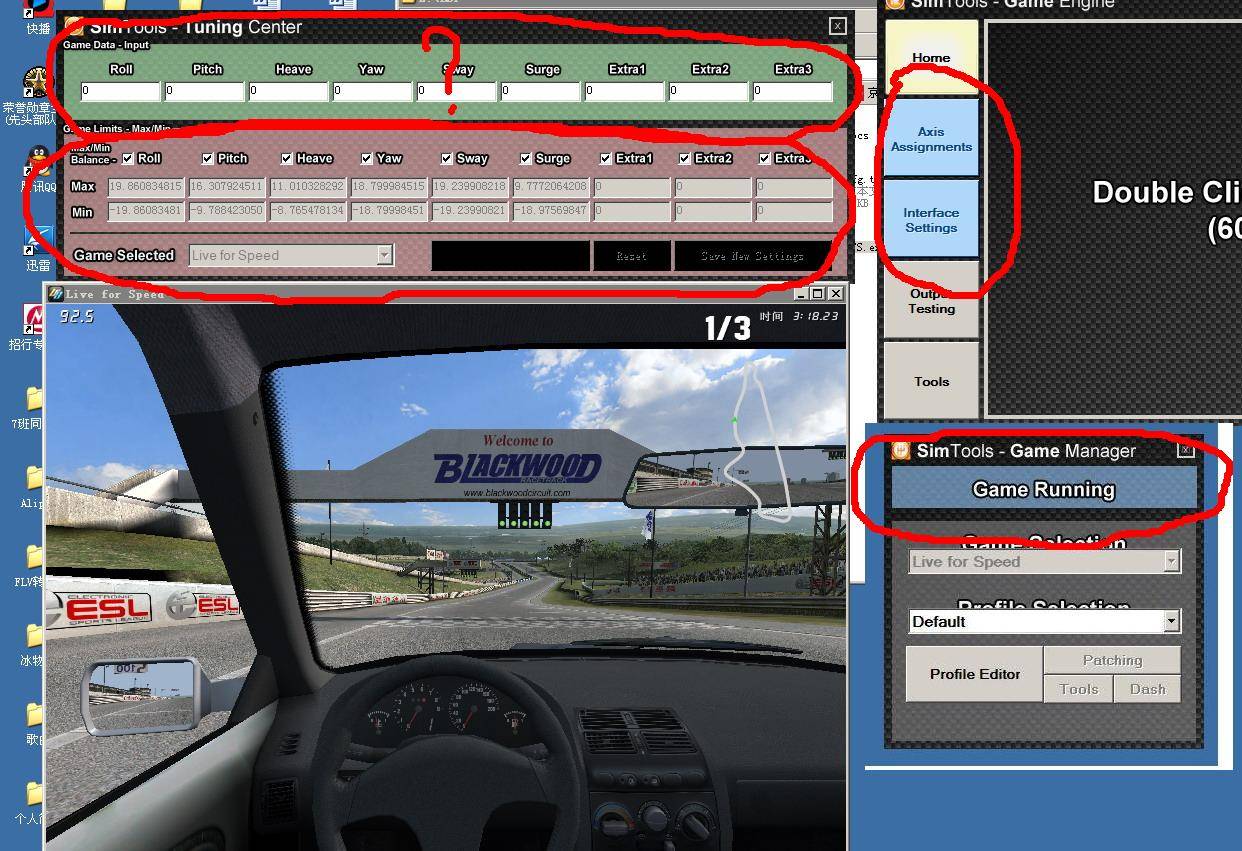

    I have a new problem:
    Do not say, my English is poor.
    Video.
    Ooops, the shooting took anti-cell phone.

  13. eaorobbie
    20,491Coins
    +1,687 / 23 / -2
    At a guess increase your MIN MAX in the tuning centre, LFS Plugin is very stable. Please make sure there is no xsim plugin sending data too, has been an issue before.
    A screenshot of the Tuning Centre and Game Engine Axis setings,
    Plus a description as @RaceRay has requested should get this solve promptly.

  16. 741852cp
    741852cp Member
    Nov 21, 2010
    62
    china
    106Coins
    +9 / 0 / -0
    2DOF, AC motor
    Hello everyone
    I tested the, IL2, DIRT3, two games
    IL2. Running normal, stable perfect.
    lfs, Drit3 + - Numerical Rapidly beating Unstable output
    lfs Settings Figure

  19. yobuddy
    51,377Coins
    +5,202 / 19 / -0
    You should be using Sway and Surge for the racing games.
    Try Sway at 60% and Surge at 60% with all other profile settings at default.
    (profile editor all at zeros)
    In other words, IL2 will work with roll and pitch only.
    the rest of the games you listed require Sway and Surge.
    Looks like you fixed the font problem you were having.
    Could you please post what was wrong?
    Thanks!

    The new findings(LFS)
    Arithmetic operation resalted in an overflow After
    Virtual Axis Skip to both ends of the value
    Video
