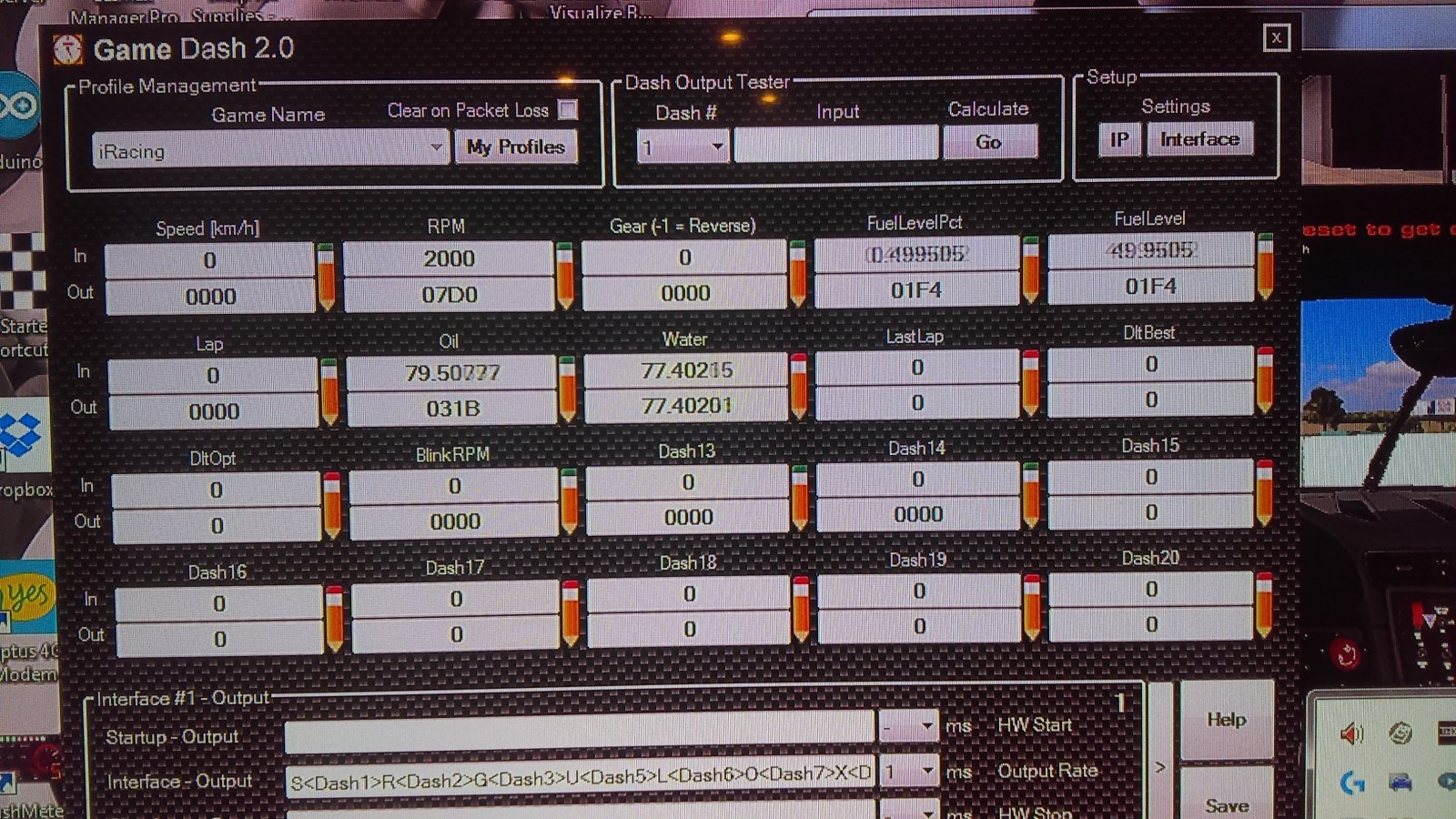

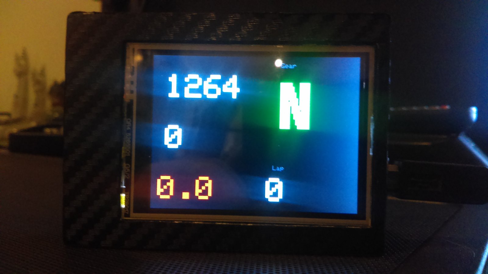

    ok so the beeping has stopped thanks mate now i have this screen up but nothing changes.. sim dash is outputing but nothings changing on the screen here are so pics

    i just checked and the water is set for dash 13 but it outputing on 8

    the beeping stopped and i have all thew info on screen sim dash is outputing but nothing moves on the dash

    yeah i fixed the beeping issue i had " instead of * beeping stopped striaght away when i changed that...when you say edit commands what do you mean brother.. ive tried 3 diffrent boards ive played the bits per second if i have it on 57600 i have all info on screen but its frozen if i go up to the 115200 theres numbers all over the place but they change and as i drive more info pops up same if i go higher with the bits if i go under 57600 nothing comes on screen but once on track bit by bit things pop up all in the wrong placse and wrong valve to sim dash my interface output is set to 1ms ive gone up to 30 but nothing changed im looking to do a course on arduino to make this easier for me ive spent 2 days on this now

    You need to make sure that the bits per second of the outgoing interface matches the bits per second of the arduino its connecting to.
    You should be able to peek in the sketch for the ard to see what speed it wants to communicate at.
