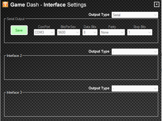

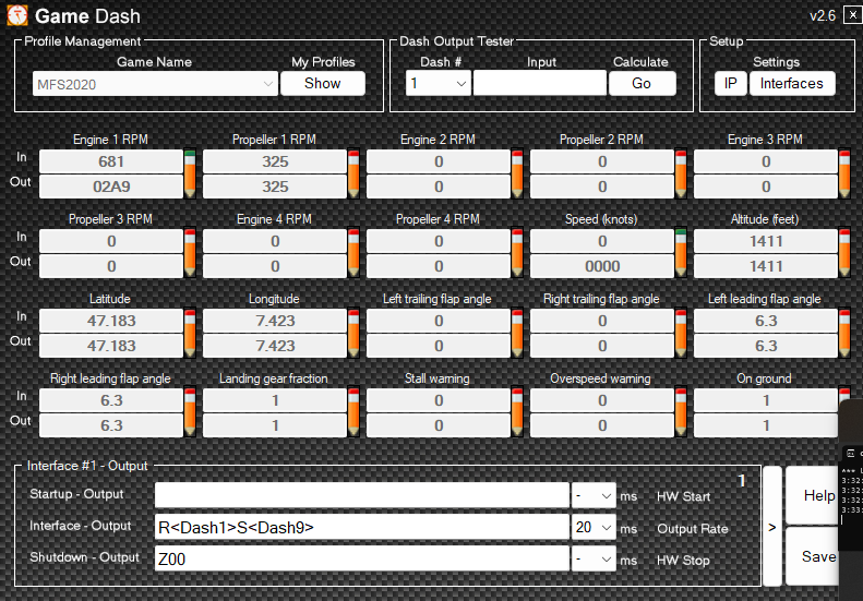

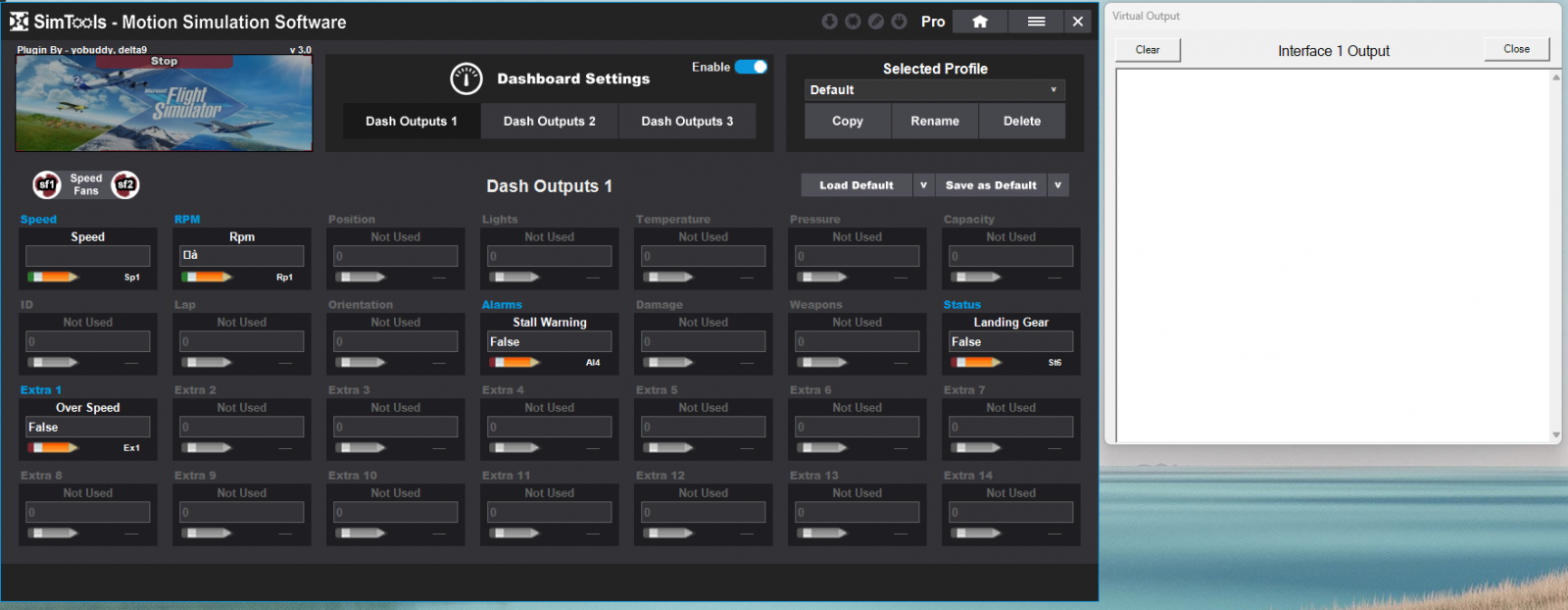

    Hi folks,
    I thought this should be simple but I have been battling with it for days, so please help!
    I am using Game Dash in v.2.6 with the MSFS plugin.
    I am trying to get data into my Arduino Uno but try what I might seem unable to do so.
    I am sending Dash1 and Dash9 info to the Arduino in Hex and (think) I am converting it back on the Arduino side using such examples as are available. My settings look like this (you can see the values are being generated when MSFS is running):

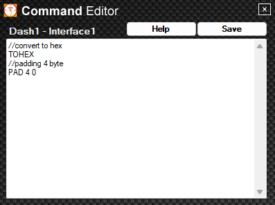

    I have the hex code set as follows:
    The interface setting is as follows:
    My code on the Arduino loads properly but I can not see any printed output on the serial monitor. This is the code below:
    Any help greatly appreciated!

    I have based my code on various examples provided and it should work. DCS and MSFS2020 both show their data being received but that is not being sent on to the Arduino. I uninstalled V3 and V2.6 in total and installed V2.6 again and set everything up again from scratch but still nothing. Please try the code I provided and see if it works for you? Ihave also tested everything on a different machine and same effect, so not machine related. Also not serial port related as far as I can see because I can send code strings manually and the sketch will interpret it correctly in the Arduino serial monitor. It just never sees any data coming through. I have double checked that output rates match and baud rates match so should not be that either.

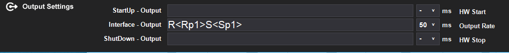

    First, instead of ToHex , let's use ToBin, this way we get 1 char for any number between 0 and 255.
    (With V3, we can do all this with one command, GetBits(Min value, Max value, bit range, output type)
    Please add this for both Rpm and Speed edits. (instead of the tohex and pad edits.)
    GetBits 0 65535 16 b
    This will take any input number between 0 65535 and outputs is 16bit binary.
    For output let's just put
    R<Rp1><Sp1> (the inputs will always be 2 bytes, Sxyab 5-bytes total)
    (where <Rp1> = xy and <Sp1> = ab)
    And in your app I believe you can simply go:

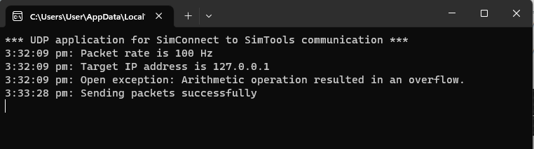

    Today I reloaded V3 and managed to install the DCS and MSFS2020 plugins, but whereas before I was getting input from MSFS, this time it did not even do that. I will try v.2.6 again tomorrow but right now its late. I will also re-install legacy versions of simconnect (not that I had removed them) as that had previously been the reason MSFS was not working.
    To your comment that a math overflow is happening that could very well be but why?

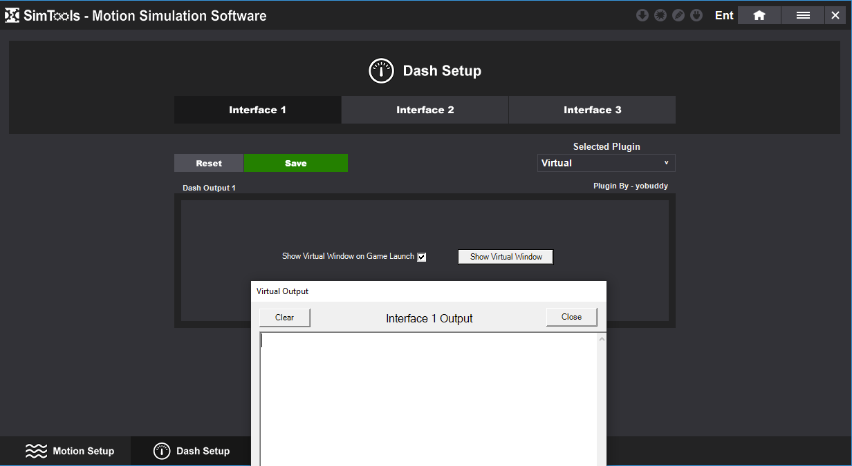

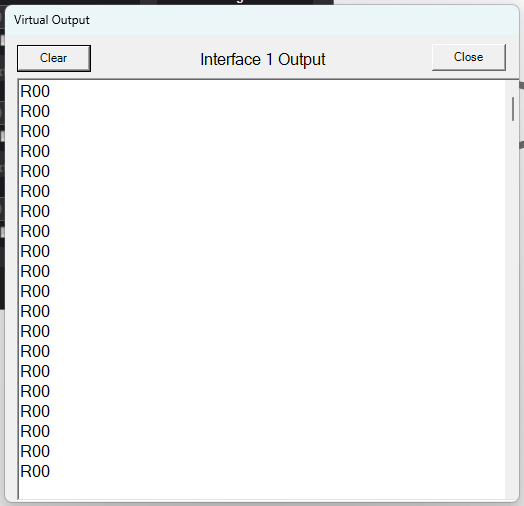

    Ok @yobuddy , so before going to the sketch I ran into a few problems. First, double clicking on the MSFS banner to launch the game resulted in an unhandled exception - game not found. I managed to find your solution on the forums where you stated :"You may find that some game plugins do not set a launch path for a given game plugin, or the path is setup for a different version of the game than what you’re running. To update a launch path for a game plugin, simply drag and drop the games exe or shortcut on the banner for the given game plugin."
    Ok, then it ran. Using virtual output I could see that only RPM was creating an output and the Speed had a pretty weird look first symbol which never changed. There was no output at all going to the virtual interface:
    These were the settings used:
    .. ideas?

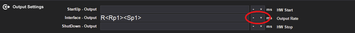

  13. yobuddy
    5,375
    50,302Coins
    +5,149 / 18 / -0

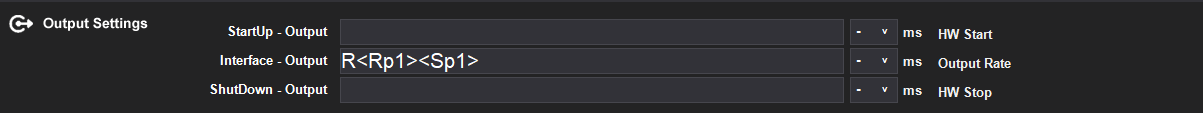

    There is no output rate selected yet, for the virtual output plugin, I suggest setting output rate to 50.

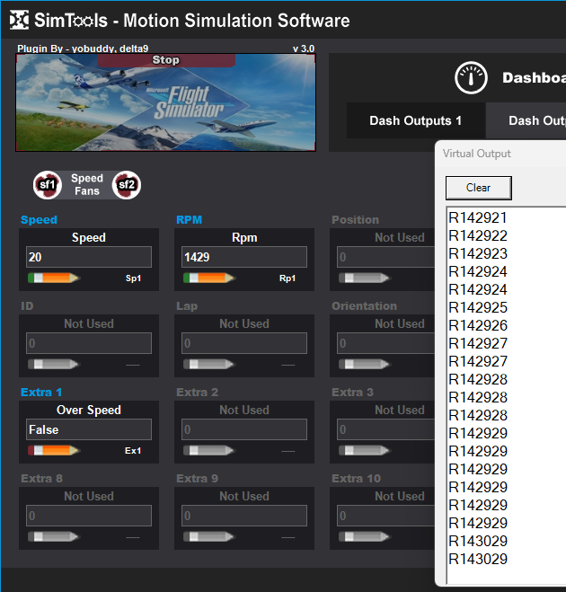

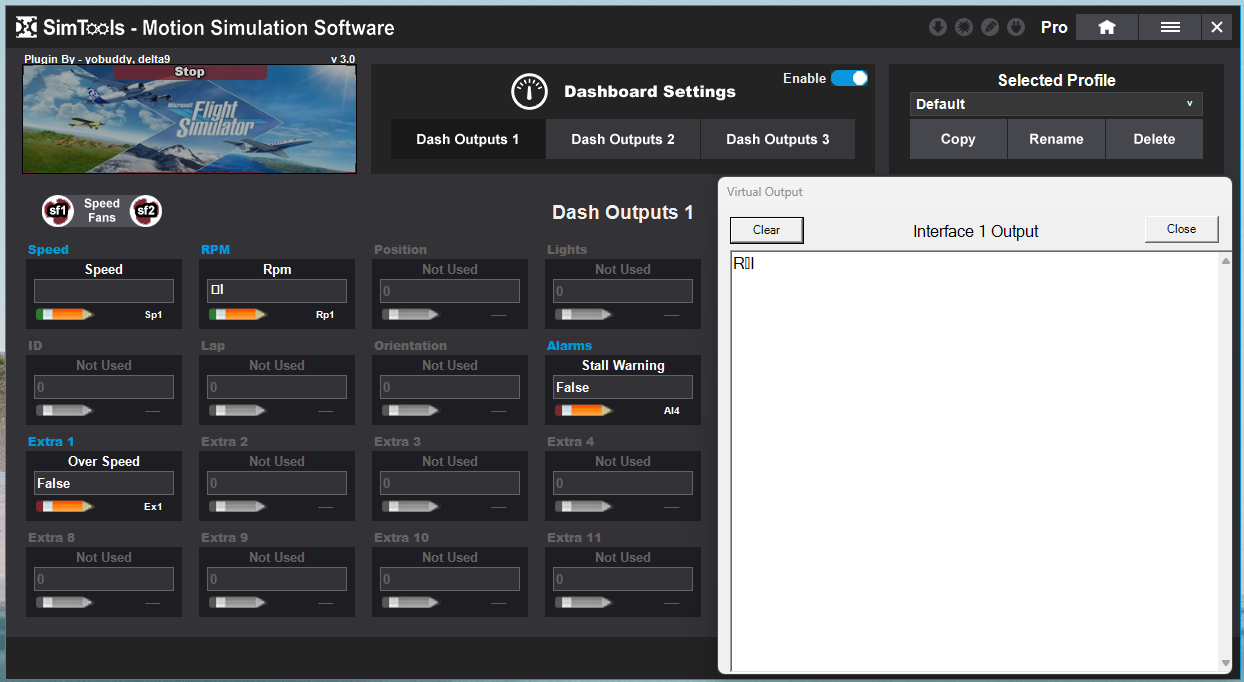

    Thanks @yobuddy. Missed it that time. Ok, done and this is the result:
    So the RPM is coming through with a weird symbol, nothing from Speed, but that is something to do with the plugin I suspect?

    Change the 'edit' (gitbits command) temporarily for both Speed and Rpm, just to see you are getting data for both.
    From GetBits 0 65535 16 b - to GetBits 0 65535 16 d (change the b at the end to a d)
    It's the ascii chars the arduino uses to store values, I sent you the chart in IM.
    It's from the GetBits command.
    You will always get 2 bits for Rpm and speed when asking for 16bit output (from the GetBits command).

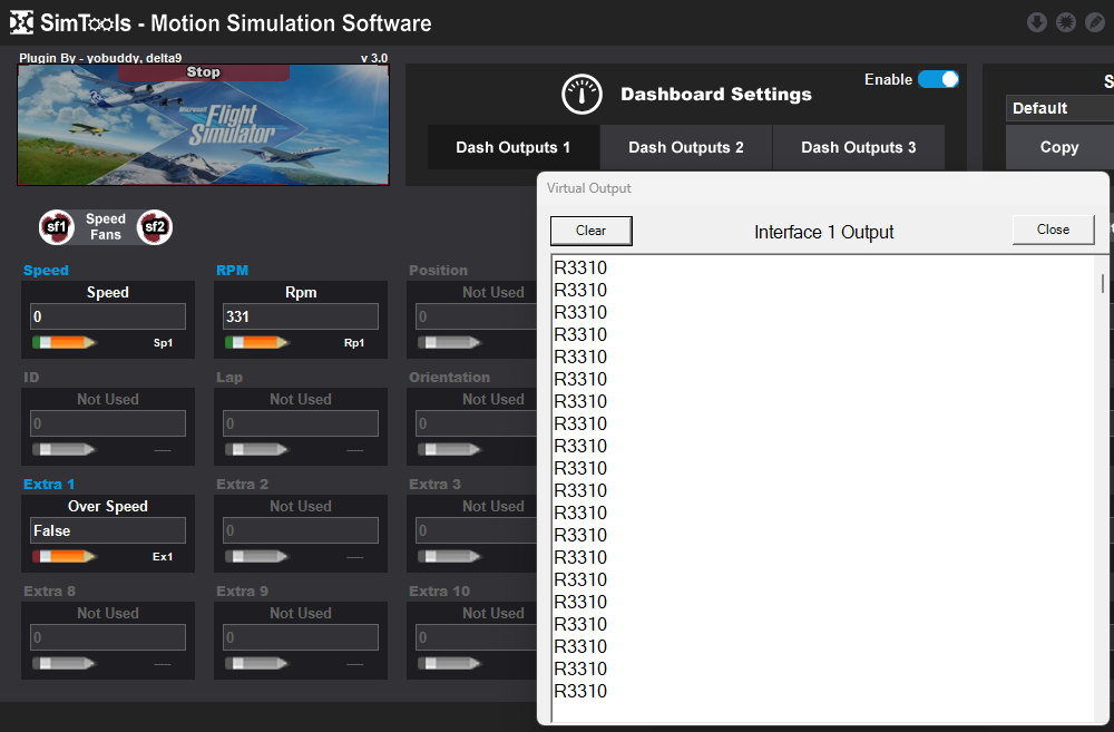

    Done. I can see that as soon as I launch the game it starts spitting out the following data:
    Is that usual? Could it be the cause of the math overflow message I get when using V2.6?
    Once the sim is running I get the following (aircraft stationary):
    So I can see that the first three digits there are for the RPM, and 0 is at the end for Speed.
    When the aircraft is moving the airspeed is now working and coming alive:
    So here you have RPM at 1429 and Speed at 21 so output = R142921
    Where do we go from here?
    Ok thanks!

    Some progress..
    I changed the output back to my original:
    and put the following output rules into both RPM and Speed:
    Running my original Arduino sketch but with an LED activation added I think I see something happening.
    As I need the output for DCS and MSFS and the V.3 DCS plugin does not have Game Dash I now need to get this to work on V2.6
    But before I get there, let me first prove this configuration on the sim, that will be a big step if it works with MSFS.
